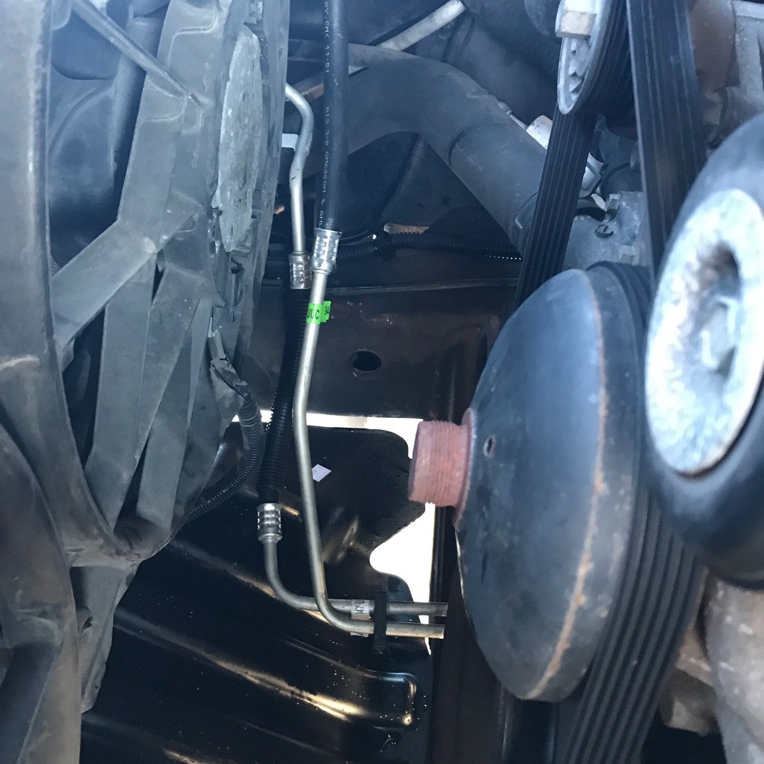

-Transmission oil cooler lines were poorly repaired (spliced) and leaking so new AC Delco lines installed.

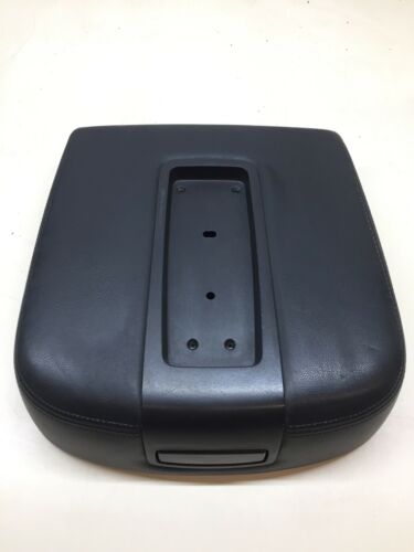

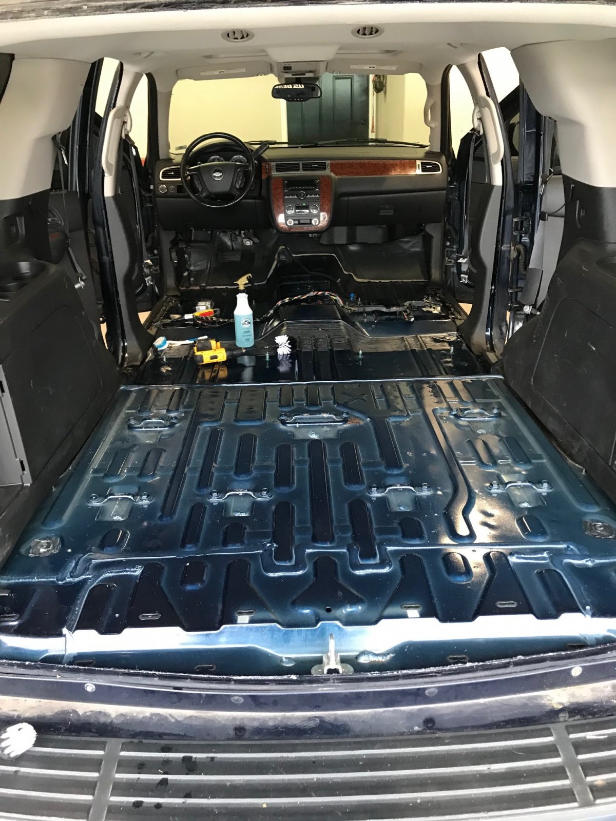

I am going to strip the interior this weekend down to the bare floor. Anything that is dirty will be cleaned, anything worn or broken will be replaced. The big items are the steering wheel (nasty), driver's seat bottom and console lid. New steering wheels are the #1 way to make a vehicle feel new from the driver's seat for me. I bought the durofoam seat bottom replacement, and the cloth cover itself is nice enough to re-use. A new console cover came with the truck, but the foam underlay is bad so I had to order another lid to work with. I also bought a trim stapler to do this job as well as re-attaching the seat back pocket.

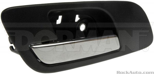

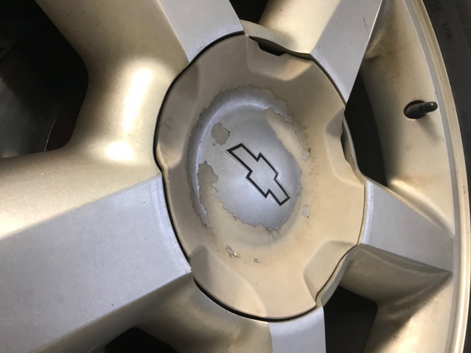

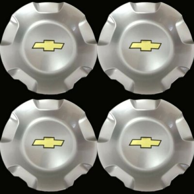

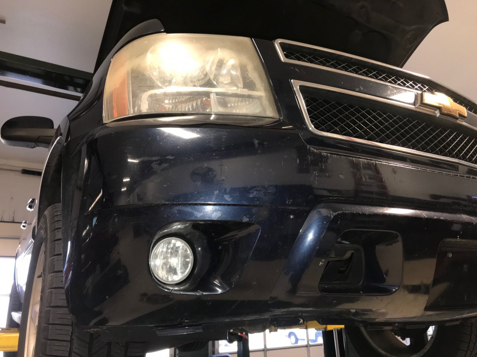

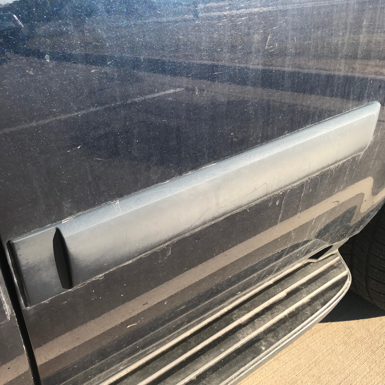

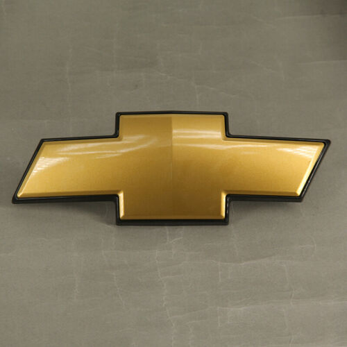

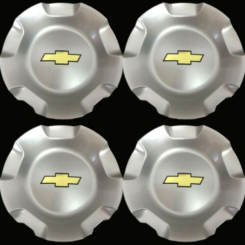

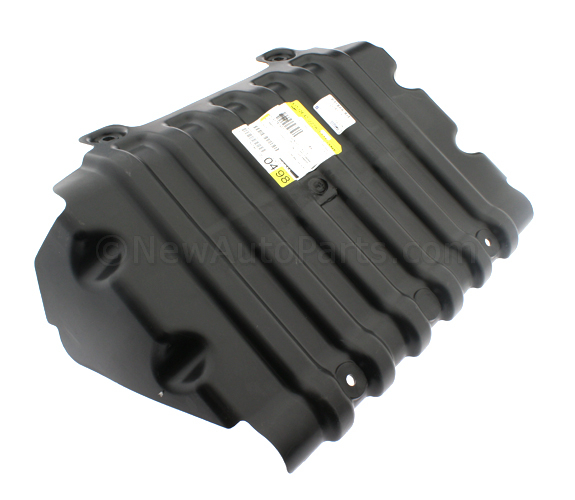

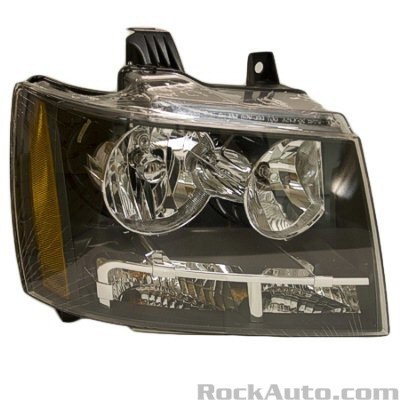

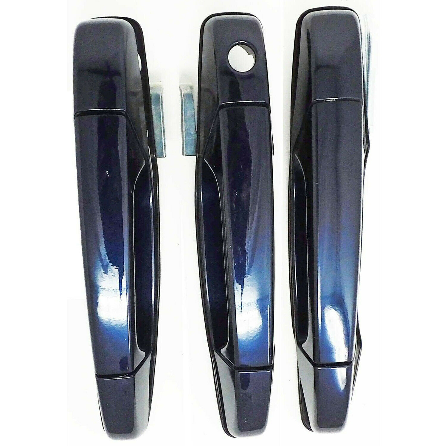

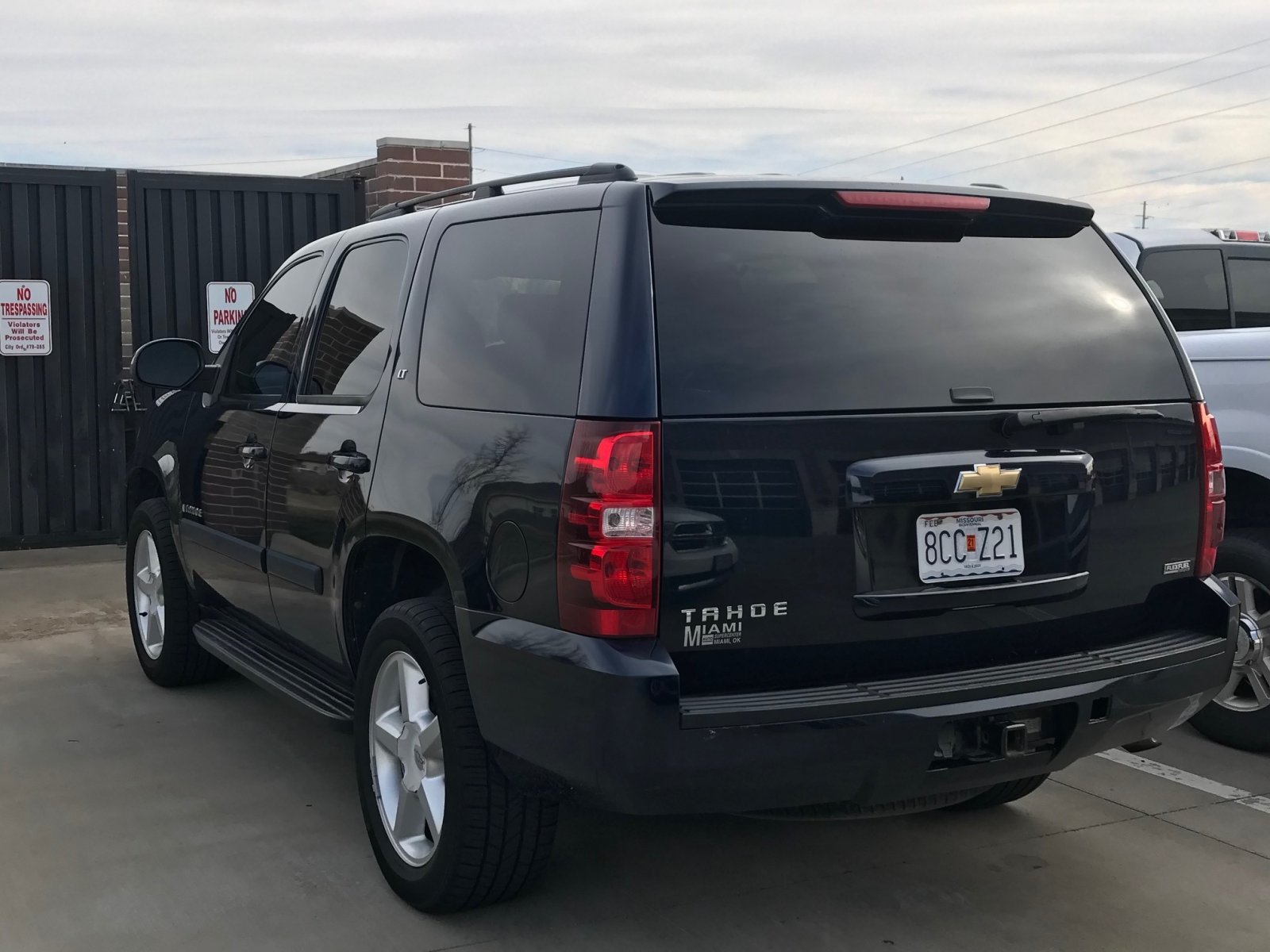

Here are some of the exterior parts I have ordered. The underbody shield is already on, the old one was shot. Short term; planning to remove the roof rack and door trim, replace headlights, door handles and front bowtie, plus a two-stage paint correction. The door handles are all peeling, but I found all four bermuda blue take-offs on Ebay. Oddly I also found a full set of bermuda blue door trim so I am considering replacing it maybe. Interestingly when I bought it I thought the wheels were roached. But when I got a closer look, they look like new painted silver reproduction 20's just with nasty old caps. So that's a bonus.

Is that the aluminum skid plate?

No, it's just thick plastic. It's not really a skid plate as much as a shield. I'm not sure about the z71 Tahoes but I think they're plastic too. They crack at the four bolts and mine was just barely hanging on.

I was thinking I had an aluminum one bookmarked but nope. The PPV and SSV models have 2 separate aluminum skid plates. They work great for catching and trapping 10mm sockets it hard to reach places.

Haha, if there is a place to drop something under a car and lose your mind for an hour looking for it, I will find it! I'll have to keep my eyes open for the aluminum plates.

Where did you get your steering wheel and Bowtie badge?

Thanks man! I have a dealer parts account and searched by VIN for the correct steering wheel, which is currently unavailable (black trim). But I know from experience that other years will work, so I found the part number for 2008 Z71 (silver trim) and ordered it. Around $175. The airbag emblem is from Ebay about $13.

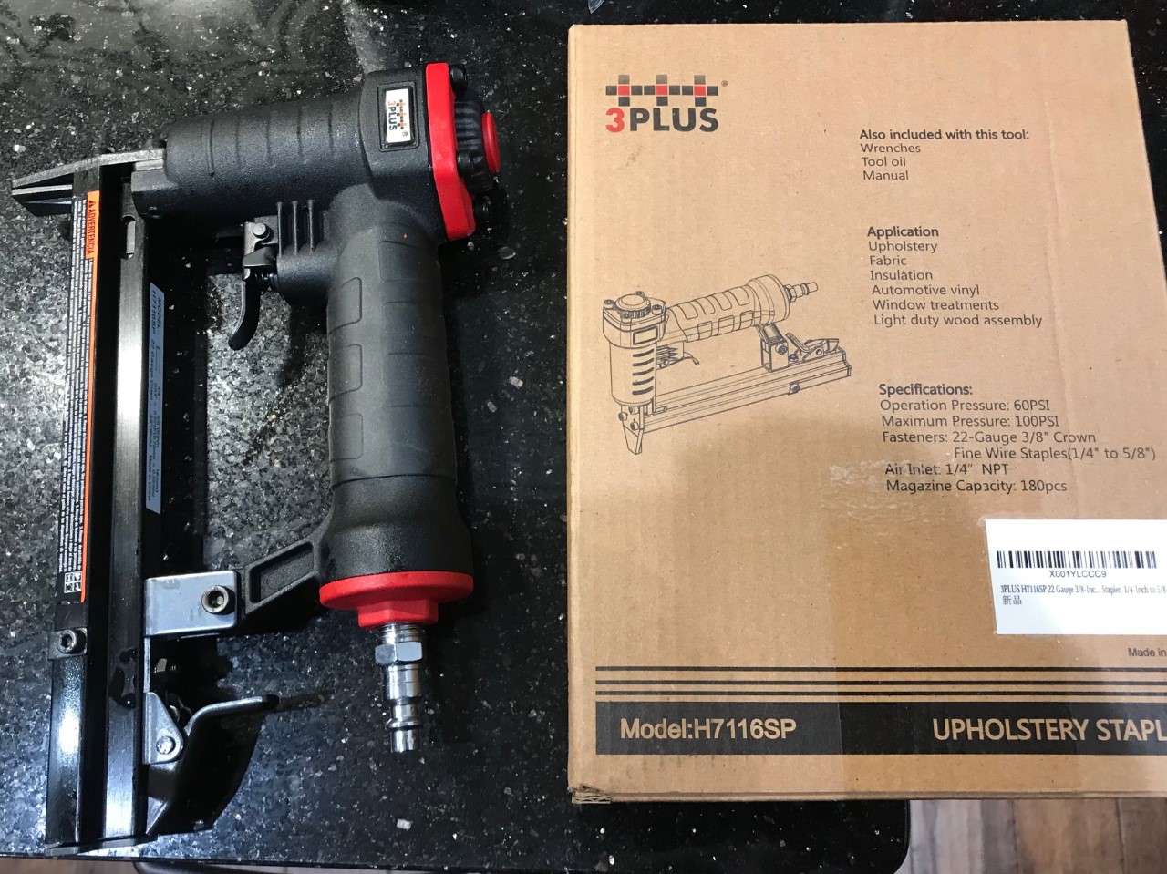

the upholstery stapler will make that job worlds easier. i tried using just my regular air stapler to redo the console cover in my wifes car and it was so damn terrible haha.
I've used hot glue held with clips and regular staples. Pita but it works.

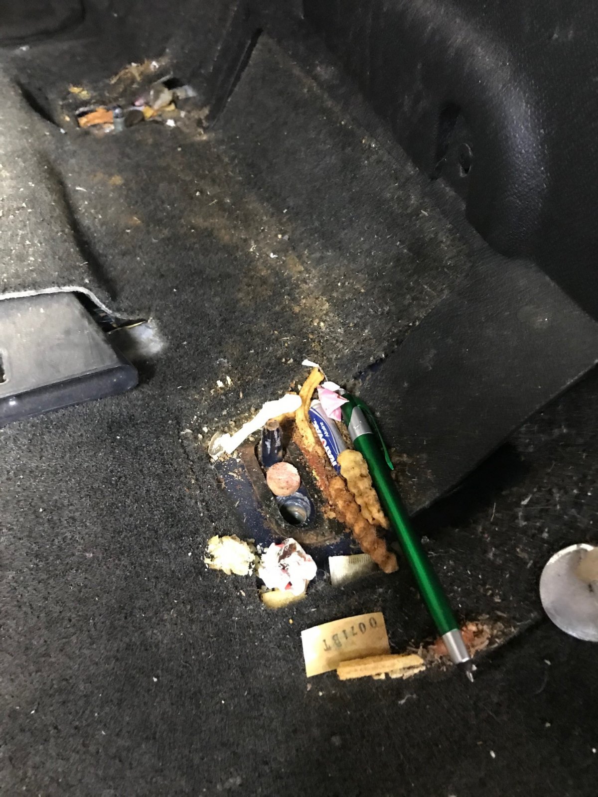

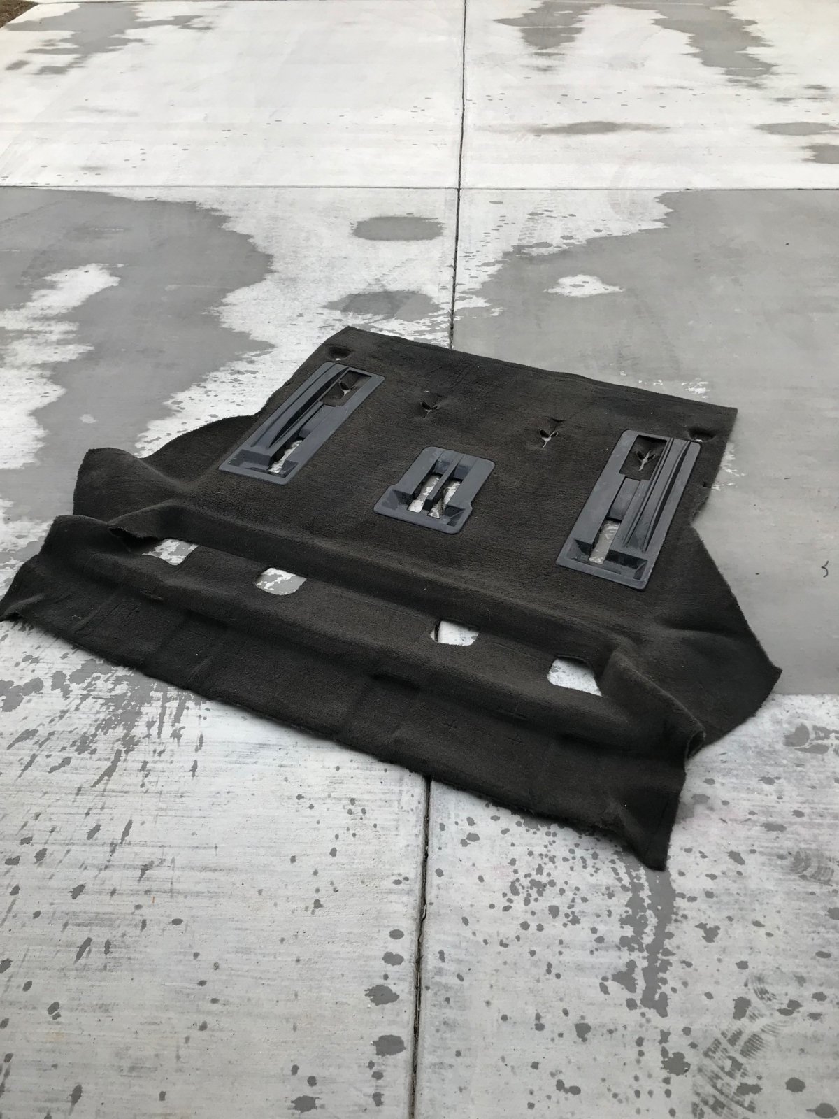

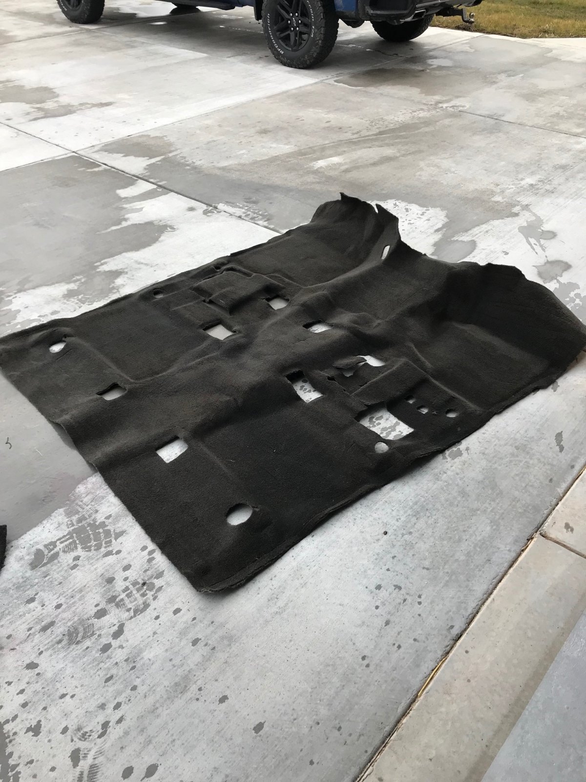

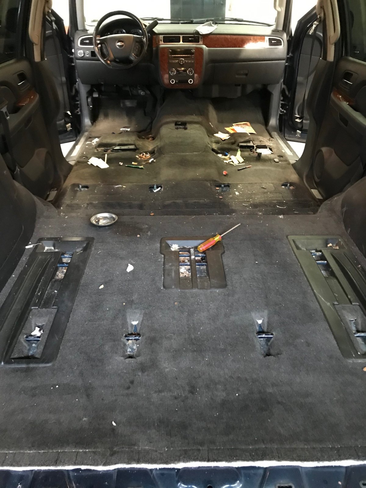

Had a big day on the interior. I was able to remove the seats, console and carpet and deep clean. It was NASTY. The carpet cleaned up well after a water-only power wash. The headliner also cleaned up well, I used a microfiber lightly sprayed with all purpose cleaner. It had more spots than I'm used to but it cleaned up 99% also, very happy. I cleaned and dressed the door seals, dash and interior panels and started on the door panels. I also got the seat bottom done, but I have some work to do on the back. I'll update with seat repairs next and I have a stack or parts including the new steering wheel that delivered yesterday. I bought it last Saturday, so after five days I'd say the previous owner would be shocked lol.
