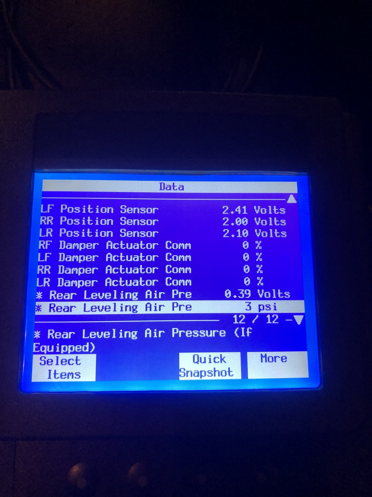

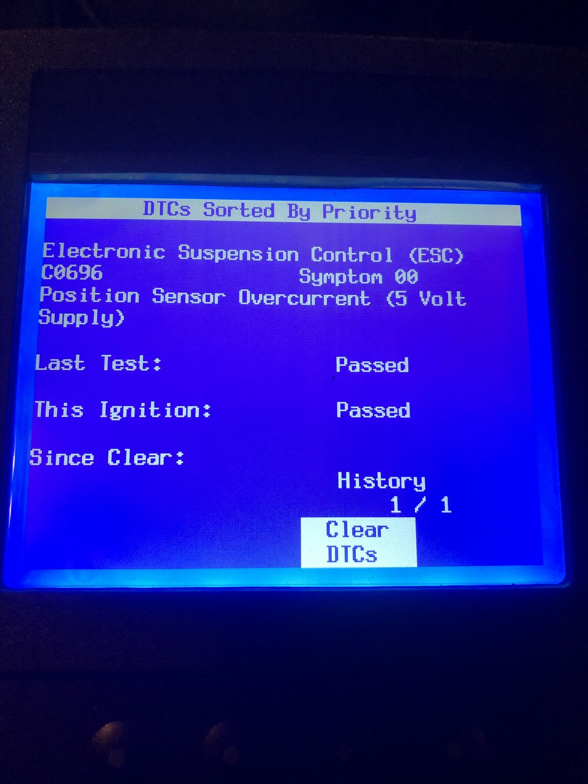

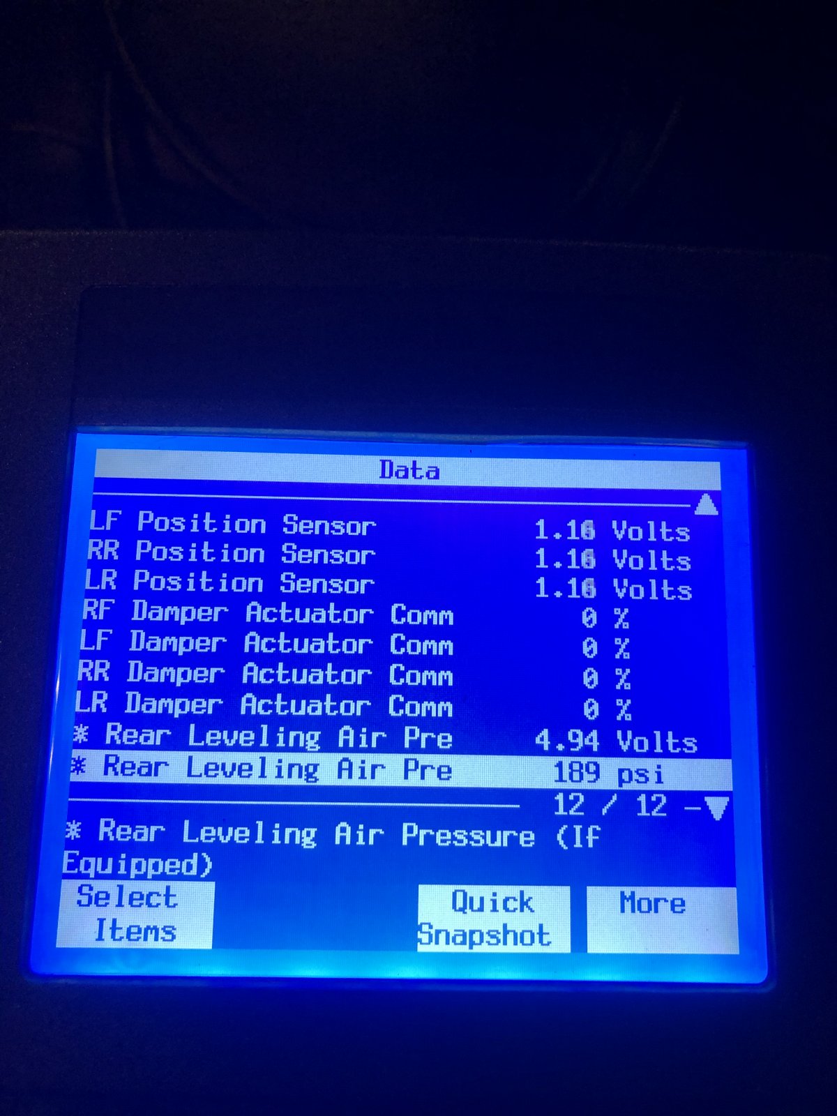

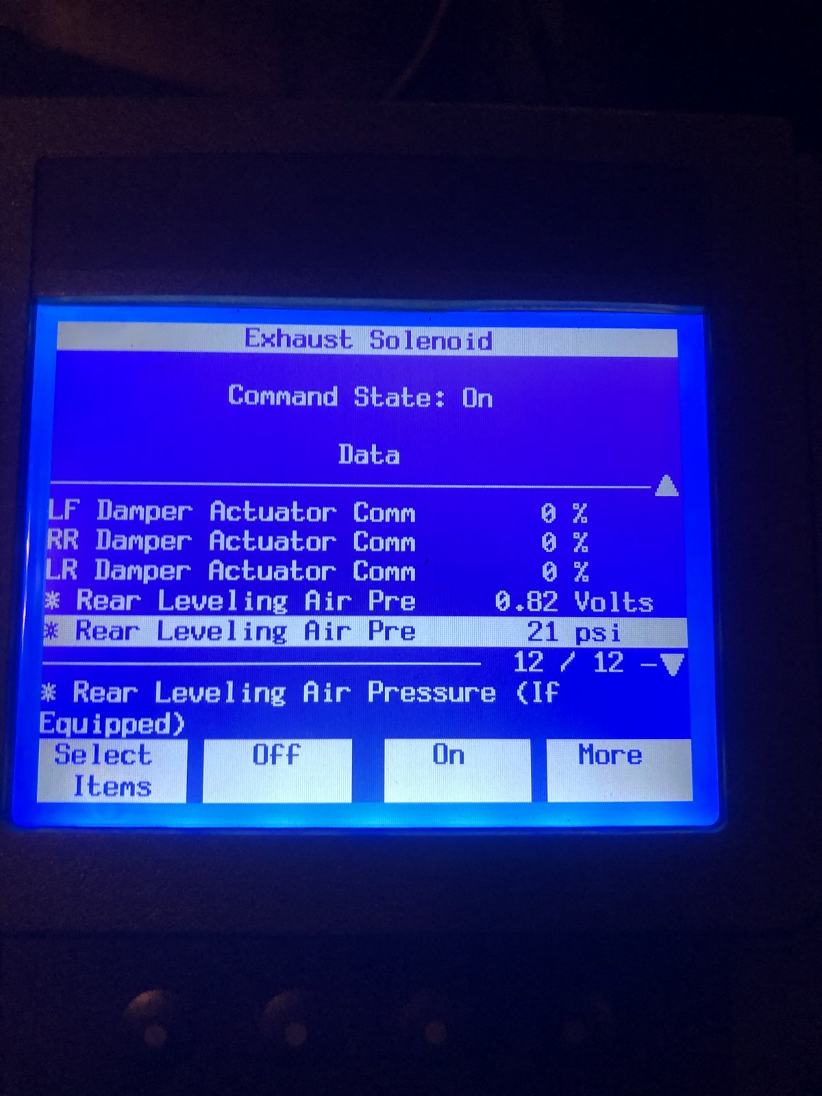

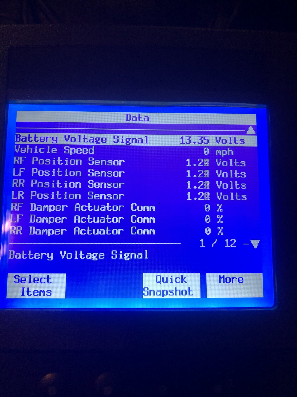

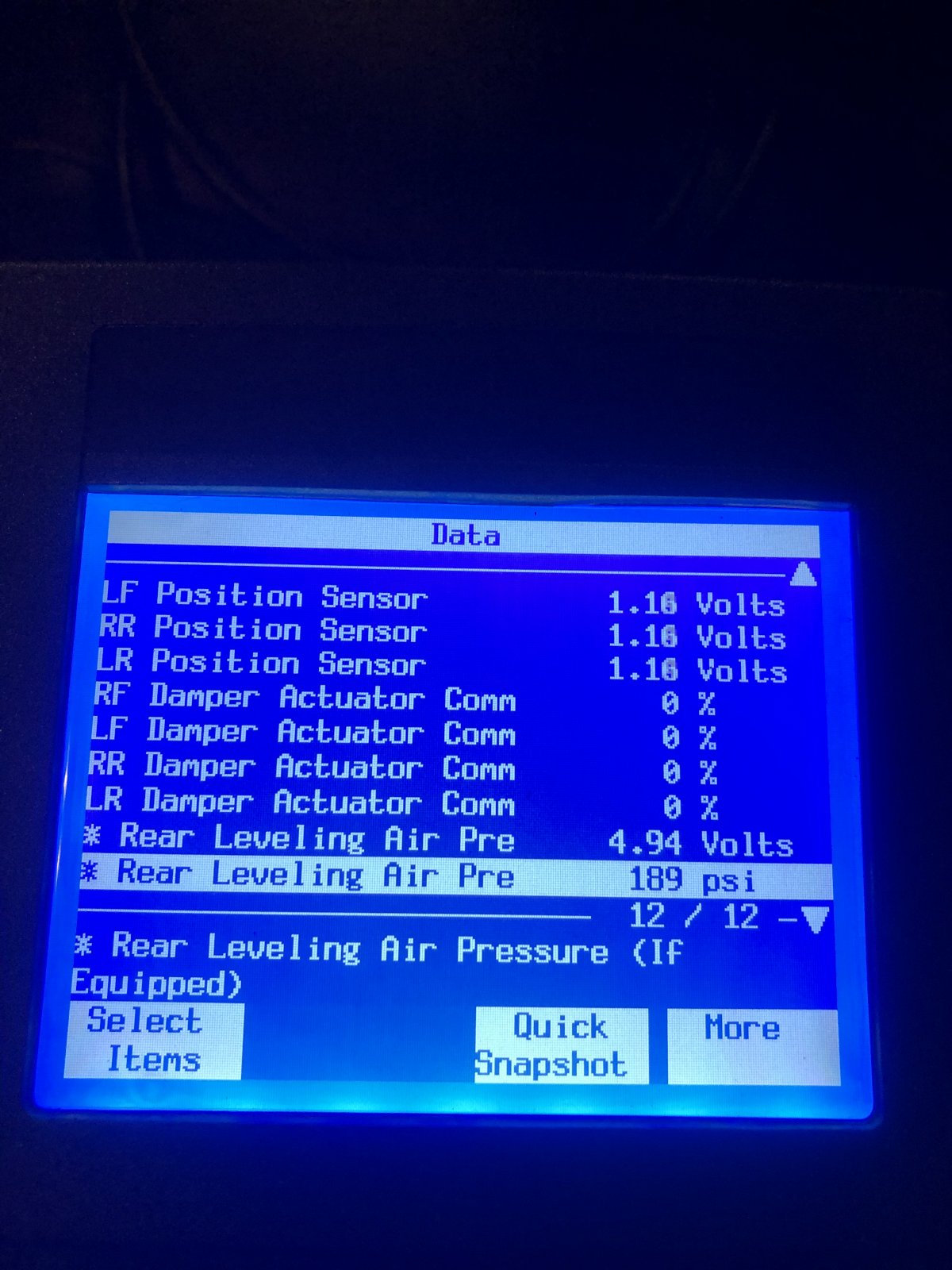

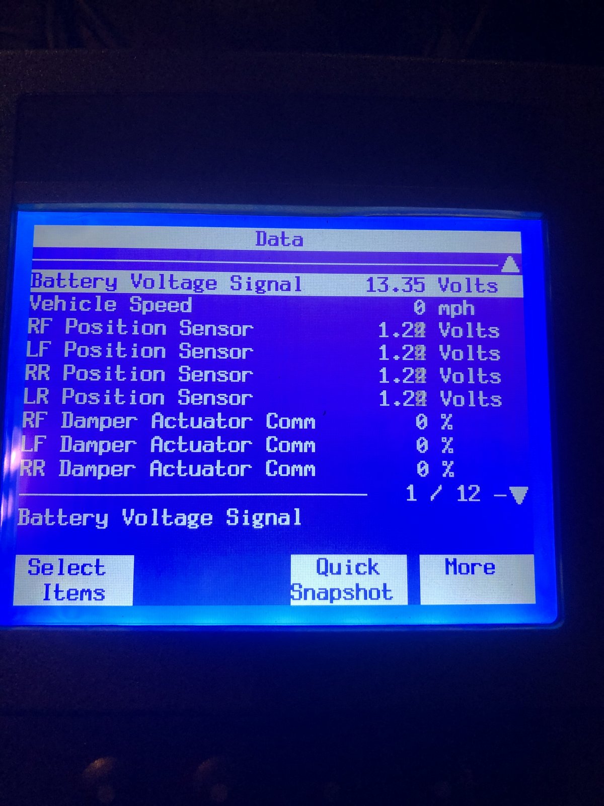

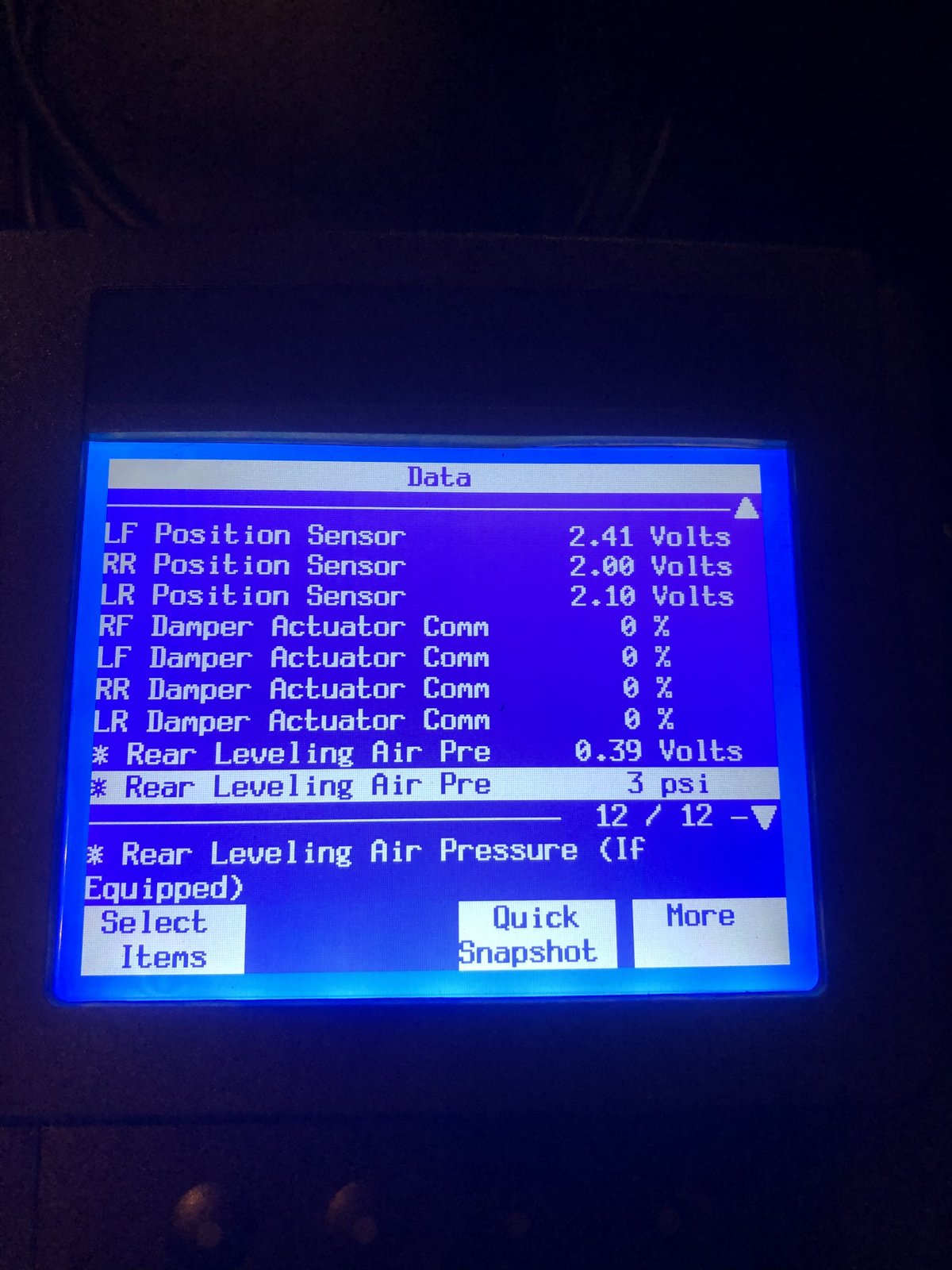

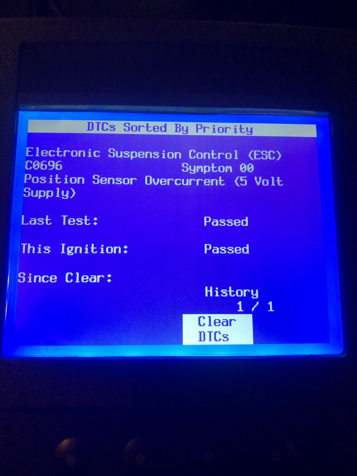

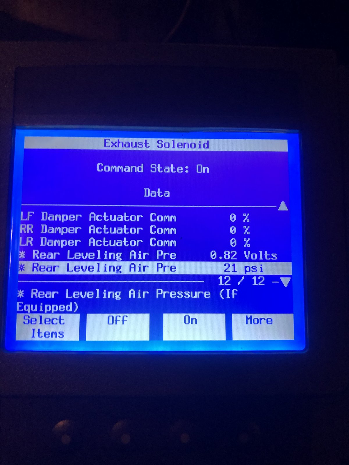

@BH1989 I hope you don't mind if I hijack but I see no reason to start another thread for this.
I am having rear suspension issues as well. I noted my compressor running more than normal and that the suspension rides lower than normal while towing.
I connected my Tech2 today and took a look at the suspension. First thing I noticed was a C0696 code that comes back immediately after I clear it. I found this TSB for the code but I don't have C0711.
The suspension pressure was at around 22 psi after the compressor self test while sitting level in the shop.
I did a compressor test and was able to pump the pressure up to about 80 psi. I did a leak check on the rear bags and found they do foam a bit and will likely need to be replaced but I don’t believe they leak at a rate to cause the issue I am having.
Next I did a test of the relief valve. This is where it gets weird. When I toggled the valve on my pressure dropped slowly but I could ‘t hear it exhaust. I did have the truck running so perhaps that was why. I have heard it before. It took a while but would not drop down below the 22 psi.
Next I decided to do the ALC calibration. So it went through it’s recalibration and then the dic indicated a SERVICE SUSPENSION warning and each time I would clear that C0696 code it would go out and come right back with the code.
At first the front and rear ride sensors were reading different values but after the recalibration they all read the same. I assume this is normal and a result of the recalibration.
Now after the recalibration and a few compressor runs I noticed the system pressure was way up over 180psi. I attempted to relieve the pressure with the solenoid but it didn’t seem to work. Just sitting looking at the data after that resulted in this video of it jumping all over. I pulled the right rear line and it went down to about 20 psi so I pulled the left one and it settled down to 3 psi. And I noted the values of the sensors were different again.

Some pics to show what I was seeing:

So your exhaust solenoid isn’t working? Either way that TSB shows the pressure sensor not working due to the wiring being shorted. Could be that’s your problem, maybe the system doesn’t know what the pressure is. I guess it’s time to have a look at it.

After thinking about this more I don’t understand why I can’t clear that C0696 code if all the sensors are reading back ok temporarily. The four position sensors and the pressure sensor are what feeds that and on my last screen shot you can see them all reading within range. I still suspect that pressure sensor.
