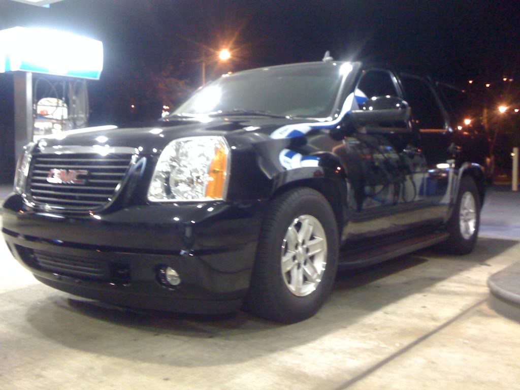

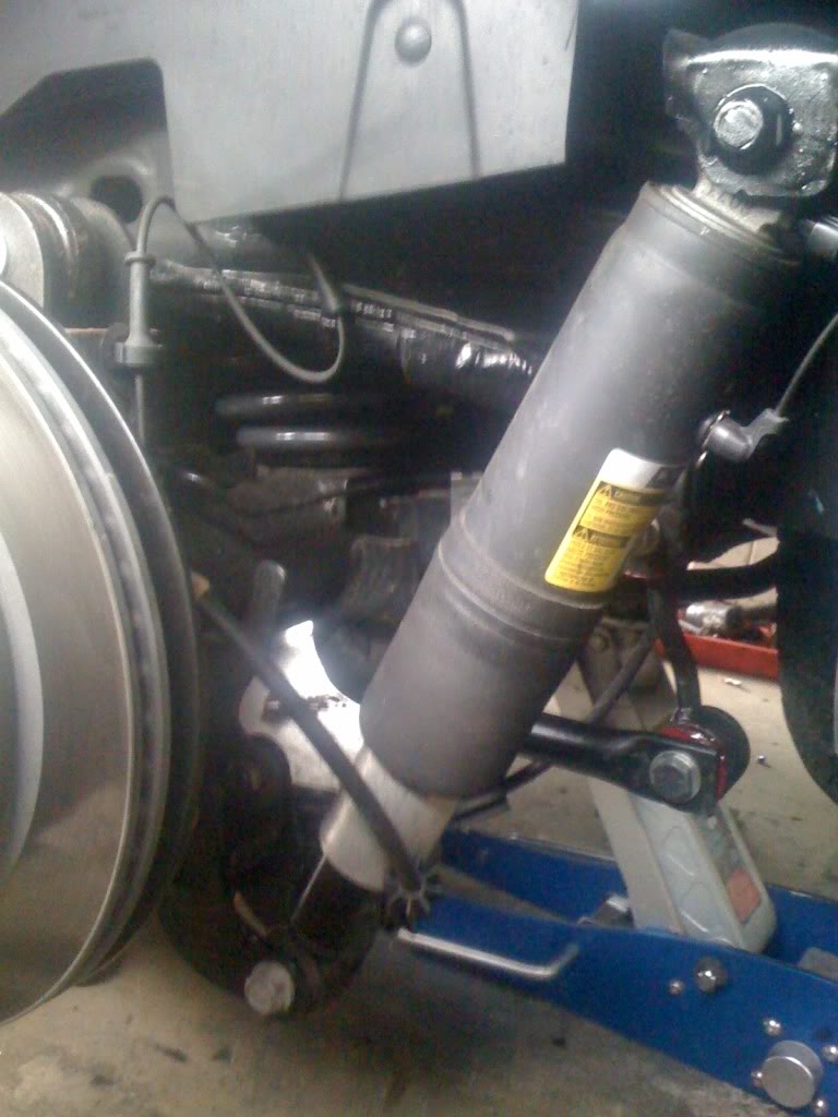

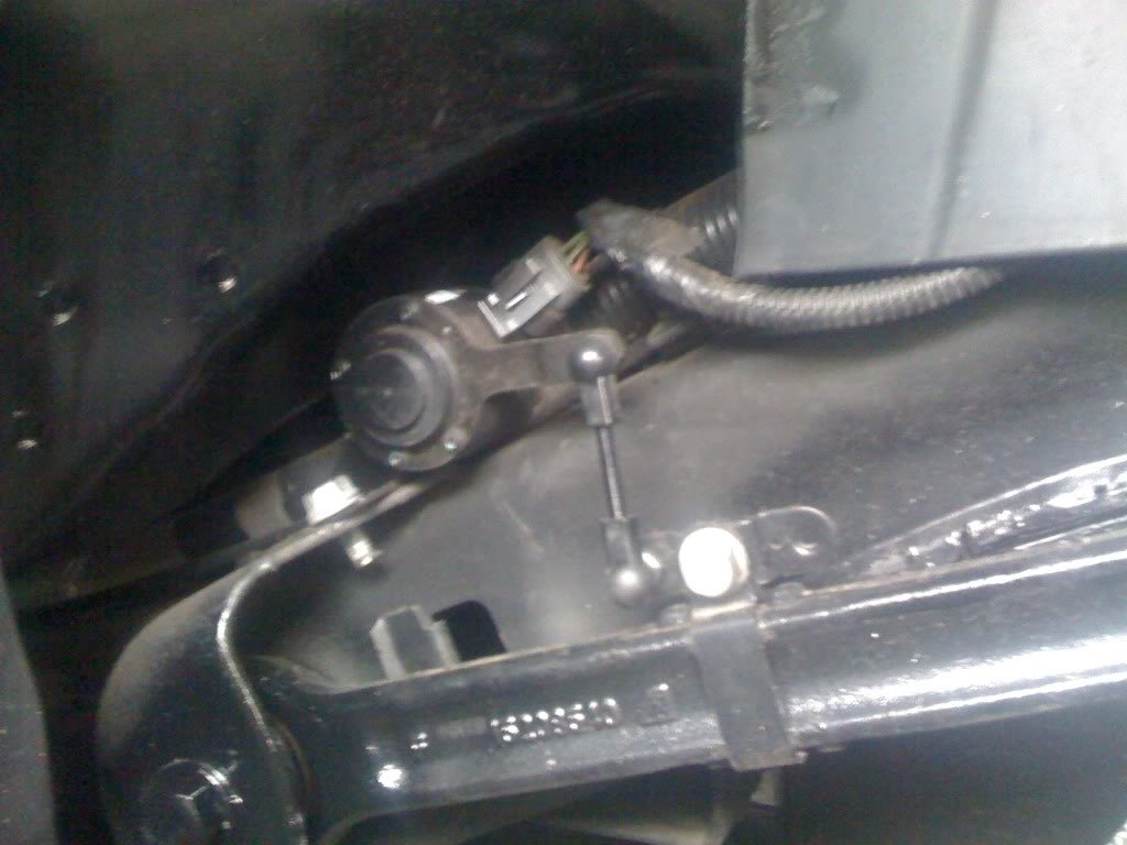

I finnaly had time to drop my yukon today, I had a set of MGD spindals and got a set of MGD coil relocaters from Tims suspension online. The rear I got a belltech trailblazer spring and the DJM axle relocater and shock extenders from DJM Direct. All the parts went in great, the coil relocaters worked realy well in the front just swaped them out and reused the auto ride shock. I set the to a 1.5" drop but the can go down to 2". The truck rides great I shortened all of the autoride sensors and it seems to have worked realy well it still rides like its stock. I marked all the sensors at stock height and just realigned the marks after the drop. heres some crappy photos I too ill try get some better ones tomorrow.

That looks to be a clean install, also has your Yukonssitting just right!!
I like it!!
How is the ride now, your shocks look to be hella compressed even with the extenders?

The ride is really good, and the shock is actually in a realy good position maybe its the angle of the picture but it still has alot of travel and it keeps the springs from falling out when i jack up the frame and let the rear end sag. So far everything looks good hopefully the rear settles alittle more and when my rims get here it should sit just right.

Wow that looks lower than a 1.5 drop in front, that yukon is sitting perfect.

Its a 3.5 in front JT, spindles and relocators.

BTW on your autoride did you measure before/after with the springs in.

Thanks for getting the axle relocater for me DJM Direct, and I did measure the height sensor in the first picture you can see a white mark on top of it when the two marks align the sensor is back at stock ride height. Thats how I did mines marked it at stock height then just realigned the marks using threaded rod after the drop it worked really well I left them alittle short so when the springs settle it should be perfect.

btw if you get another threaded rod you can make them shorter in turn lowering the truck more.

How do you make the sensor rods shorter without losing the threading?

I bought a three foot long threaded rod from the hardware store and just cut it down to the lengths I needed to adjust the sensors, Just get a rod thats the same diamiter as the stock ones and it whould thread in fine. The stock rods arent threaded there splined so you just pull the ends straight off. im gonna try shorten mines today and see if I get any more drop out of it.

yah sorry about that they are splined im thking about the trailblazer set up we have
