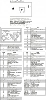

54 looks like the compressor pump for the rear auto level.
I am pretty sure just pulling the fuse will not make the "service suspension" go away. Otherwise there would be no use for the resistors, and this conversation. It might work on some cars, but in this case I do not think si.
