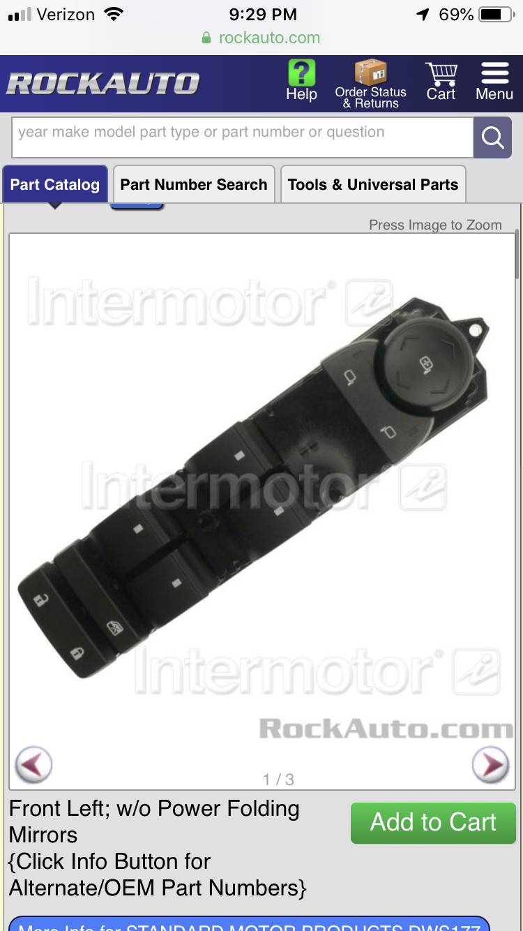

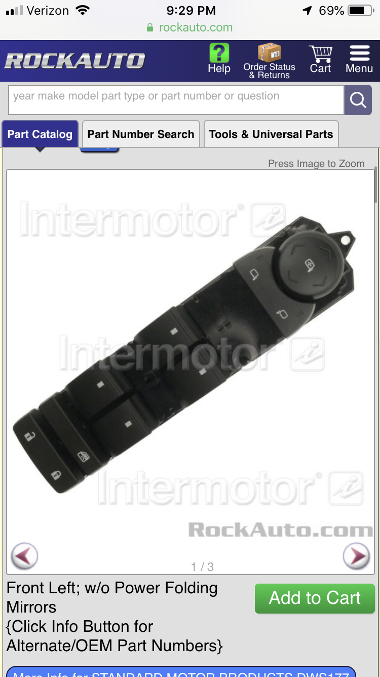

Just to be clear, we are talking about the switch cluster that is on the door handle correct?

Thank you!
All shops I called including the dealer want more than the brand new oe switch costs to program...
THANK YOU! I just found one from an ltz on offerup! I have an LT, but it looks the exact same, it should work right?
Ill see if the guy replies and if I can test it before I pay for it, then I can just return the new one!
Thanks so much man.
Should, you'll want to know if you both have the same options, or that the LTZ has more than you (set off code?). I've only read about this, not actually been through it.
