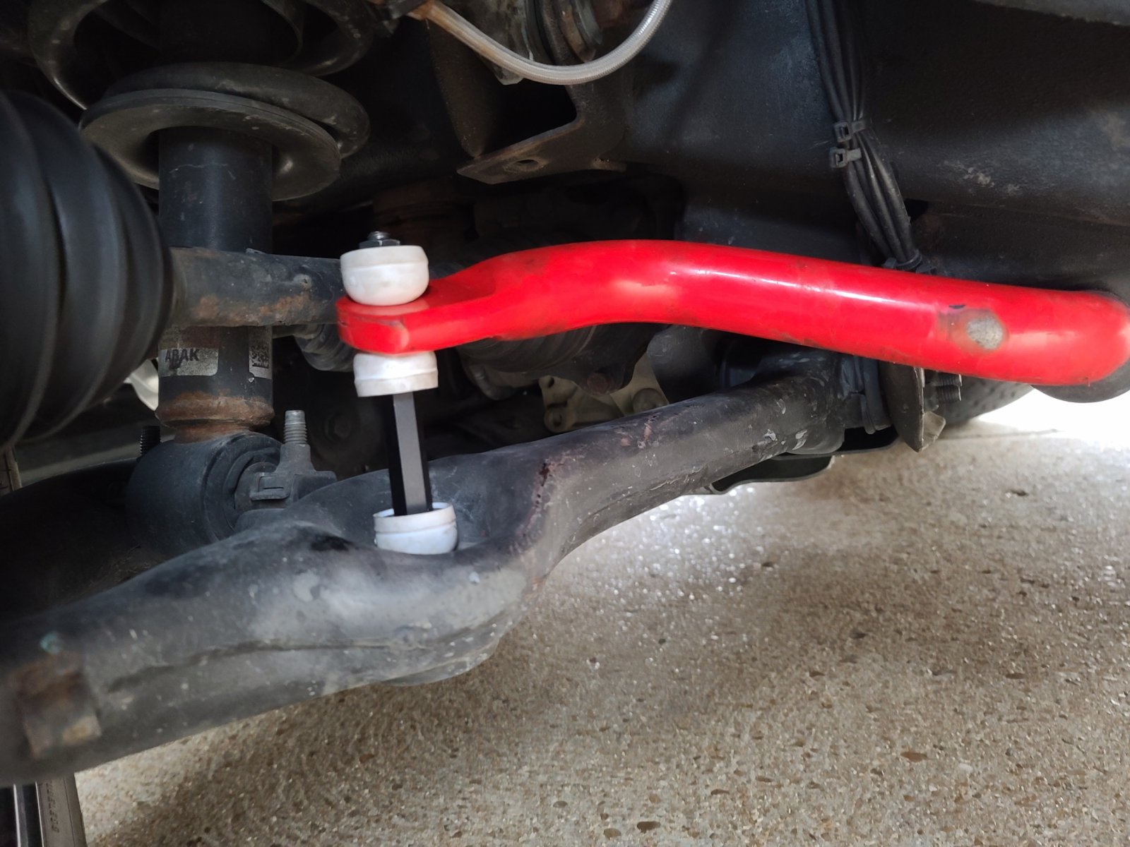

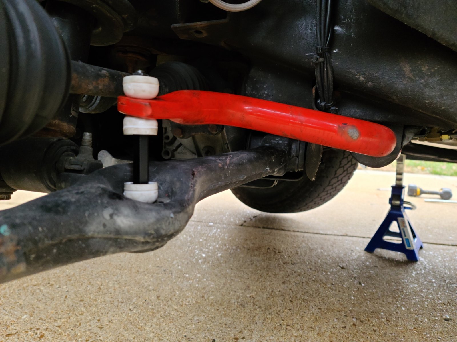

Does anyone have pics of Eibach front swaybar installed, i need to see how Eibach ends sits on corners with end links attached. For some reason my sits on angle. I called Eibach and they said it will be angle and Eibach logo on the back have ti be right side up. Here how mine sits. Btw i do have 2" drop spindles and Moog end links but that will not change angle of lower control arm

I don’t have the Eibach sway bars, but I did install the Hotchkis #2292 front and rear sway bar kit on my ‘15 Yukon XL Denali. The Hotchkis kit came with new front end links that were a shorter than OEM.
From the pics you’ve posted I think if you can find some shorter end links it would fix your swaybar postion.
That flat piece “flange” on the swaybar that has the hole in it for the endlink to go through. You want that to be as parallel to the ground as you can get.
From the looks of your pics I bet you could shorten your endlink be at least 1”-1-1/2”. Easiest way to measure would be to disconnect the bar from your endlinks, leave the bar in the other 2 mounts, but loosen them up enough so you can rotate the bar. Rotate the bar until the swaybar endlink “flange” is parallel to the ground. Then measure where it hits on your endlink and that’s how much shorter of an endlink you need to get.

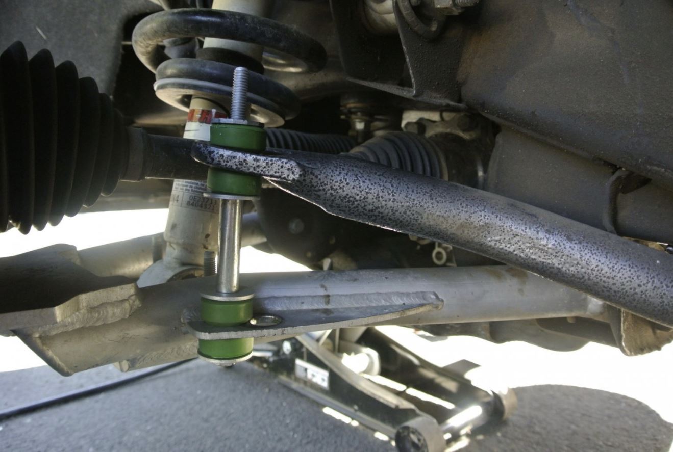

this is what I ended up doing with my silverado when it was lowered

Lowering your truck DOES change how the sway bar sits, as the distance between your truck's frame and the lower control arm has changed.
As folks above suggested, you need to shorten the sway bar end links to the point where the sway bar is level to the ground.

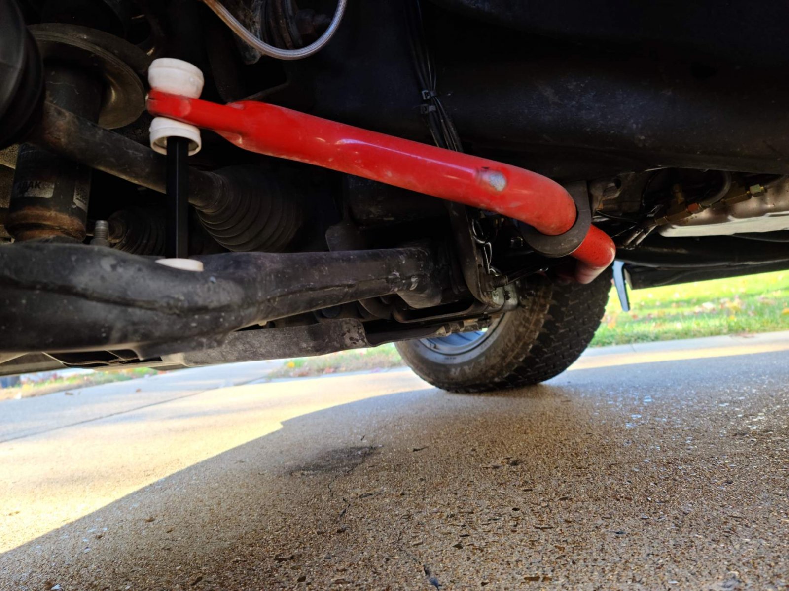

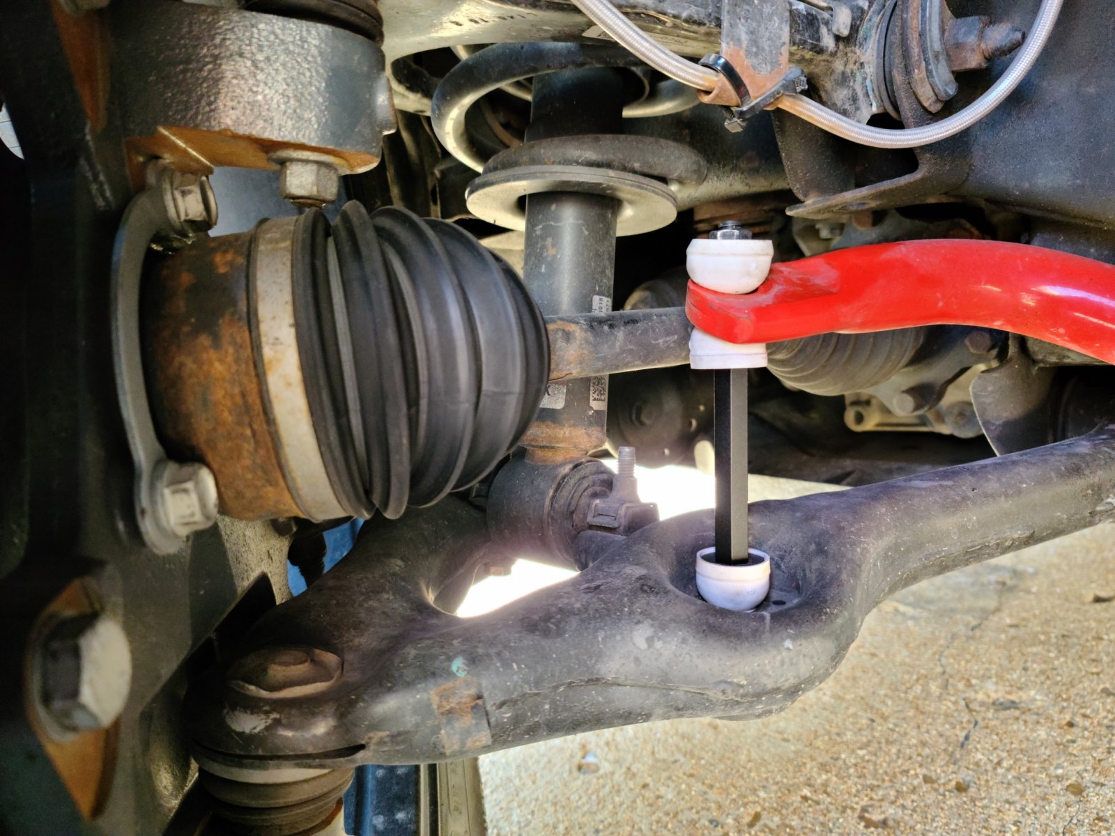

End up installing swaybar with Eibach logo right side up like i installed first time
Untill i got some fully threaded 6" grade 8 bolts i shorten Duralast gold bolts 1.25", and also Moog spacers. For now im using Moog bushings and nuts, Duralast for spare.
Here is how it looks now, much better than before
1st pics up in the air, 2nd car on the ground
