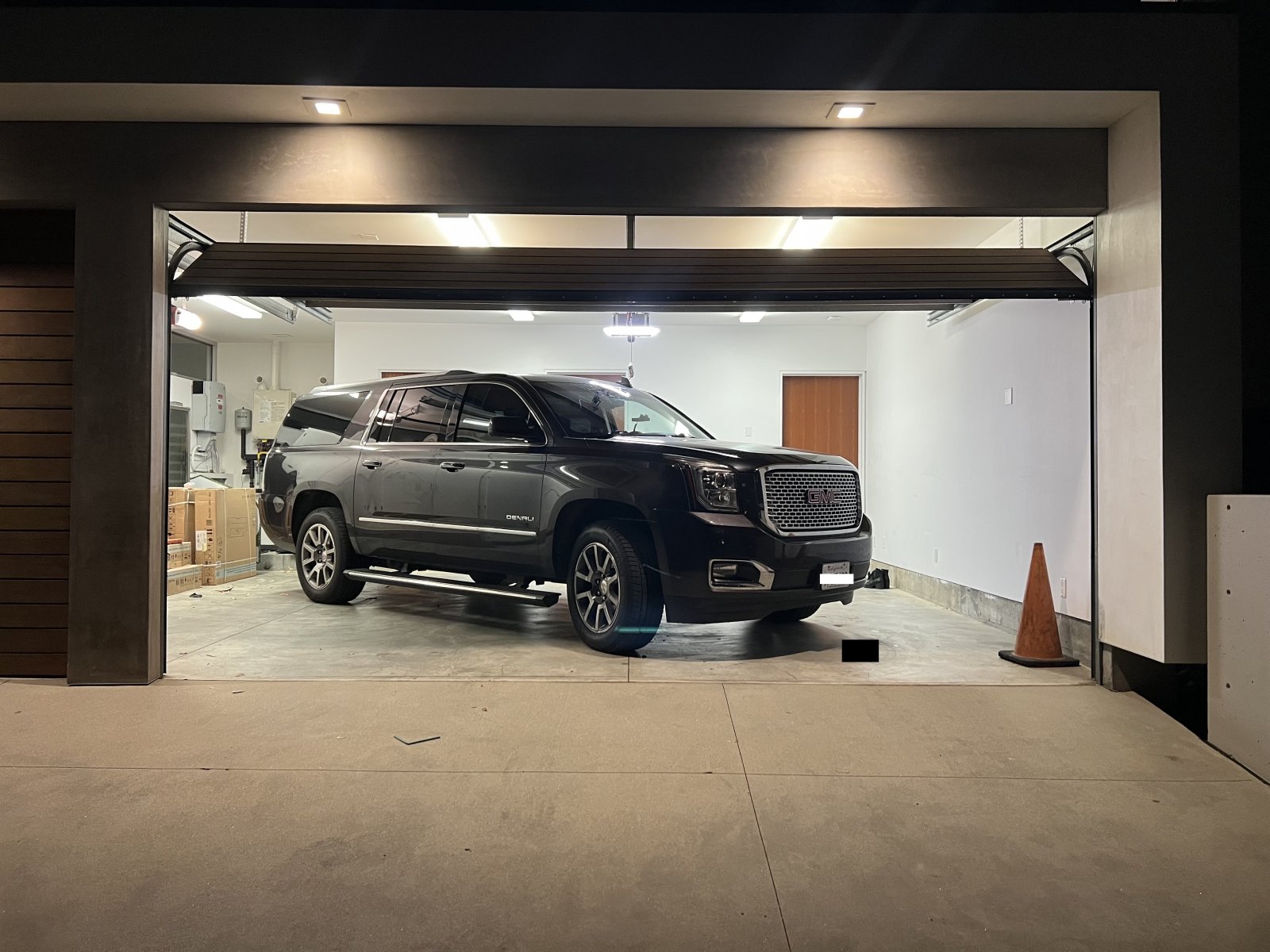

Thank you! Here's the pic of the truck 1000 miles after the Arnott front Shock and Springs.

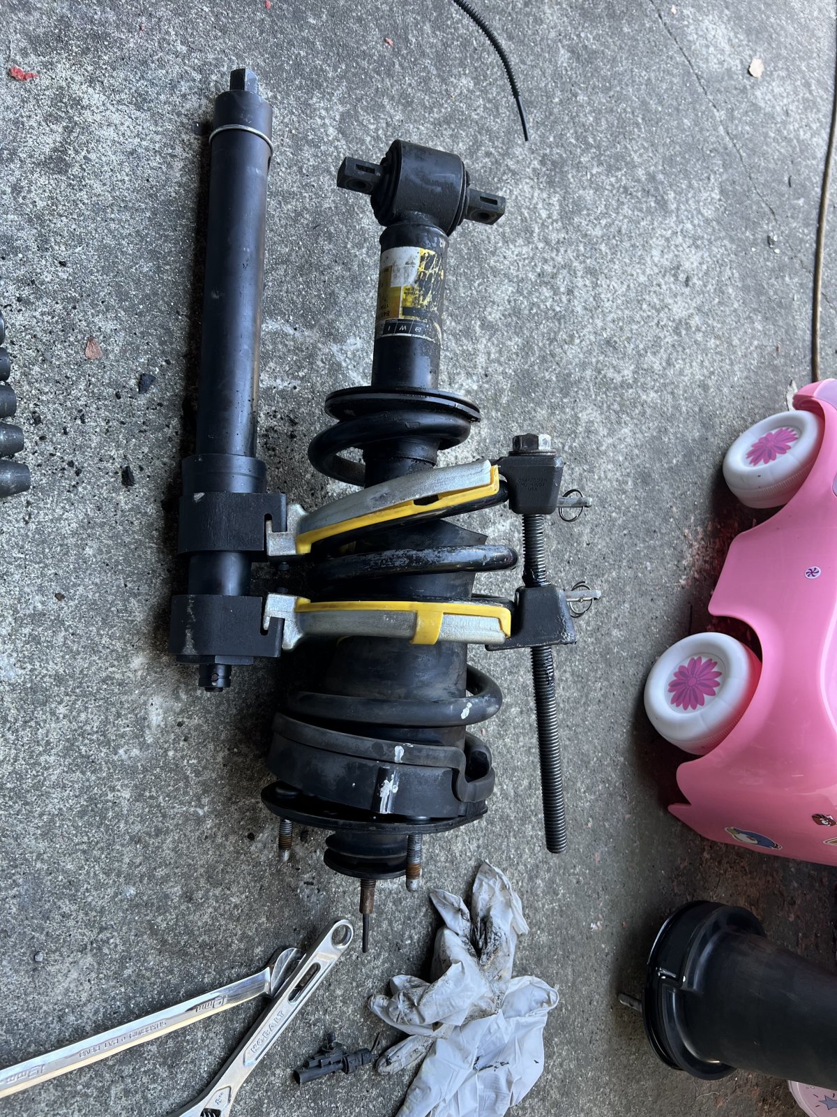

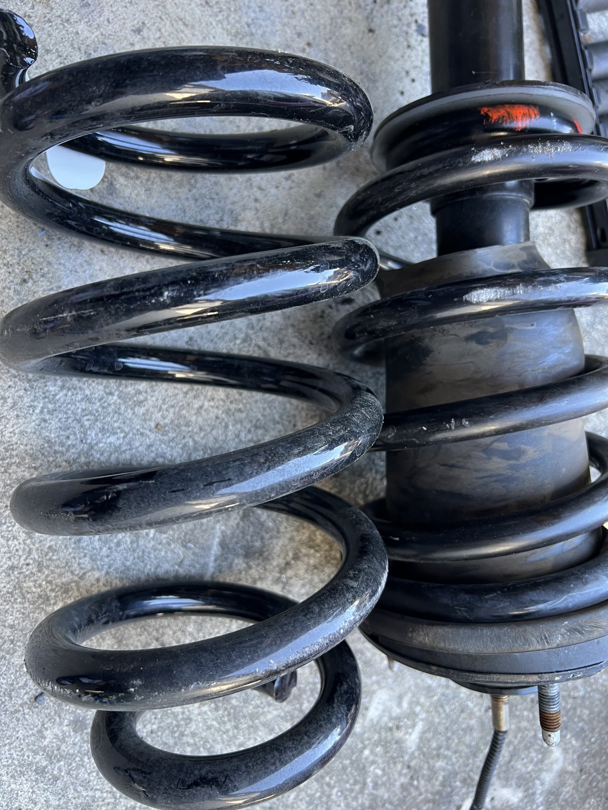

Major update:
I could not take it anymore and installed the stock springs back in. The Arnott springs were significantly harder to compress. The coils were 50 % physically fatter than the OEM springs. My regular clamp compressor could not hook properly due to the coils being so fat.
i purchased another HD strut compressor. Even with the Heavy Duty strut compressor, I needed an additional spring compressor on the other side to properly compress this spring. So I ended up using 2 spring compressors to remoe this spring. I used the old top strut mount hardware as the Arnott hardware looked different. had to cut the magneride wires to remove the top mount. Soldered back on.
Conclusion:
The ride quality is soooooooooo much better on the OEM springs. I am still using the Arnott shcoks, but now with OEM springs. I no longer bounce around when I hit bumps on the road. Going over speed bumps and humps in the road no longer fully extend my suspension.
Ride on OE springs is supple
Ride on Arnott springs bouncy and stiff
I can't recommend the Arnott setup anymore. Even if the shocks may be OK, the springs killed the setup. So if the only choice is to get the magneride shocks, may as well get Genuine ACD. the Genuine ones are currently cheaper than the Arnott options for just the shock.
Also, the driver side shock alraedy has fluid on the shaft. only drove the car for around 2000 miles. I noticed this when I removed the springs. it could be the oil on the shaft is from assembly? but im not hopeful. if the leak gets worse, I will absolutely be getting genuine GM part, and not Arnott.
I currently use an Arnott compressor on the benze. been workling great. but I dont think their specialty is springs. What sold me on buying the Arnotts was not the price (its only slightly cheaper than getting Genuine ACD shocks, but def less labor)but I read on one of the forums that Arnott used Eibach springs. this is NOT the case. They may use on some other products but mine were not Eibach.
I hope this helps someone make the right choice. I know I debated back and forth between all the options for magneride replacement.

left one is Arnott springs, right one is genuine GM springs.
other pic is the spring compressor setup i used to remove the springs
