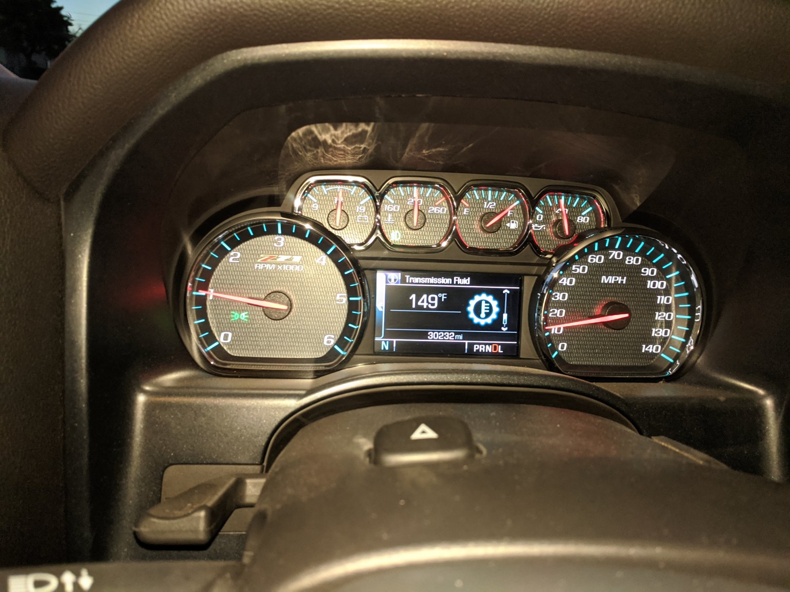

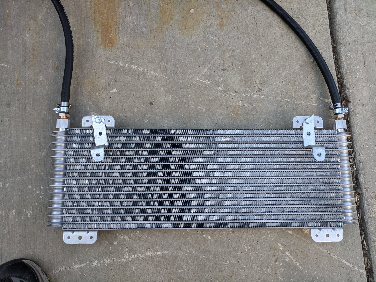

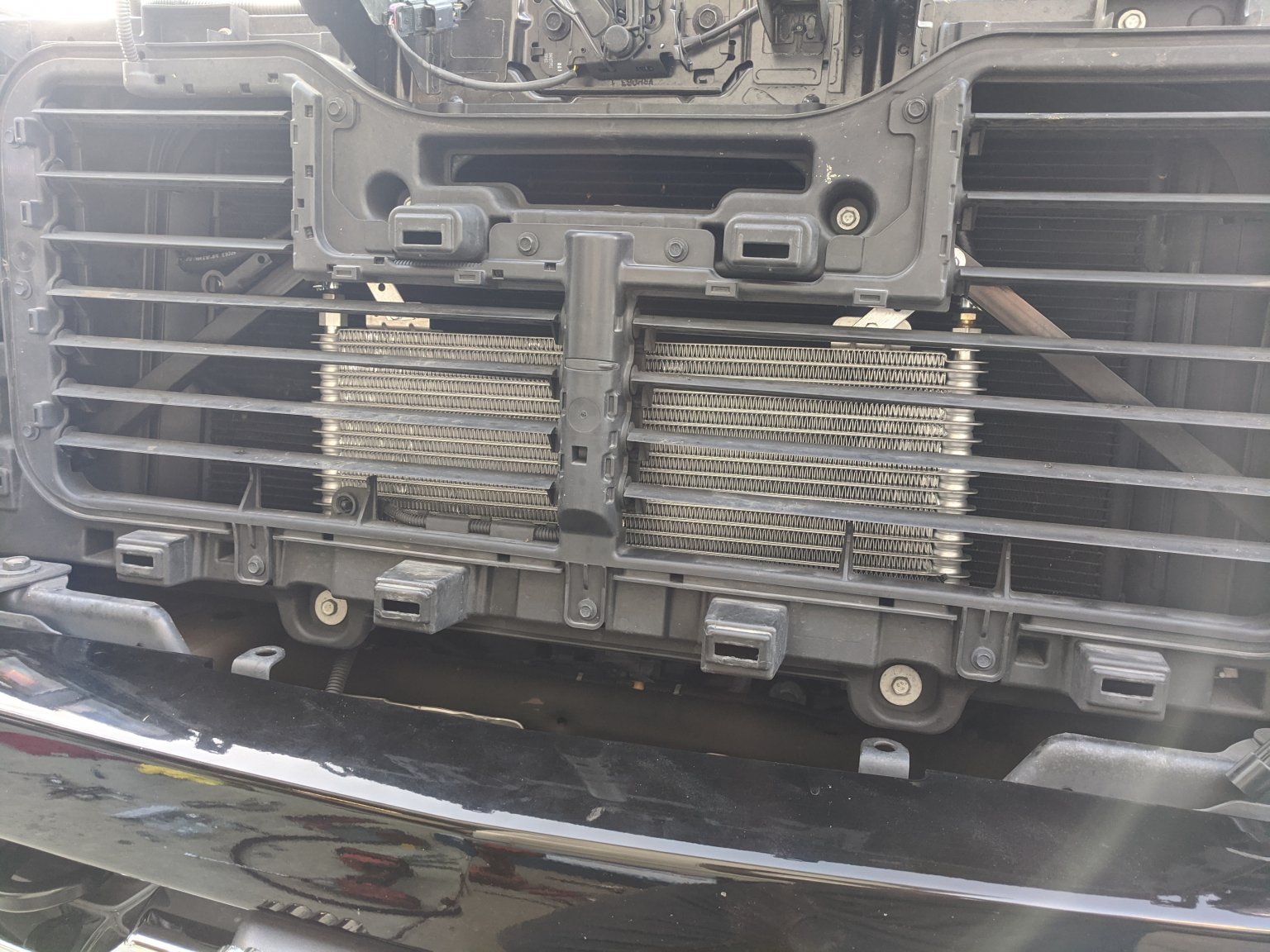

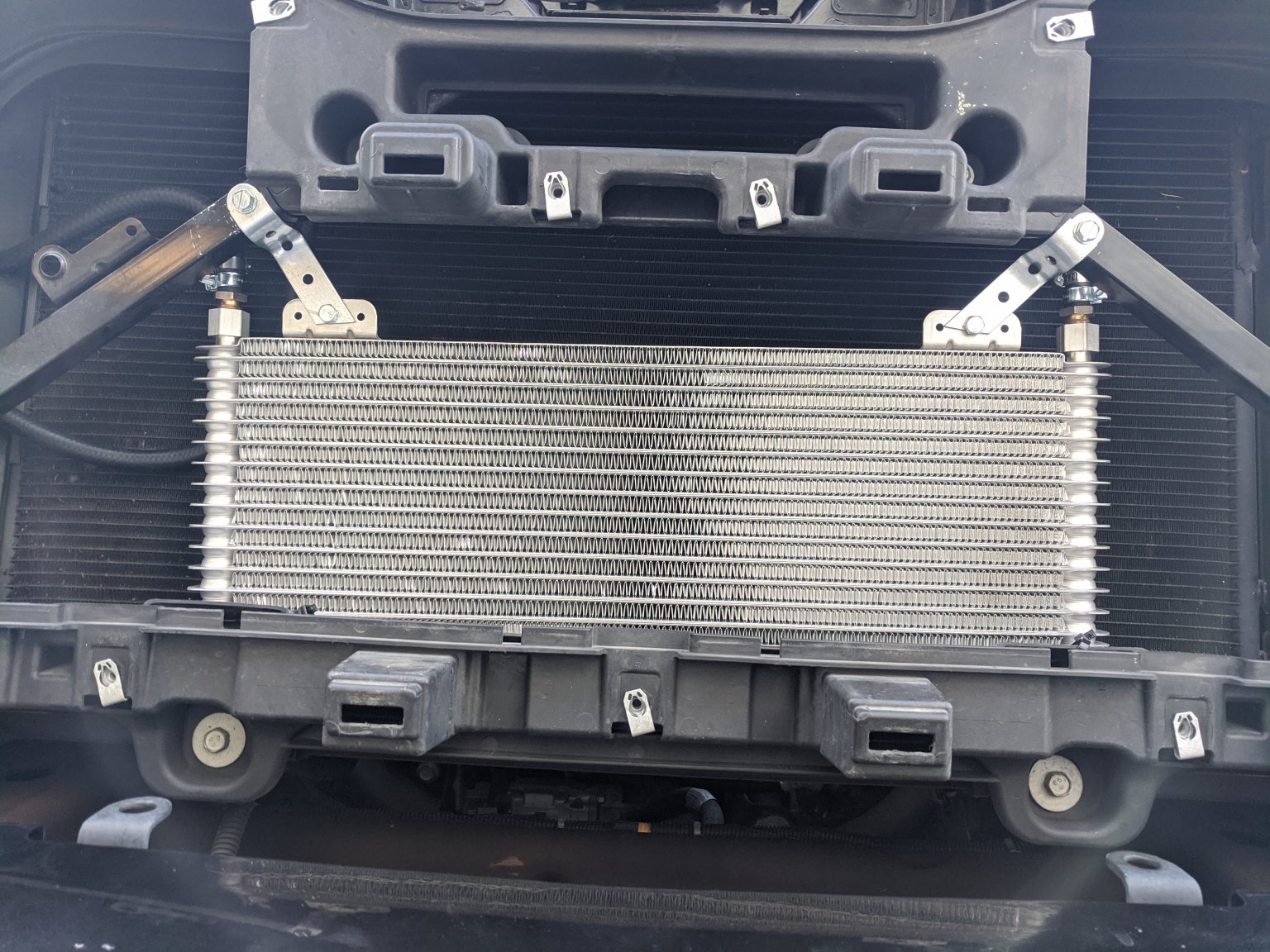

added the true-cool 40k, before I added the cooler I had already deleted the transmission thermostat, with the thermostat in place originally trans temps were 190-220+ almost always, deleting the thermostat dropped it down to about 170-190, adding the true-cool dropped it to about 155 after a good little workout, just cruising it was 122-135 ambient temp was about 75deg
took me a little while to get it installed this is a universal kit, it was simple enough to just pull one pipe, cut it and flare one end (discovered I don't really have skills for flaring) then fit a hose over it and clamped it, ran the hose thru the plastic, used the supplied brackets with a little bending and cutting, not all professional but it works and should remain trouble free for many years.
I installed it to work in unison with the factory cooler, I did trim a couple small pieces off of the shutters for clearance even though the shutters are disabled by blackbear if I have to put the tune back to stock then it wont give me any problems blocking the shutters from working.

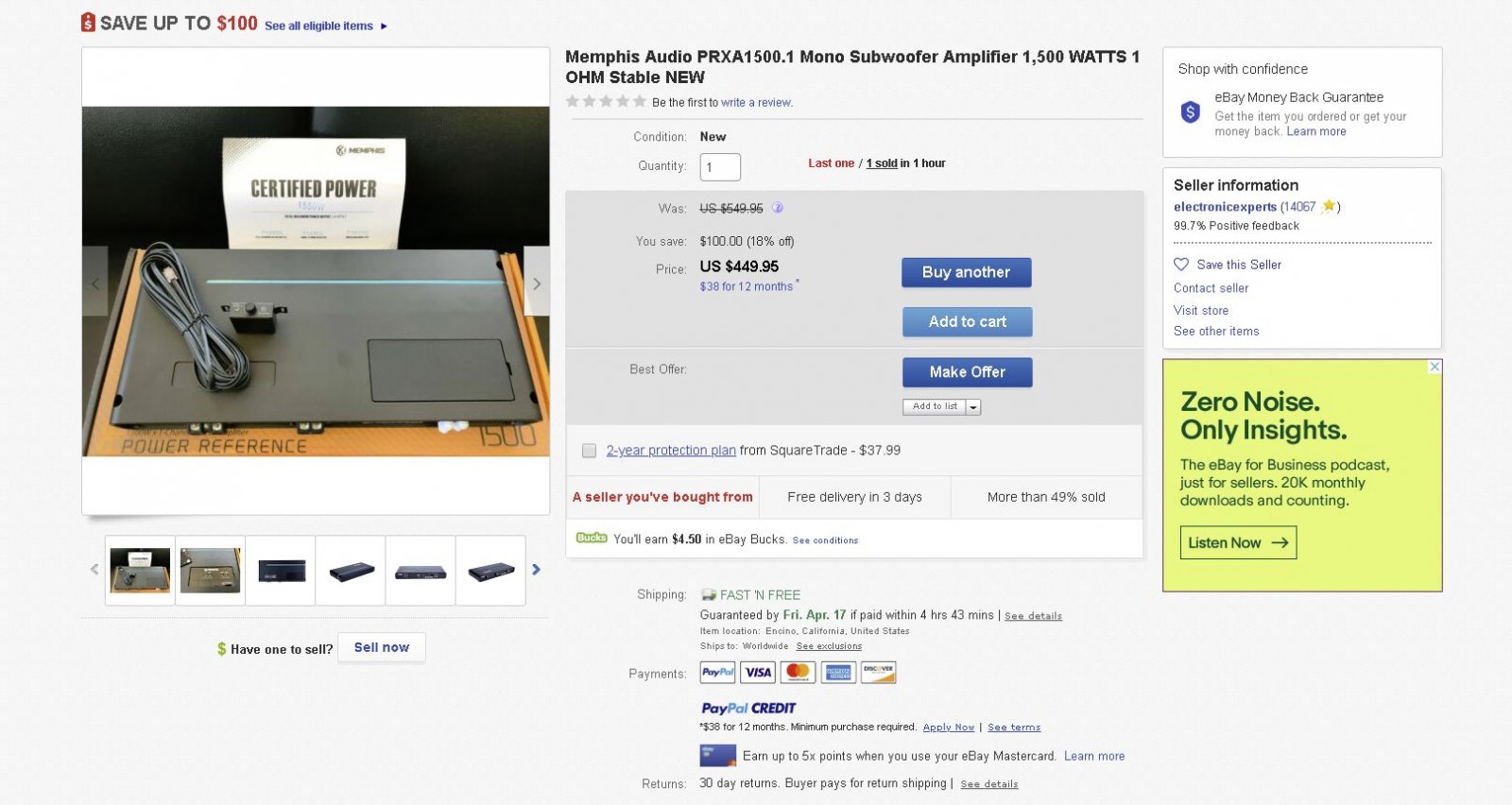

had to buy the memphis audio amp AGAIN from another seller, the guy it bought it from put up a tracking number and it never scanned, 2-weeks later he was just full of excuses so I had to open a case with ebay to get my refund, weird the guy has no bad feedback and is a 20 year ebay seller I expected better.

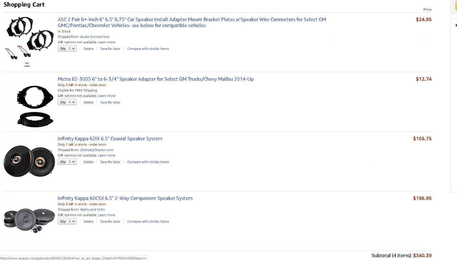

Installed the rear door Kappa's then of course it decided to start sprinkling, I kinda want to get all the speakers and amps in and then hopefully the head unit will be released by then, still need a few supplies first namely I'm hoping they make a adapter from the stock amp plug to a aftermarket one

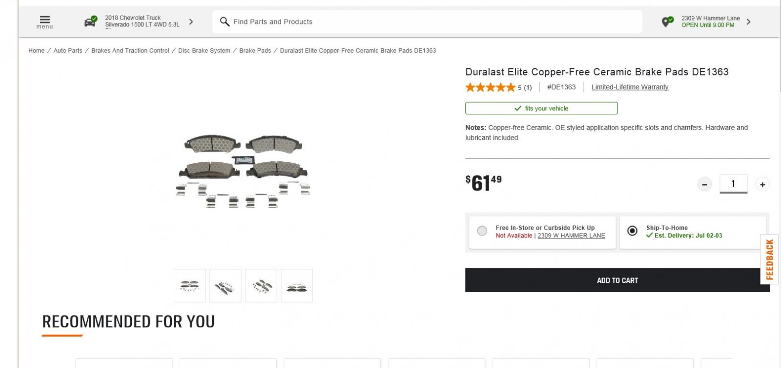

brakes started squeaking at me today so new rotors and pads on the way, ordered the powerstop police rotors, not sure why they only market these to the 08-19 tahoe's the dam things are just oem rotors that they vented, drilled and slotted. and apparently copper is being removed from brake pad material because it is "hazardous" :rolleyes:
