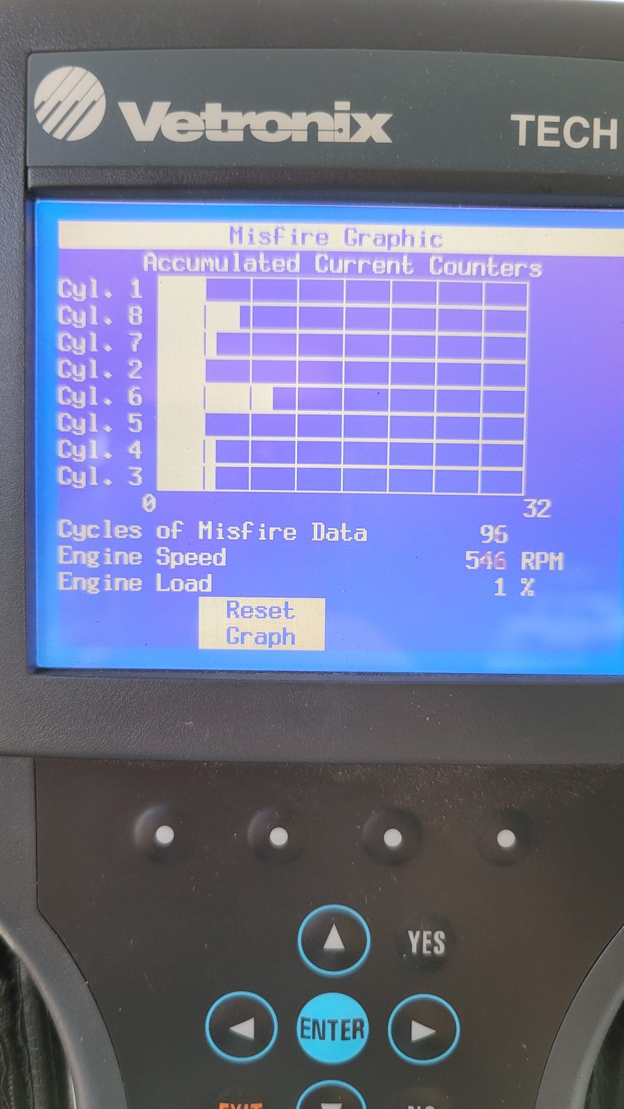

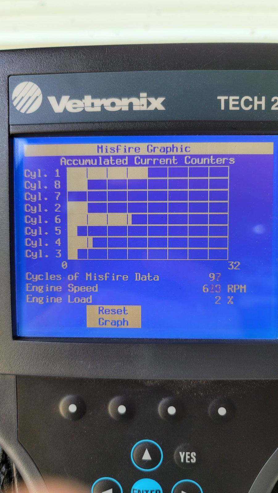

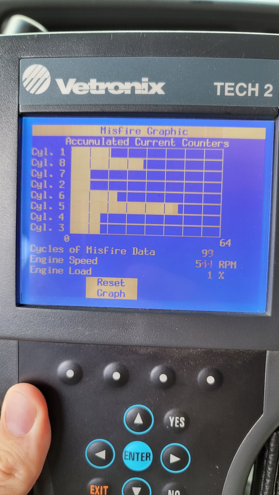

It comes on a few trips after clearing it. I replaced plugs and wires. I've tried both .060 and now .040 gap plugs. NGK TR5 currently. Wires are Taylor. Fuel pressure is low 50s at key on, engine off, holds pressure. Fuel pressure running is high 40s.
Reading the misfire graph in Tech2, all cylinders are misfiring, but some are worse than others, and it varies. Swapping plugs, or wires, or coils does not make the misfire move. STFT and LTFT at idle, 1500 and 2500 rpms are always below 10% and within 2% of each bank. O2 voltages are toggling as expected. I think I covered everything so far. Any thoughts on what to check or where to go next with this? It feels like it idles and runs smooth, the misfire isn't detectable by driving, only because the light pops on.
The screenshots were taken at different times/days. I don't recall which one, but I believe one may have been at cold start, the others were at operating temp.

the screen shots from the graph is live, I can monitor them as they happen. Different cylinders count more misfires each drive cycle, as you can see. Each screen shot is a completely different drive cycle.
