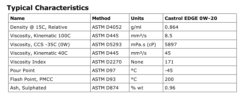

Here the Castrol 0w20
Viscosity at 40C: 45
Viscosity at 100C (operating temp): 8.5
Plain and simple.

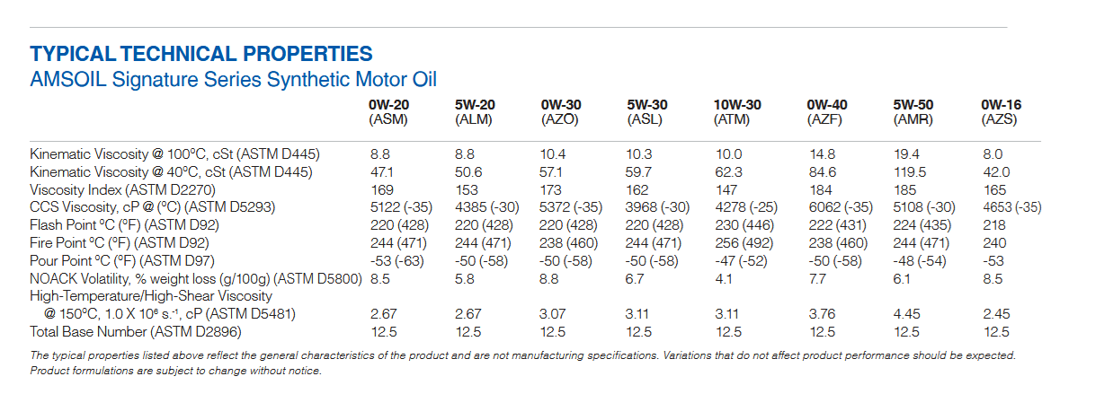

One important spec missing; Volatility
Fact, dexos allows 13% loss
AI Overview
Engine oil volatility
refers to how easily oil evaporates ("boils off") when exposed to high engine temperatures. Higher volatility leads to increased oil consumption, sludge formation, and reduced protective capabilities, especially in hot-running turbocharged or direct-injection engines. It is measured by the Noack Volatility Test (ASTM D5800), which defines the percentage of weight lost at 250°C.
AMSOIL Signature Series 100% Synthetic Motor Oil
