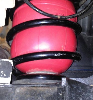

Installed the helper bags on the Hyhoe last night. Smooth install and everything went well.
The good news in that with no load and aired to just 15psi the bags do raise the rear a half and inch which is what I was looking for.
Bad news. Even at full pressure 35PSI with my boat on the hitch I still get a drop of about a half to 3/4 of a inch in the rear. Which is to be expected, it's a heavy boat. Since the bags are also a "custom" setup for the tahoe since it's lowered they don't fit perfect and the air hose get's a little pinched. I called airlift this morning and they are sending my some protectors which should help with that. Yay! I get to remove the springs again lol.
With the small sag when loaded I am going below level which means I will hald to order the drop struts from norcallSS, to drop the front and inch. I hate the Cali lean and I especially hate it when towing.
