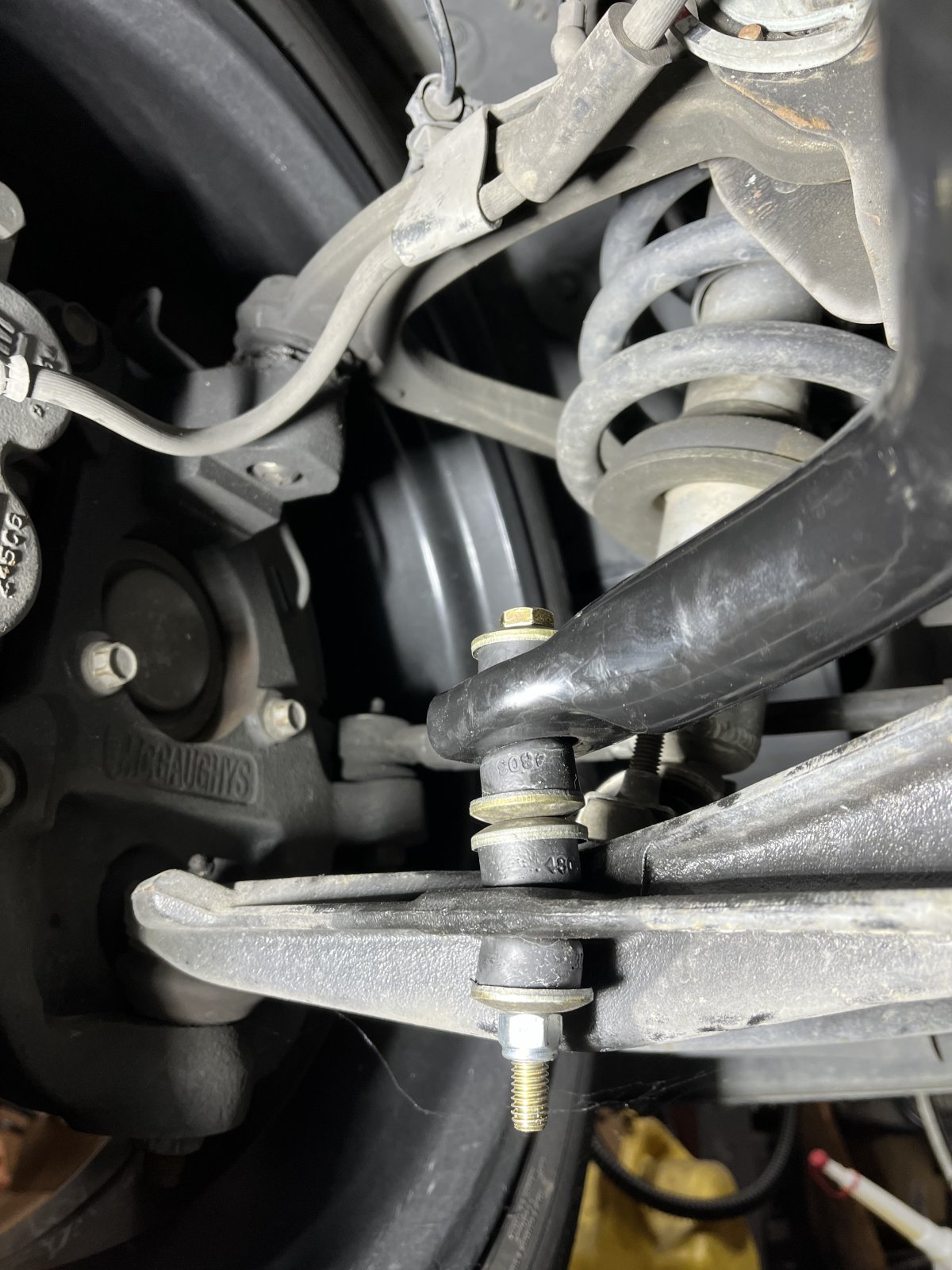

Both coils are brand new 1” maxtrac drop springs.
But one could be defective. You could swap the strut assemblies left-to-right to test, but you've already dickered with the different amounts of rings between the two. If you have it in you to put them both back even, reassemble and test, it might be worth it just to rule that out.
If I cut the tube any more the sway bar will contact the lower control arm.

I’m going to pull 1 more ring off for a .5” drop and I just order new links. These were over torqued and are smushed. Maybe with a new set torqued to spec it will help.
I’m assuming the sway bar only needs like a 1/8” gap between it and the lower control arm?

Mine is dropped 3.5" in the front with Belltech struts and McGaughy knuckles. Maybe at the most an 1/8" difference left-to-right with one 1/4" ring on the driver side strut (1/2" lift) and none on the passenger side strut. My crazy short end links got the sway bar really flat/parallel with the frame. I had to relocate the sway bar mounts on the frame back about an inch. I drive it like a Miata and have no contact anywhere other than the front tires rubbing the fender liner and inner fenders at times. The sway bar rests on the lower arms when I pick the Tahoe up on the lift and the front suspension droops. But that doesn't hurt anything other than rubbing the paint off the bar.
It was driver low with the bilsteins so I doubt it’s the belltech.
I meant with the MaxTrac coils. Height differences will happen if one coil isn't seated properly, but it they look correct on your pics. Remember that, due to the geometry, any discrepancy is doubled. A spring not seated properly and sitting only 1/2" taller will cause a 1" taller side. So, if you're 1.5" high on one side, something about 3/4" is holding it up.
It cycles up and down with the arm. So, other than the bushing deflection, it shouldn't contact. If you have the same amount of drop as me, you might need to relocate your bar like I did. With the arc of the sway bar's swing, the holes in it were about 1/2" out of alignment with the holes in the arms. I unbolted the arm from the frame and bolted it to the arm without the end links- just one bushing between the bar and arm. Wherever this pushed the bar back is where I drilled holes and relocated the mounts on the frame. Thankfully, I was still able to bolt them to the original pads on the frame. Barely, but they fit.

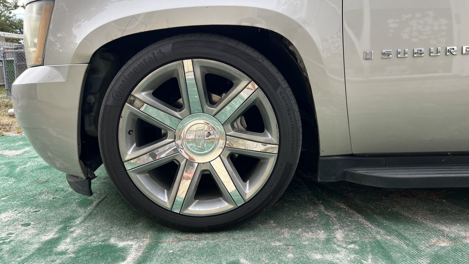

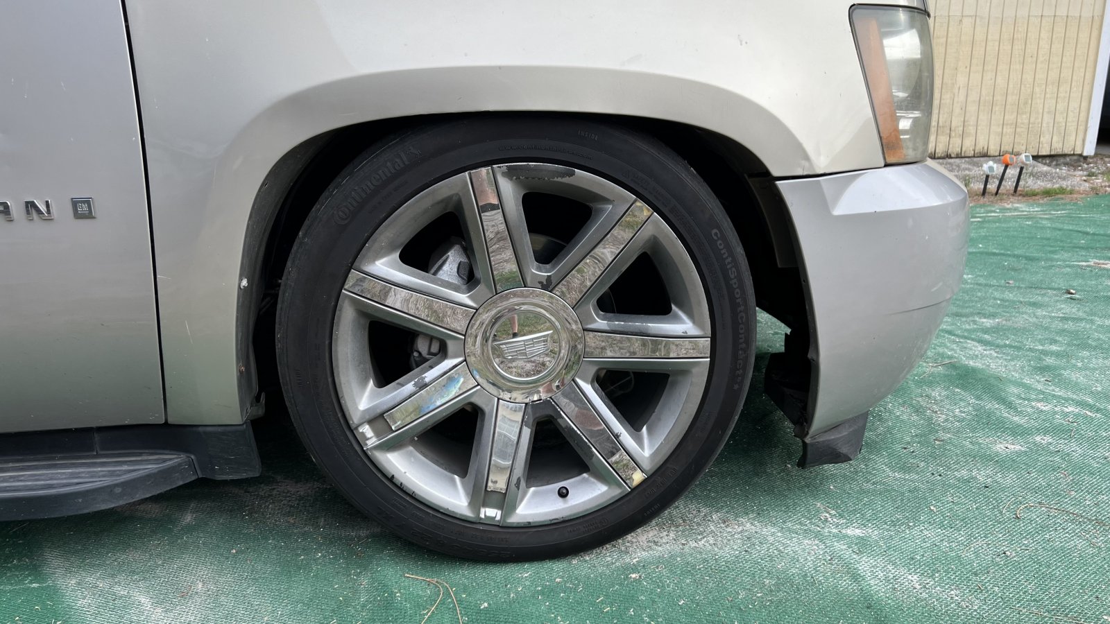

Somehow after 5 years, my truck decided to sit lower on the pass side by just over 3/4”. Or the driver side is magically higher lol. Idk if it happened gradually or what but I haven’t driven the truck in 4 months and just noticed how bad it was recently after I pulled the car cover off to just stare at it

Somehow after 5 years, my truck decided to sit lower on the pass side by just over 3/4”. Or the driver side is magically higher lol. Idk if it happened gradually or what but I haven’t driven the truck in 4 months and just noticed how bad it was recently after I pulled the car cover off to just stare at itView attachment 427186View attachment 427187
