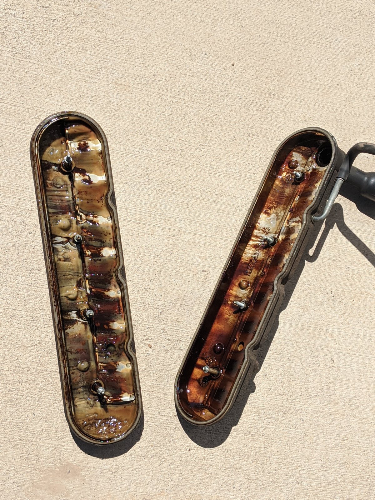

A couple of years ago I had the same issue. I finally had to accept it had to be leaking internally. I put the pressure tester on and left it on overnight. I saw no drips, smelled no coolant inside, the rear heater core was dry.
I finally pulled off the valve cover gaskets and saw this in the thread linked:
https://www.tahoeyukonforum.com/threads/latest-oil-change-oil-filters.99646/page-4
It is important to note that this was NOT a Castech head. To spot this I had to:
  • Remove valve covers, clean suspect areas. Suspect areas are easy to find because leaking coolant partially cleans the area anyway.
  • Install pressure tester and pressurize to 15 psi.
  • Inspect for seepage.
  • Final diagnosis: oil sample analysed and found evidence of coolant.
Removing the valve covers takes about 1/2 hour, maybe less. (I work slowly!)
Also note that if the leak is slow enough, the PCV will remove water from the oil before it becomes milk chocolate. However, over the period of an oil change, coolant additives and ethylene glycol can sludge your oil.

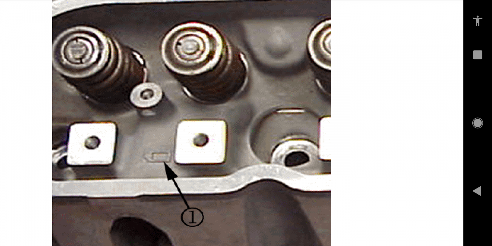

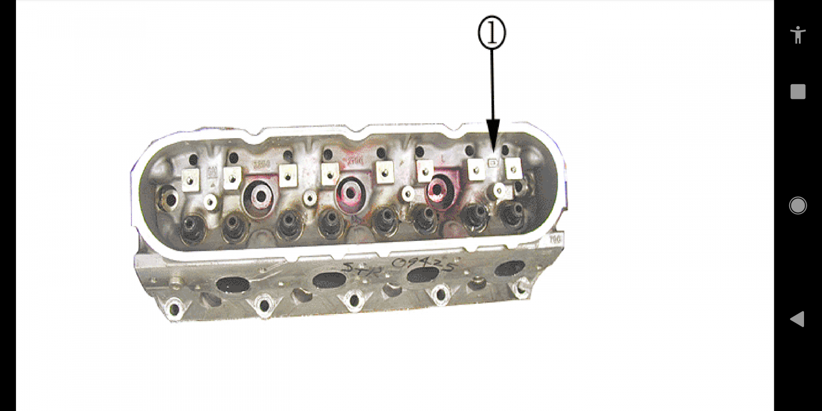

Looking at the photo in that link I noticed the rockers still installed. The TSB on this indicates the castech casting logo can only be seen with the rockers removed. Here's a couple screenshots from the TSB.
View attachment 245903 View attachment 245904
I am currently experiencing this very same condition, although I also do not have the bubbles that @Doubeleive has. I have pulled the covers and found a leak/crack...
That is true. Once I stripped the head of the rockers I was able to confirm there was no Castech logo.

My drivers side cover told the tale as soon as was seen.... Passenger side showed some evidence but I failed to find a leak there.
Larryjb : Expected you would have noted finding any Castech logo somewhere in that thread, posted mainly for the sake of those not knowing where the logo is to be found. I haven't pulled my own rockers (yet) so I can't say whose heads I have other than 706 but I surely do have the leak(s)!!

@Tj-baker, at the moment I cannot remember why I figured that I didn't have a Casetch head. It may have been that I didn't realize that there was a bracket covering the location of the Castech symbol, or if I was actually able to peer underneath that bracket. I remember looking for the Castech logo after everything came off and never found it.
