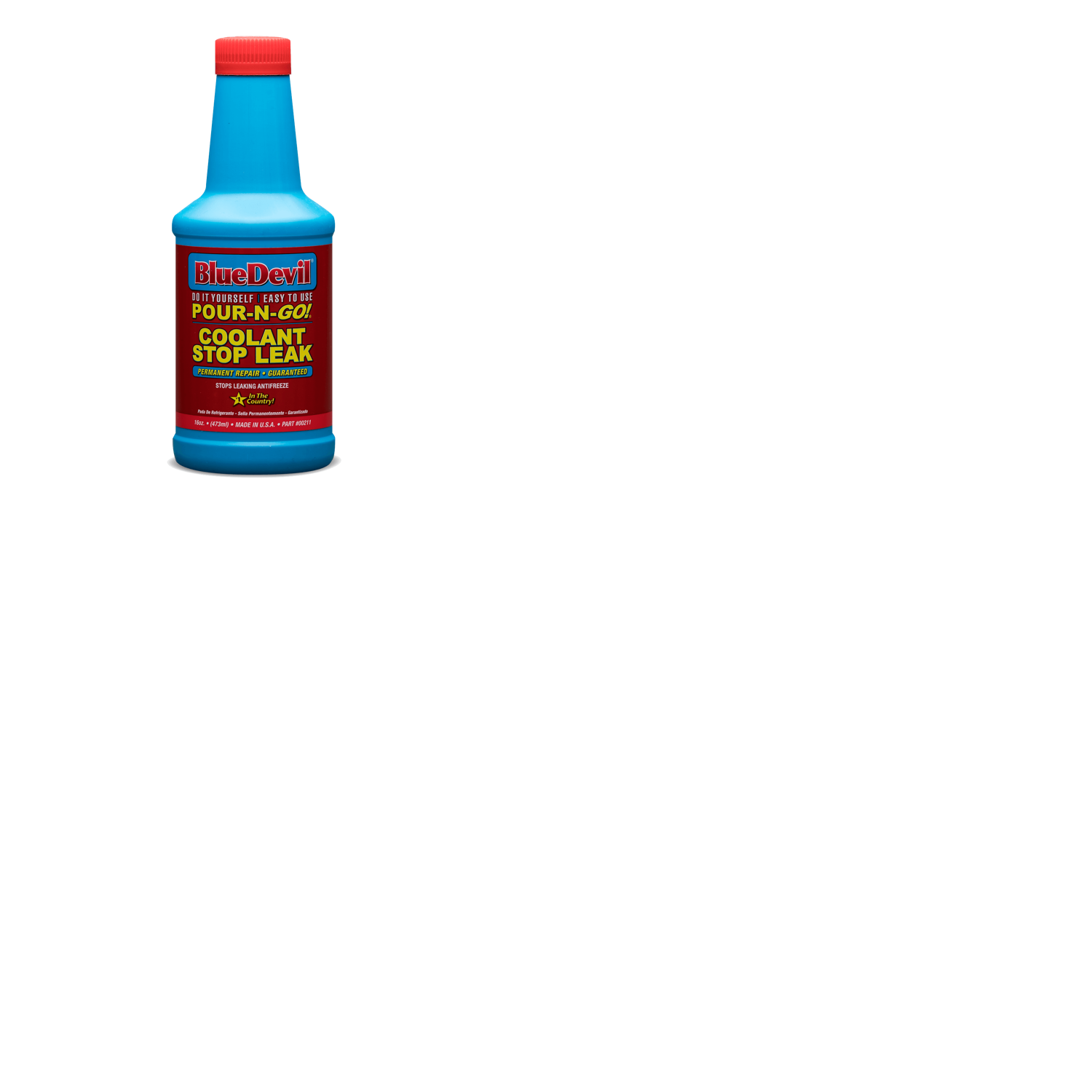

my old regal used to eat a qt or so every week. dumped blue devil in the rad and it stopped eating it. i also never found a leak, later blew the engine up, pulled the heads to see if it was a hg and they looked good. so real mystery. but the BD stopped it from disappearing.

I was thinking of putting something in it just to see what happens, not sure what's tried and true so much snake oil out there.

i can attest to the blue devil working. its thin clear liquid, no tar pellets to clog stuff up or leave a slime behind.
only thing is, if you flush your coolant you need to add more or the old missing coolant act starts up again.
33,325
51,787
Never heard of Blue Devil...where did you hear about it @Scottydoggs ?
It's good stuff, not cheap tho. They sell it in parts stores around here.
I even found it on Walmart's site.
https://www.walmart.com/ip/Blue-Dev...pFwJ58OOoYnHeEOcEQCnQxreOyQzbDuxoCzYIQAvD_BwE

its sold all over the place. all i can tell ya is it works, unlike all other snake oil bs tar pellets junk.
