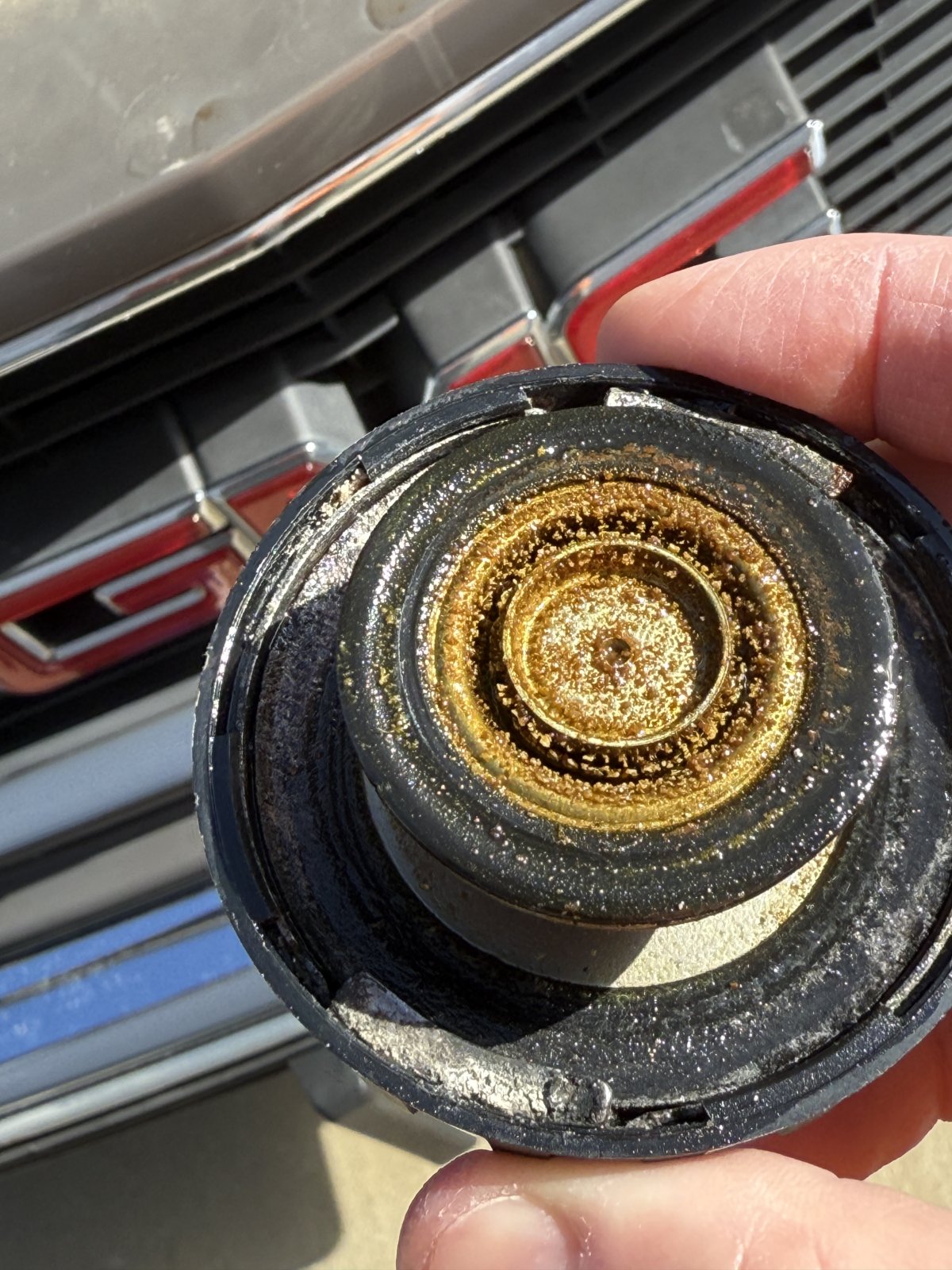

Also there is this weird stuff on the cap? What is this from?

Maybe the cap was a problem with all that trash on the gasket, I put a new cap on yesterday. Metal not plastic. So I'll keep an eye on it while it figure out for a flush. Should flushes be done on a incline so as air doesnt get stuck in places?
