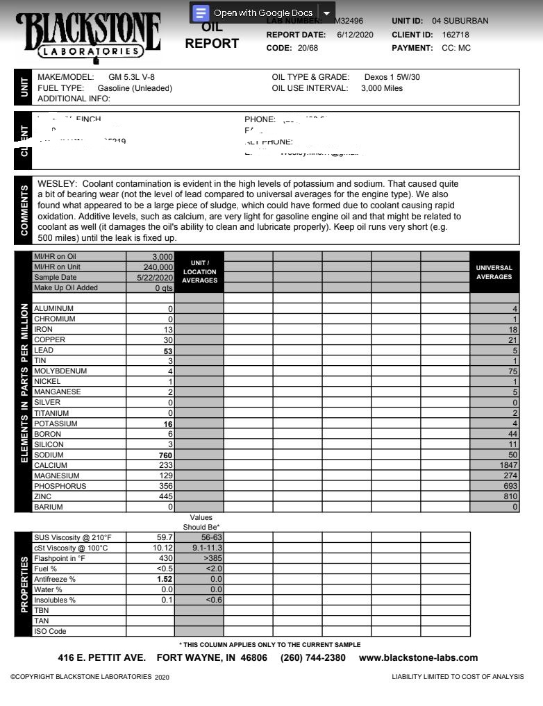

Any update from Blackstone?
just took the sample yesterday, sending it out today. it's weird the oil looks fine it's not leaking coolant that I can see on the ground anywhere, if it's burning the coolant off enough to not make a milk shake I don't know I might just sell it cheap and buy another one it works fine does need a couple little things I need to pull the airbag module out and have that reprogrammed and I think it needs a brake flush I'm getting a random "service brake system" that is the proportioning valve sensor so a flush may or may not clear that up or just replace the valve. To me it's not worth doing a whole engine rebuild when I can buy a whole truck with lower miles for the same price it would cost me.

I've been looking everyday for another truck I think that may be the route I will go, saw a 07 xl for $5500 yesterday with 180k, but she likes the nbs's so trying to get lucky with another 2wd with 160k or less I think one will show up soon, it's either that or price a set of remaned heads or dump some snake oil in it and see what happens. it's still running just a smidge thirsty.
