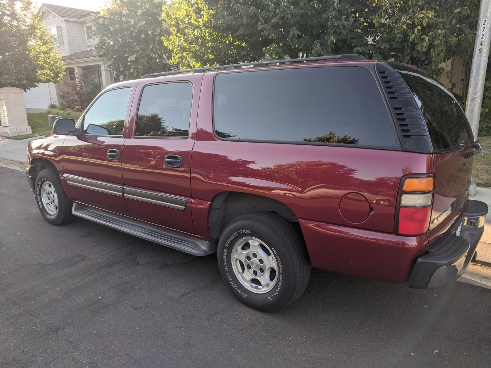

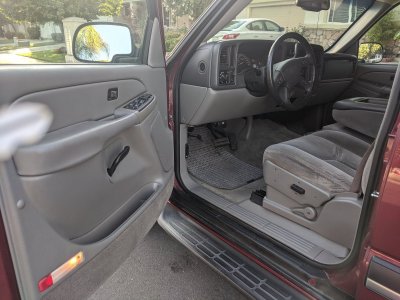

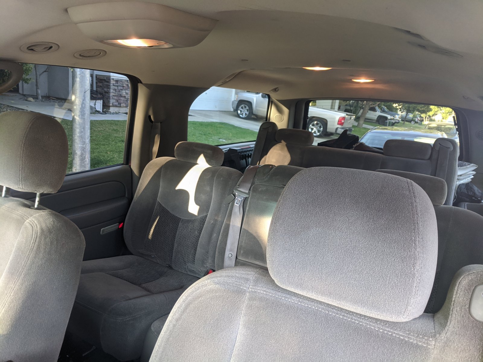

this entire time I have been looking for another suburban, pickings have been slim but Sunday we picked up a 05 with 150k on the clock, clean interior, sport red, L59, 2wd
interior is pretty clean and paint is pretty fair some typical chips on the hood and couple small door dings, engine & transmission seems solid, no major leaks. I have given it a once over couple times since sunday, the AC pump sounded like a jet about to take off so I had that replaced yesterday.
needs minor stuff & a little tlc
one heater hose was replaced because it snapped off which is pretty typical but I am going get new T's and replace the other hose so those will be out of the way
needs wheel bearings which is also typical for the mileage there snug but making noise so they need to be replaced
needs a new coolant reservoir just because it's nasty looking lol so that will get done with the hoses & t's
one of the window washer pumps is cracked and dripping another typical thing should be able to ****** one out of the junkyard
rear hatch & glass gas cylinders need to be replaced another typical thing
needs one tpms sensor-confirmed only needs one
looks like the valve covers have a pretty minor leak on both sides probably typical also so those will get addressed down the road
everything works so far, doesn't smoke or have any weird noises, plugs are autolite and look ok so even though it didn't have any service records it seems to at least have had general maintenance, once I get the hoses and wheel bearings done I can take my time try to fix the 04 or sell it
