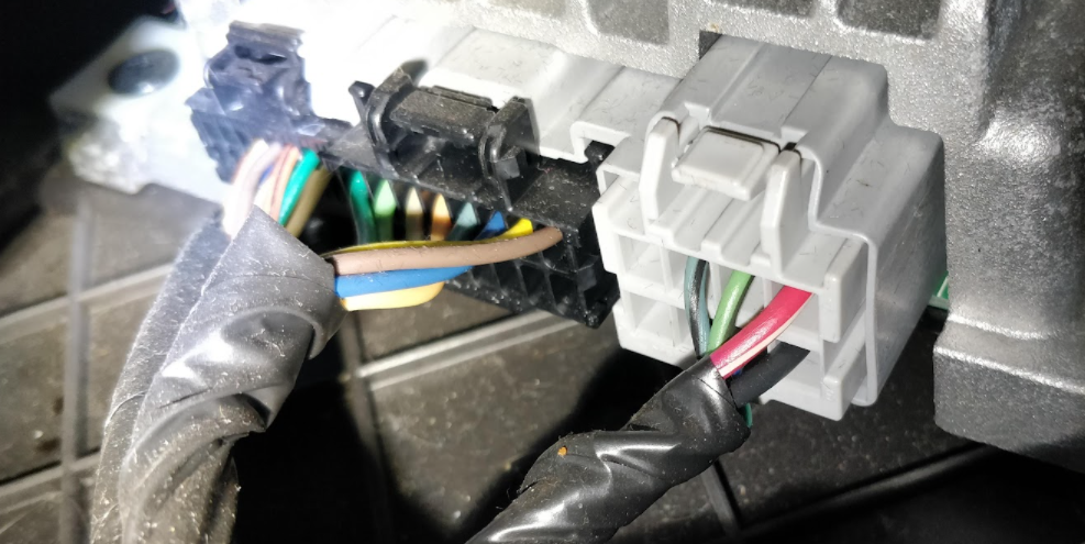

The BOSE amp does in fact have a "turn on" wire. If you look at the amp, the wire will be a pink wire. I'll upload pics to help you out some more. Lmk how you like that radio. I'd love to see pics of it if you have some.

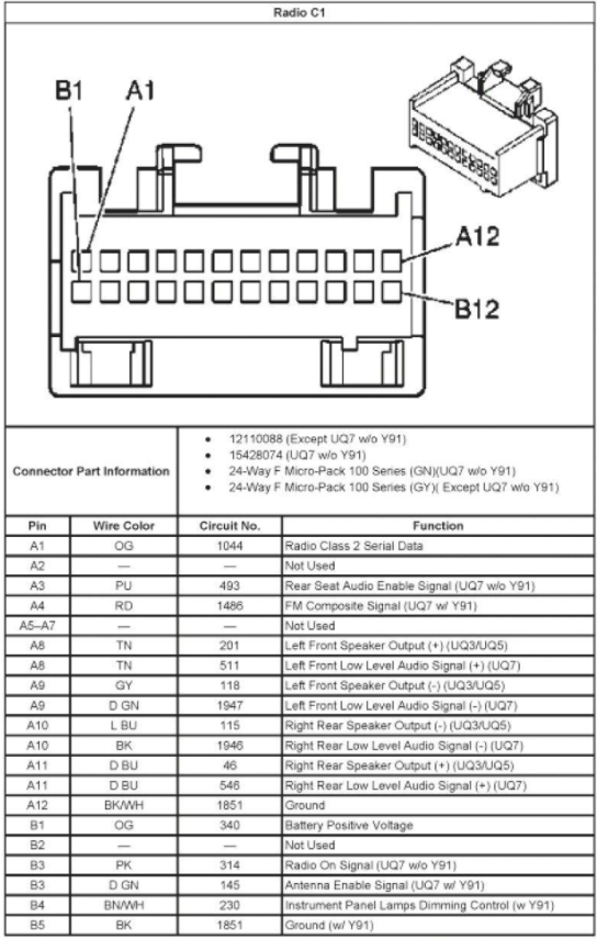

Here is the wiring schematic for the color of wires and what they do.

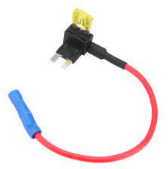

Your best option is probably going to be to tap into a fuse into the fuse box. If you decide to go this route, make sure to tap into a fuse that is big enough, as well is only hot when the vehicle is on.

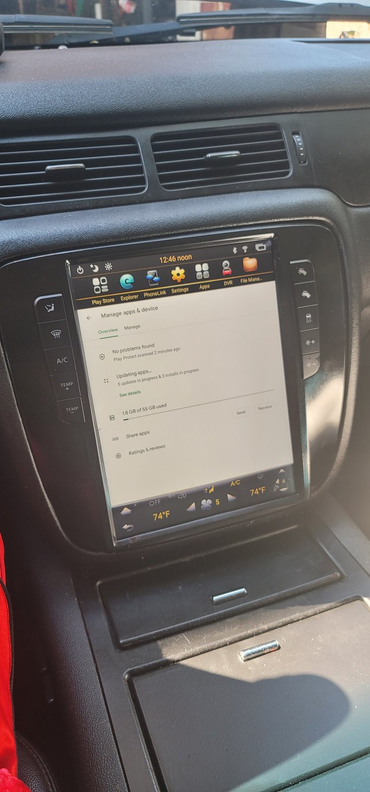

I bought the Phoenix radio and it was all plug and play. I don't have the bose system in my truck so I'm not much help with that unfortunately. Good luck!
