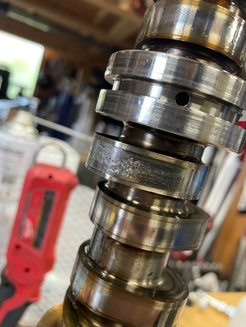

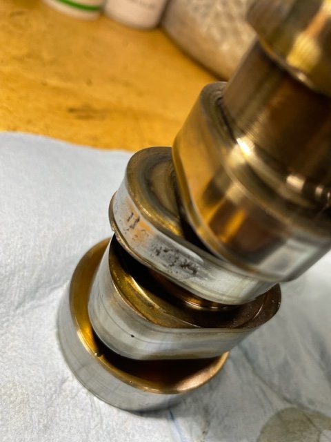

I’ve been very happy with my parts (cam, heads, and various supporting parts) from TSP. Yes, you’ll need a new cam, and to program the ECM. So personally, I’d get a tune, and also springs, retainers, wear parts in the head.

Can this plug stop the lifter from moving?
