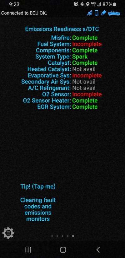

Very informative post on how the dongle disables the AFM.
I'd be curious as to how the Btdieselworks AutoSync does it and if it uses the same process.
I might re-enable AFM in my tune with the Diablo intune i3 I use and disable the AFM using the AutoSync on its splitter cable and after about a week of driving checking the readiness monitors with the scan tool plugged into the other port.
Apr 11, 2018
7,124
14,375
St. Louis
I just re-enabled AFM in the tune and also checked the readiness monitors and they're showing as "incomplete", as they should after flashing the tune.
I have the AutoSync set to disable AFM.
Now I just have to drive it for a few days and check the readiness monitors and see if they ever become "ready"

I'm just doing this as an experiment, to see if the Autosync's way of disabling the AFM will allow the readiness monitors to set, or if it keeps them "not ready" like a Range AFM device does.
It doesn't flash the ECM like a tune does, so I'm guessing it just fools the AFM system either into thinking the engine is at load when it's not or like @Kwing said above.
Funny you should say about being careful activating it since it's been off for a while. I set the Autosync AFM to disabled and when drove to get gas I watched the DIC screen to see if it stayed in V8 mode and it DIDN'T, it would switch to V4!!
I then set the Autosync AFM to enabled and it stayed in V8 mode. I posted on the Autosync forum asking about this seeming backwards and they assured me that's the way it's set....

It's only been 2 days and while some of my readiness tests are complete, 3 still are not. It looks as though the AutoSync doesn't fool the ECU like the Range device does as described earlier.
I'll keep checking the readiness monitors after each drive cycle though, but I'm flying out of town on Friday and won't be back until Wednesday.
