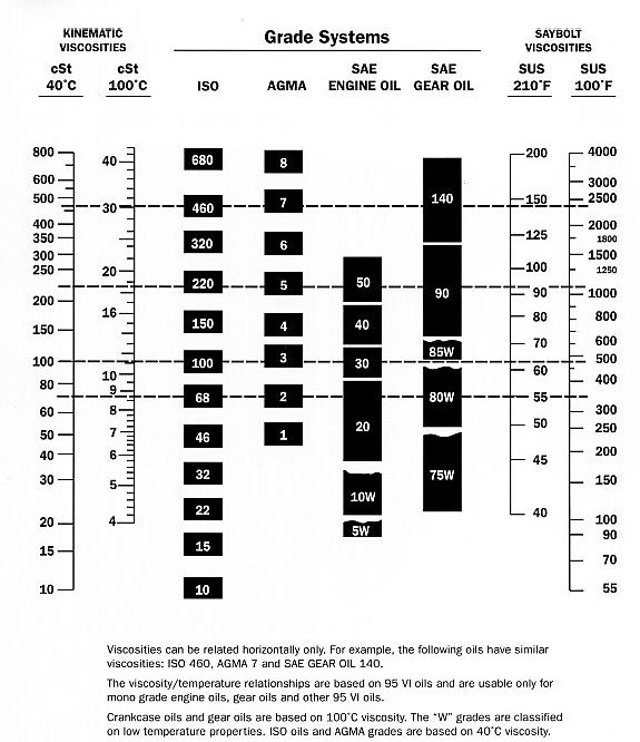

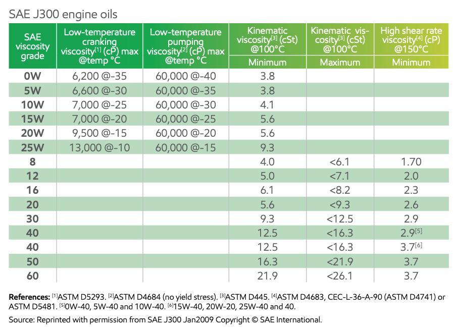

The reason the Pontiac had such large clearance was because of the "large" width and diameter dimension of its bearings and thus journals. Poor design, and Pontiac wasn't the only one. All machinists know this. Built my first Pontiac 400 Ram Air III out of my 69 GTO in 1976. The LS engine has smaller dimensions and thus tighter clearances. No machinist/engine builder I know would ever build a 5.3 or 6.2 with less than .0025" clearance.
I've run 0-20 viscosity oil in our 07 Denali 6.2 for two oil change intervals, when the engine had 183k miles to 195k miles without any ill effects. I've also run 5-40, 5-30 10-30, and 0-40, all with good results. I would run a 50w oil in any of my vehicles without worry. Until about 2010 I ran Valvoline VR1 20-50 in anything I owned without issue.
Oil back in the 70s and earlier was sewage compared to today's oils.
Government corporate average fuel economy (C.A.F.E.) regulations and $fines$ have forced engine designers and auto makers to recommend thinner oils than they would otherwise. The same engines/vehicles sold in other countries without CAFE usually recommend thicker oil. The latest boondoggle engine designers and auto makers have forced upon us because of regulation is direct injection. Oil manufactures/blenders have been forced to come up with new oil specs to try to counter the enegative effects of direct injection. Many new car engines run 0-8 and 0-16 viscosity engine oil.
All of todays engine oils are blended to meet SAE spec and do a lot of ASTM testing. See the charts below to see velocity results at 40c (104f), 100c (212f), and 150c (302f).
They show how greatly oil thins with heat.
and

Good detail! Don't even get me started on Direct injection! Just read all the posts on here from the new Tahoe/Denali/Sierra owners with seized or destroyed new engines. Ford having similar issues on their Direct Injected engines too. Very happy to keep driving our '13 Tahoe. Kevin
