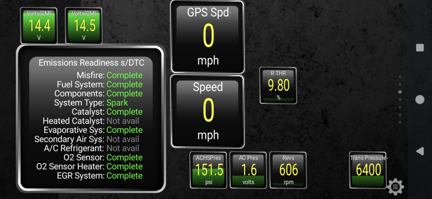

did you check which monitors weren't set? and if they said fail or unavailable?
they will look something like this. it might help work out what the limits are.
mine finally set the evap.. I sware it's been months since I changed it

sounds like 2 not ready was to much. from what I've seen on mine, o2 is one of the first to pass after a reset. evap always last by far. I don't believe o2 could be not ready but evap was. makes me think they weight some over the other.
I'm sure you'll pass soon.
on a side note our trucks don't have egr valves right? I wonder what the egr test is.
