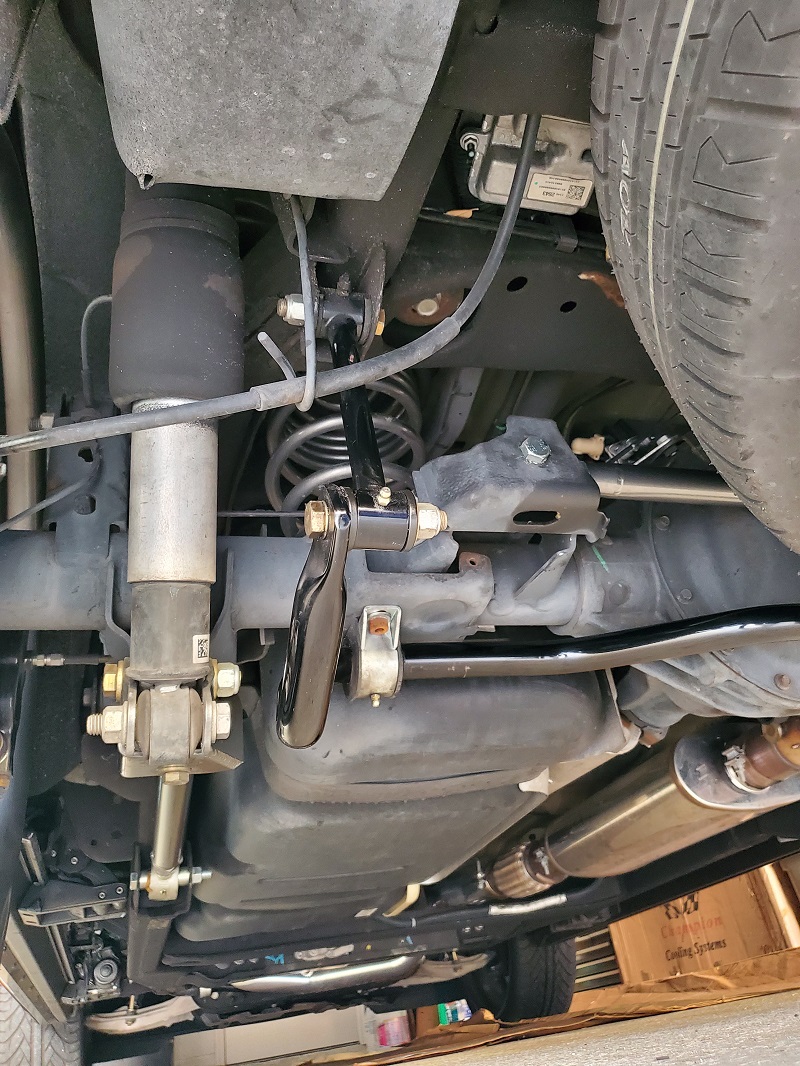

Correct. If you are going to use the stock dif cover. You'll have no issues. I am lowered 1.5 / 4. No issues. Love the panhard bar.
Just realized, I don't have a good shot of the panhard bar. The spare tire needs to go too. just added that to the things to do list.

What sway bar links are those? Are they shorter than stock? I'm trying to find some shorter ones that aren't the DJM offset ones.

They are Hotchkis sway bar end links. They are shorter for the lowered applications

Hellwig makes an adjustable rear end links too; that's what I have.
