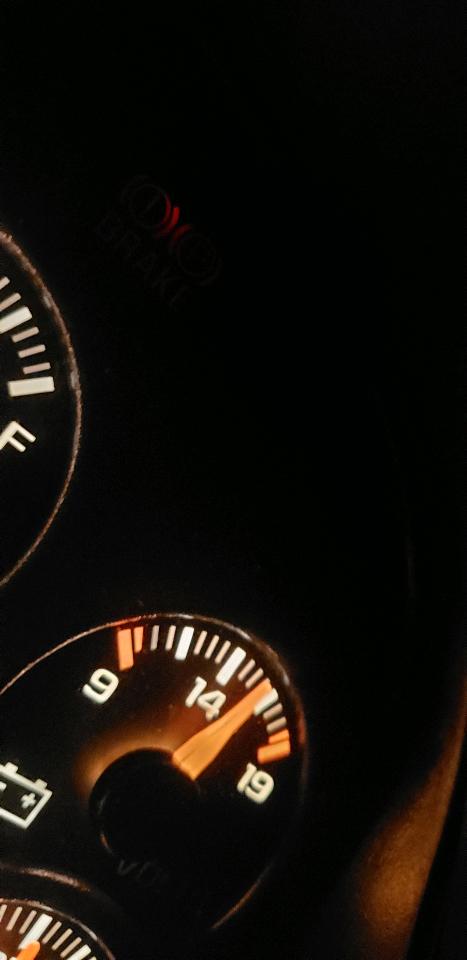

I love my truck. There are very few issues with it. Previous owner took extremely good care of it. However... I had a hunch when buying it that something electrically was being covered up.
Sometimes...ABS works, then randomly itll just decide not to work. Odd thing was there's never any light on the cluster. No orange ABS light, no red Brake light, not even during the bulb check when u start the car.
Upon looking further, someone has sharpied out the red Brake light as u can see from the pic just barely.
I'm wondering what the problem could be. Ill have to get codes pulled and let you guys know what I find.
Hopefully nothing major 519ee0751d606f48d2c3caacba98f8bf.jpgf6ae2ced99bbe6e06dd5b3e2ce170e54.jpge3ea4a3cb91bc14a731237b3badddb74.jpg

If I was a betting man, you have a good chance of finding a front speed sensor harness with a broken wire that gets flexed when you turn or articulate your suspension causing intermittent issues.
Will stand by to see what you find out.

generally these are the only reasons I can think of that would make the brake light come on and not the abs light
1. brake fluid is low
2. brake fluid sensor is bad
3. proportioning valve is stuck
4. parking brake is on
5. parking brake sensor is bad
6. possibly a faulty brake light/pedal switch but not sure
7. problem in the instrument cluster it's self?
any other scenario then the abs light would be on at the same time
try unplugging the brake fluid sensor and see if the light goes out

pretty sure that would just cause a abs light and not cause the brake light to be on constant. unless i am reading this wrong it sounds like the brake light is on constant?

Ok well...there are 2 issues here tho.
The ABS light on the left of the dash never comes on either. So idk if the bulb is taken out or what.
So i have no easy way of telling which faults are on unless i get everything scanned
