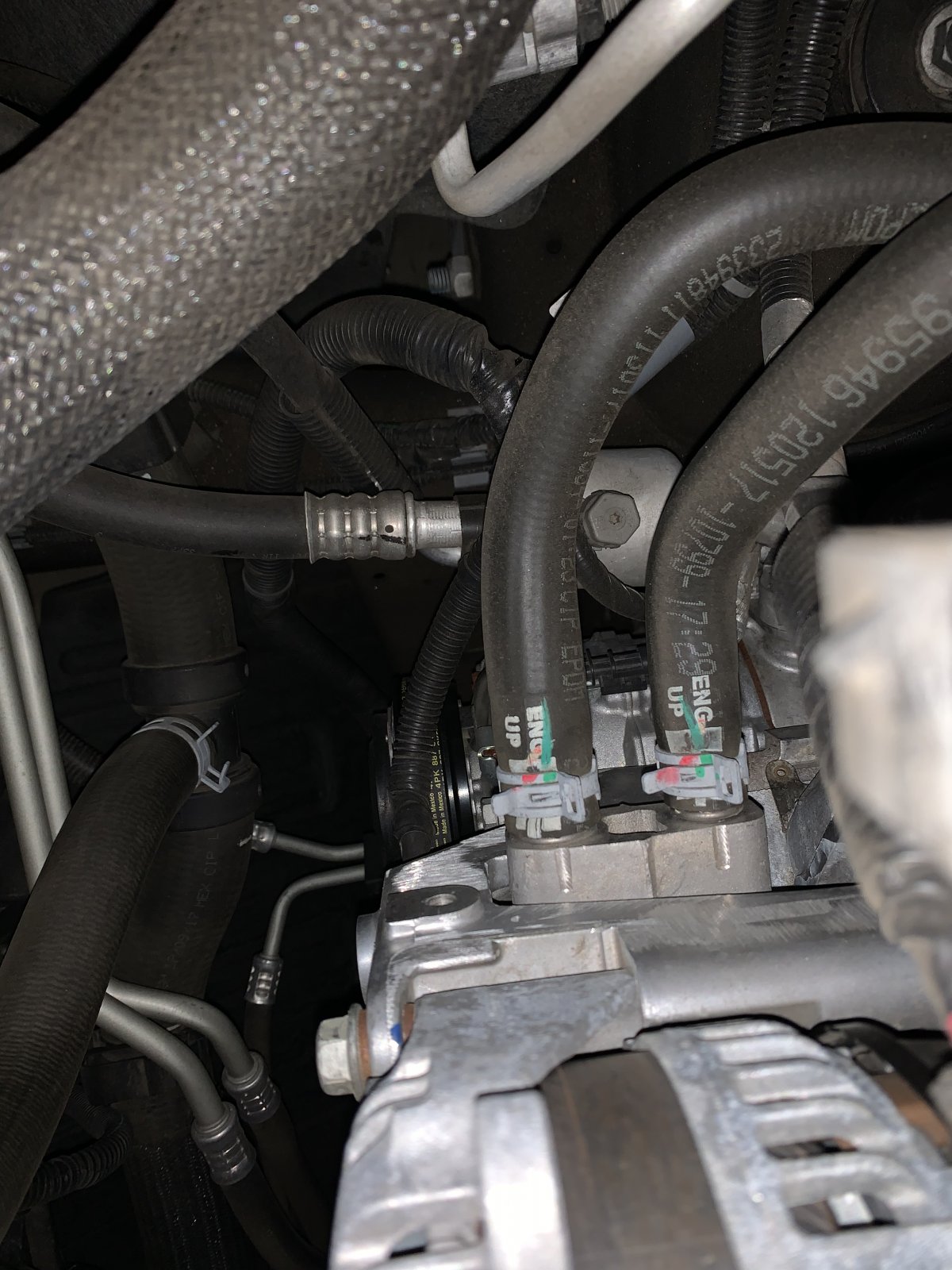

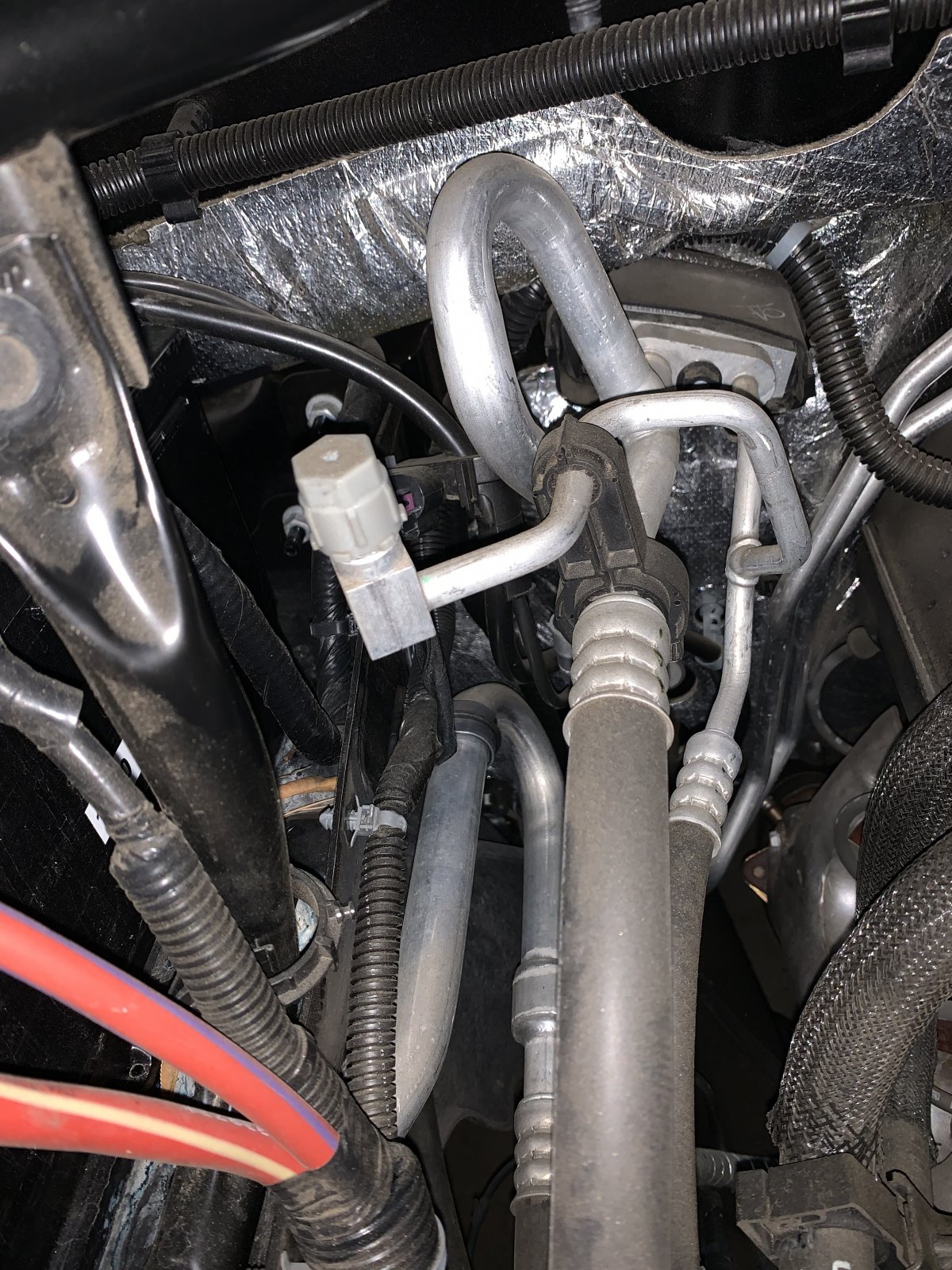

Grabbed a can of A/C pro with the digital gauge
Popped open the hood and the only ports I can find are these: see attached images
It doesn't seem like the hose from the can clicks on to the one close to the firewall
So tried both ports you see in photos and it isn't it
I need to find the low side
When I researched videos and images on YouTube, Google.
None of the vehicles is the same as my A/C Piping. You would think this would be simple.
If someone has the same year model or has done it B4 plz let me know where it is ?

Most likely because you have R-1234YF in your vehicle not R-134a. Check the sticker on the bottom of your hood for which AC refrigerant is in your vehicle. Ports are different for each refrigerant type.

Looked again, the bottom fitting is on the suction hose. Service valve looks like the top one.

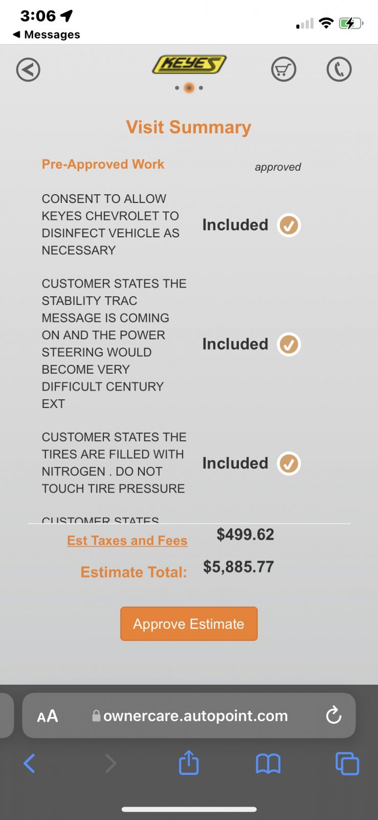

Finally the estimate is done on my truck
Looks like there are a few issues:
Inspector has to look at it b4 they can repair also one part is on back order
