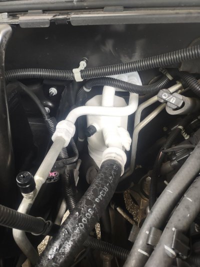

After driving my 2011 Tahoe in Ga heat for about 15-30 minutes I noticed the A/C is not blowing at it's nornal rate with cool air. The fan is working from low -Hi as it should, but the cool air is not excaping the vents, although you can here it attempting to push thru. Also I noticed air is notflowing from the rear overhead vents as well. First I thought it may be low on freon because it had never been recharged, so i had the system pull down and recharged but i'm still having the same issue.
When this happens, I noticed the evaporator is iced up (see attached photos) and if I allow it to thaw, the A/C operates as normal until it ices up again. Have anyone experienced this problem on their chevys and if so what was the root cause.

Sorry i think the unit in the photo is called the accumulator, and once it thawed out, the air blows normal again from all vents. Could this issue be caused by a bad Evaporator temperature sensor located under the dash behind the glove box?
thanks
JCS
I think that’s extremely likely to be your problem… The evaporator temperature sensor. Kind of a ***** to get to, and not usually very trouble prone, so it could also be a wiring issue.

yeah, it's freezing up inside. when it happens, push the ac button, the little * one and it should thaw pretty quickly. you'll have to manually cycle the compressor till you figure out why it's not doing it on its own.
leaving it on non recirculating helps

Thanks members for responding. I'm going to go by the GM dealer and pick up a temp sensor just in case I need to replace i when I go by the shop to recheck the freon level.

Update: Repaired
I replaced the Evap A/C Temp sensor and my A/C blows nice and cold in this GA 98 degree weather and I have not had any freezing up of the accumulator since replacing the sensor.
