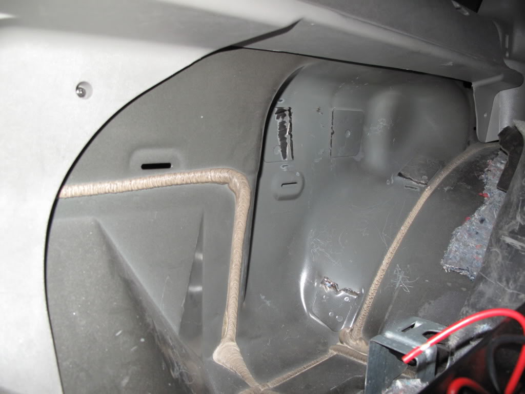

Can anyone guess what may go in here? (i cut and grinded the heck out of it...came out pretty clean IMO)

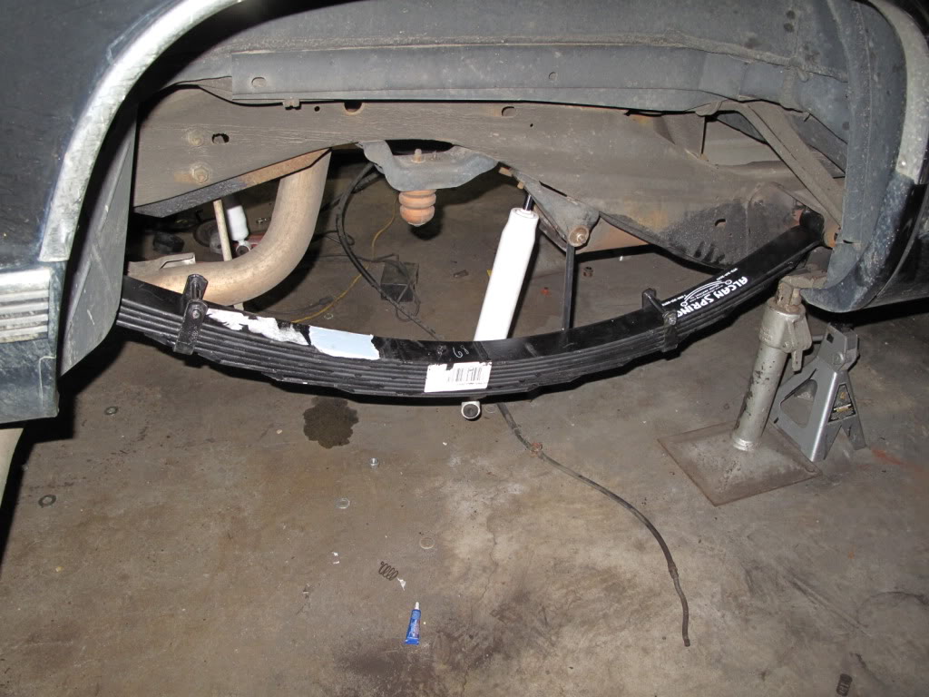

On to the venerable 14 bolt and Alcan springs.
If you are going to replace your springs, plan on dropping your tank. I decided in my infinite wisdom that if I cut all the old bolts, it would piece of cake...wrong!
There is one bolt that butts up against the gas tank that once you cut the head off, it falls in between the frame and gas tank. The head of the bolt is bigger then the opening in the frame, so you can't simply grab a magnet and pull it out...also, these are grade 8 bolts, so unless you want to spend hours with a Sawzall, grab a grinder and go to town

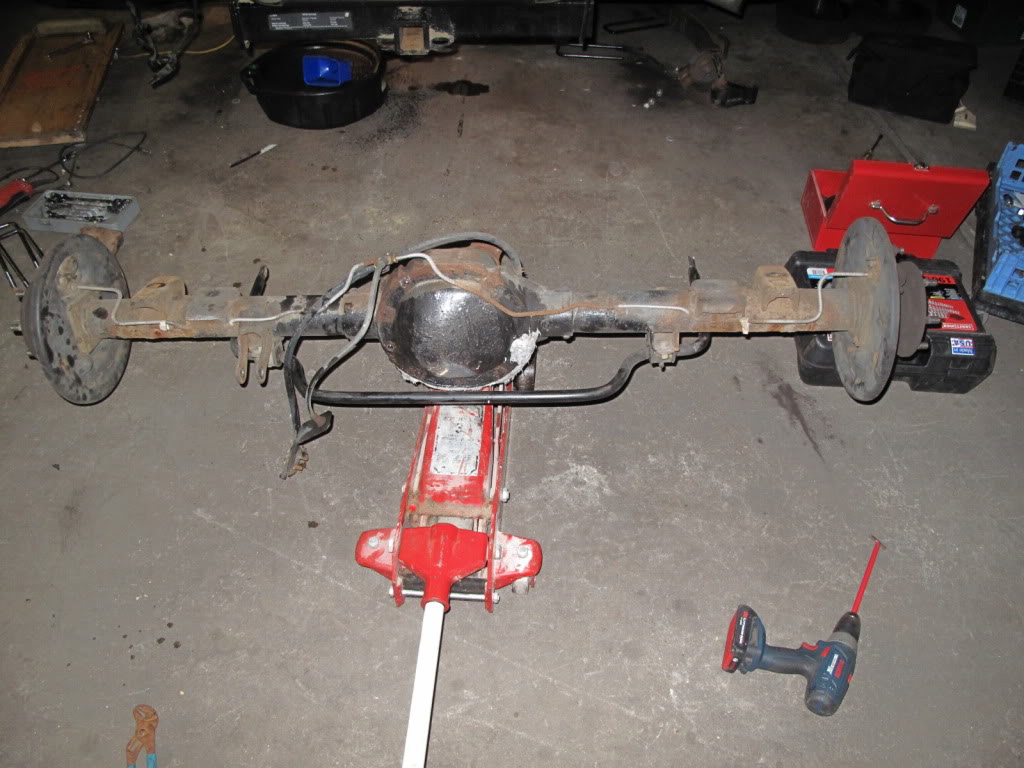

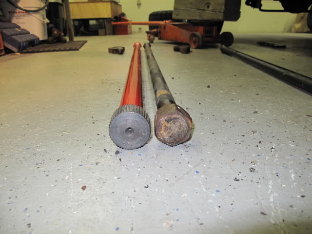

- 10bolt stripped and ready to come out
- got it out nice and easy! I had new ubolts, so this part was actually pretty simple

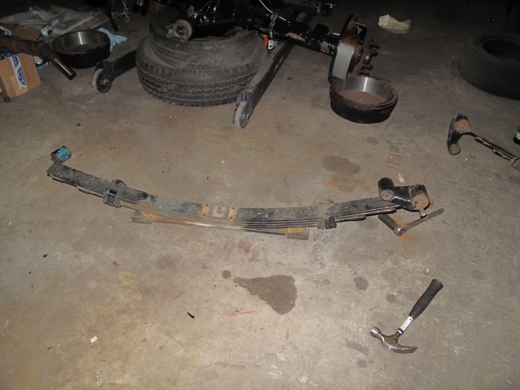

This is where it gets painful...spring removal...it took me over a day to get these out b/c I didn't drop the tank and had to run to home depot twice for bigger cutting blades
- i did this at about 11p when I saw it was going to take hours of squirming to cut the bolt
New springs in - really easy - I installed with the head of bolt facing out

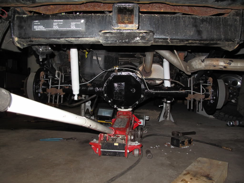

14 bolt in - POR'd it and with that ridiculous thick BlueFab diff cover, this thing is beefy
The RCX shocks are in the rear (white in the photo) as I wait for a bracket for my rear 5150's...sadly, the front 5150's are no valved heavy enough for this truck, so i'm ordering 5100's tonight
The driveshaft is also in, tomorrow is some buttoning up and then I go to pick up my new rear bumper!
In mine it's going to be a metal box that folds out to reveal a ham radio and 110w power inverter. Nice to know the jack mount comes out so clean.

The venerable 14bolt is in and so far so good!! I only ran the truck on jack stands, but tomorrow it's road tested.
The 14bsf mod is a piece of cake if you are retaining the stock springs...but i definitely was slowed down by mine.
This thing looks awesome under the truck! I POR'd it (dont mind the spots i missed) and it looks really clean under the truck.
I also painted the drums and any visible rust on the frame... (this photo was taken before I touched up all the rust)

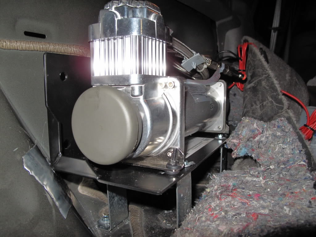

This mod I'm actually pretty excited about and recommend to folks that if they wheel, copy this!
This is my 100% Cycle Duty VIAIR 450H. If you want to run a tank, they make a pump with an auto shutoff...the "H" is not designed for use with tanks, but with a little ingenuity, it easily could.
We essentially purchased two brackets from Home Depot and with self taping screws, drilled into the body. To reduce vibration when this thing is on, rubber sealing material (roofers use it - see the shiny material on the fender), was placed on parts that have metal to metal contact. You will also see there are rubber grommets on the screws that mount the pump to the black mounting plate.
I also purchased the mounting bracket specifically for this pump and it made installation a piece of cake. You can tug on the pump and it doesn't budge.
From a wiring perspective, this will be wired directly to a relayed switch in our center console. The air line will run from the pump to a quick disconnect that will be mounted on the custom rear bumper.
Also, b/c this rig will go through water, I siliconed the heck out of the parts of the screws that went through the metal interior to the outside.

oba looks bad ass. i took my jack out as well and just throw extra stuff in there. are you planning on putting thr cover piece back on? i never thought of putting it there will be stealing this idea for sure and had same thought of bumper fill valve. may put a tank where the spare tire used to be
Yes, the cover fits over it perfectly when i first measured before mounting...getting back under the truck on Monday and will test it out now its mounted for good.
We're not mounting a tank before the trip, but when i get back and have extra time, the air tank is going where the spare used to be - def do it and take some photos!!

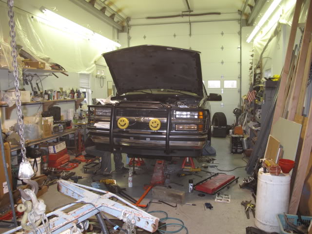

Here's where we did the install...I got really lucky that someone in my family has a commercial garage attached to their house

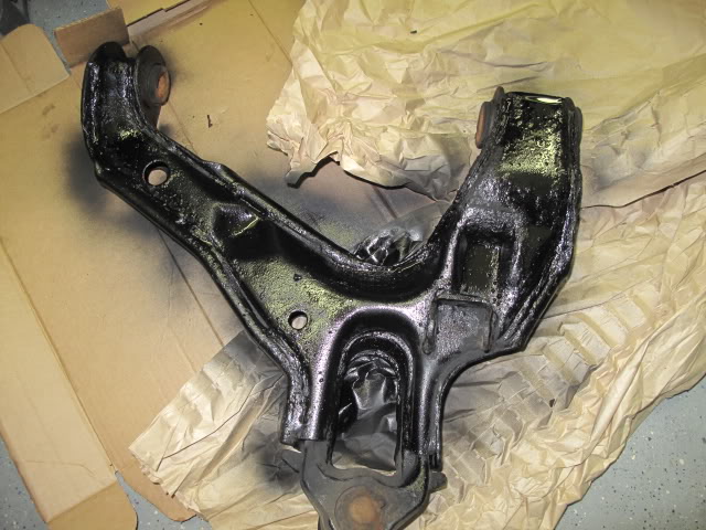

Keep a rattle can available and you can make most of your old rusty parts look pretty new; I also painted the frame and IMO, it looks great
