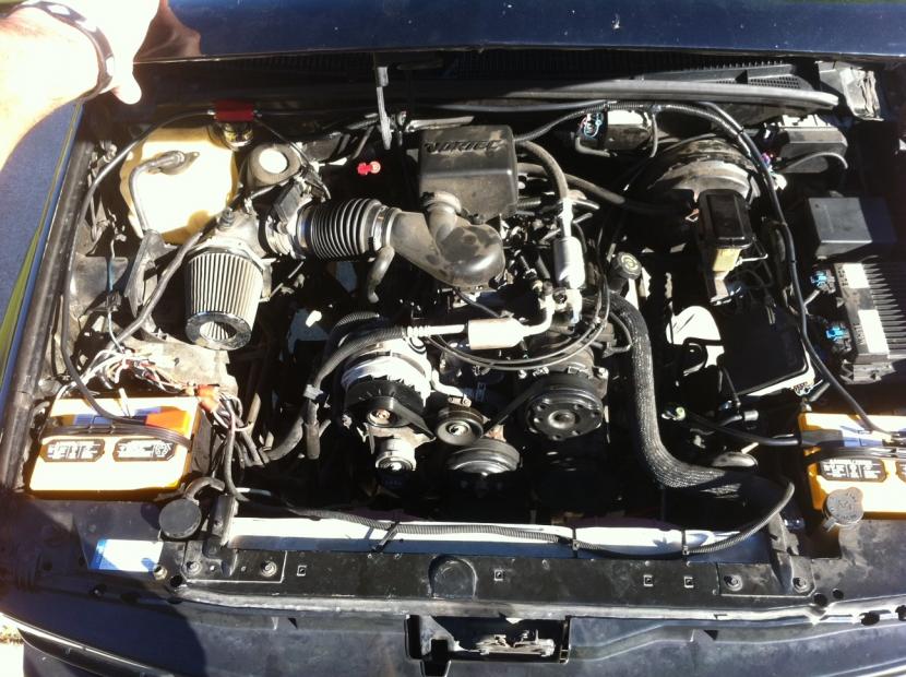

i would just do both, probably cost you about $500. There are some threads on here with some how to's on each, i just did mine on this forum "dual battery setup"
