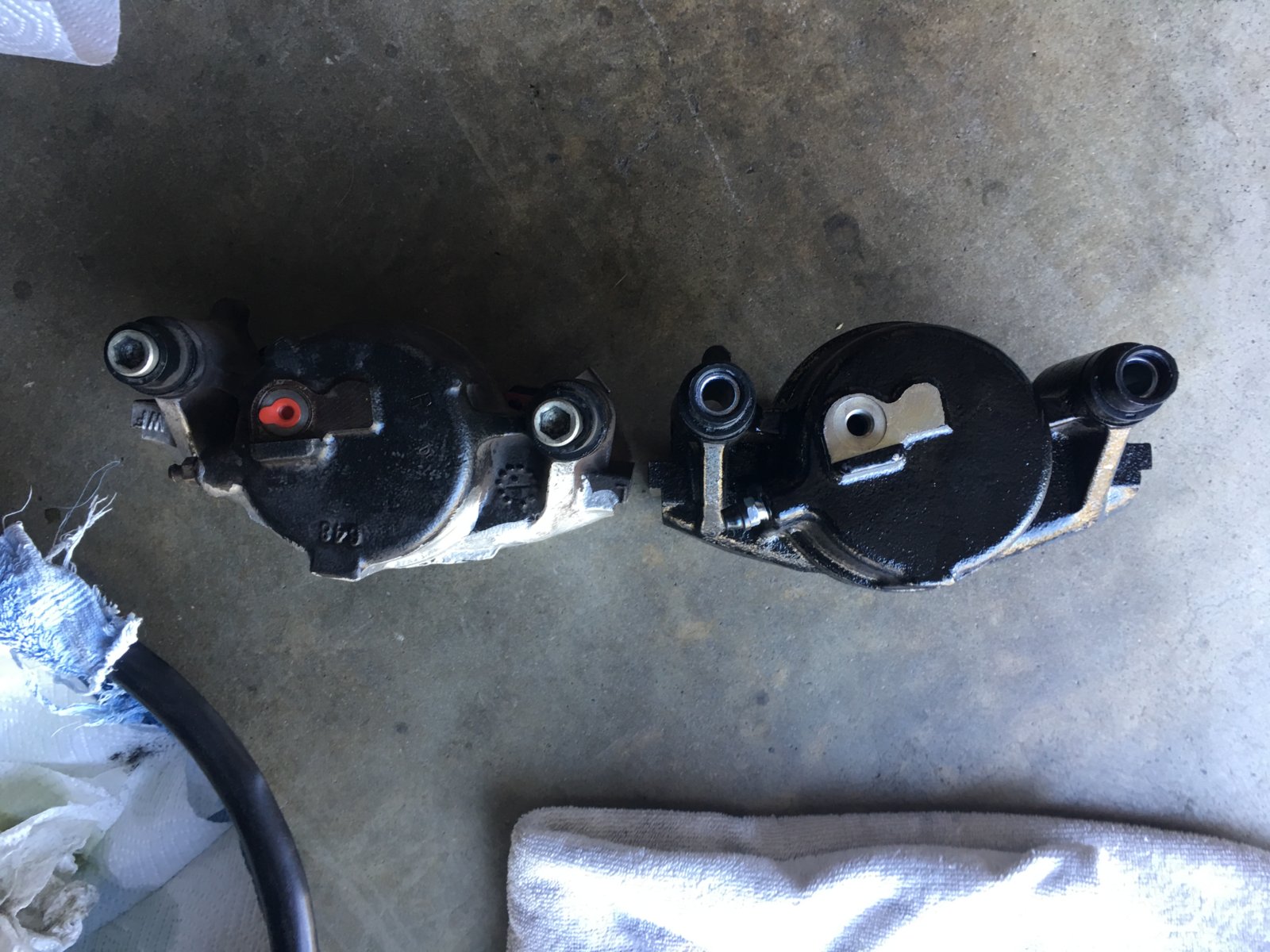

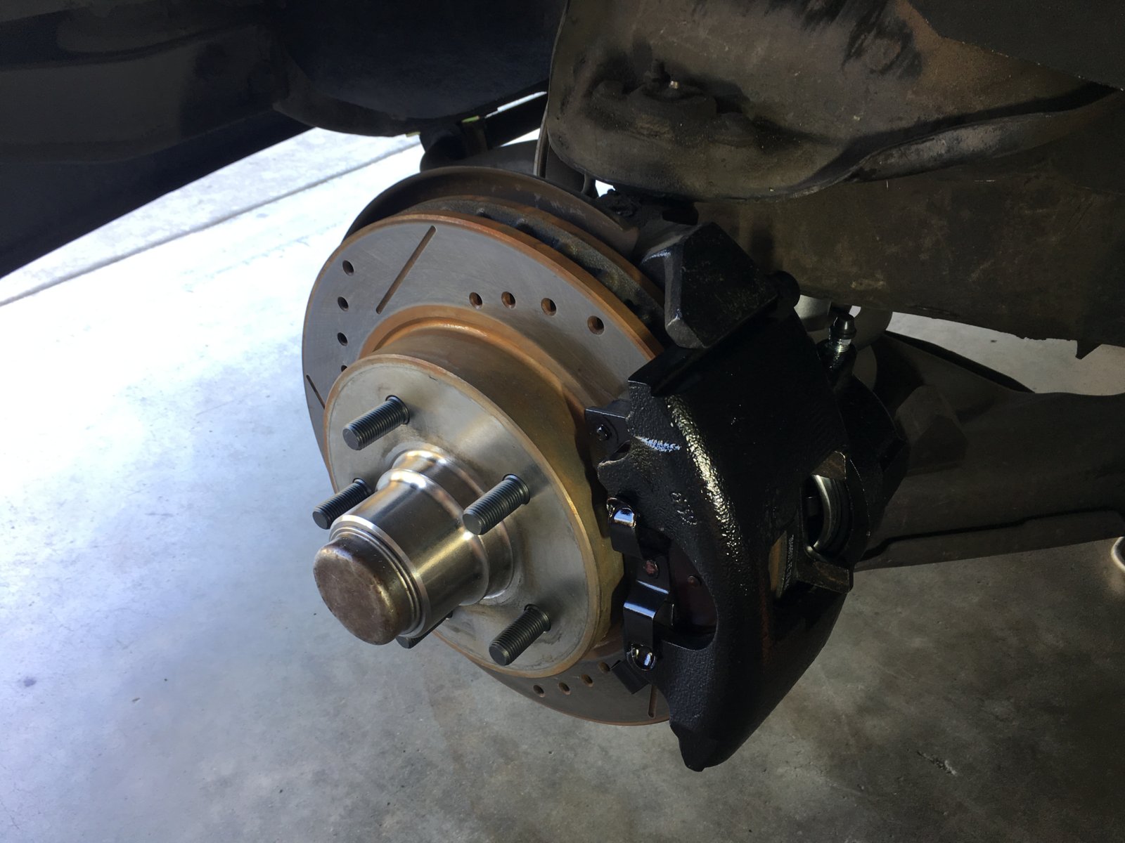

I put the larger Front Calipers on as well. These are from a 2500 series truck from the same gen as ours. I have a comparison picture of the two calipers. As you can see there is a slight difference in size and the pads are about the same size but maybe just a slight bit bigger. They are a bolt on as well with no mods. Also with the changes I have made to the calipers I now have to use a master cycling from a NBS truck. They have a larger bore for larger caliper on both the front and rear now. I will be installing that today as well. Here are a few shots below.
