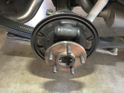

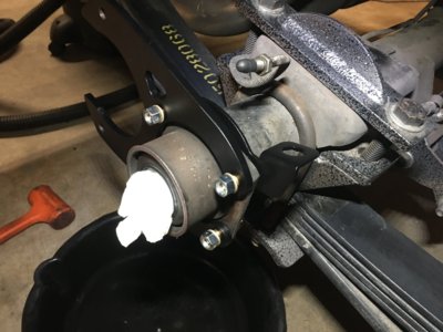

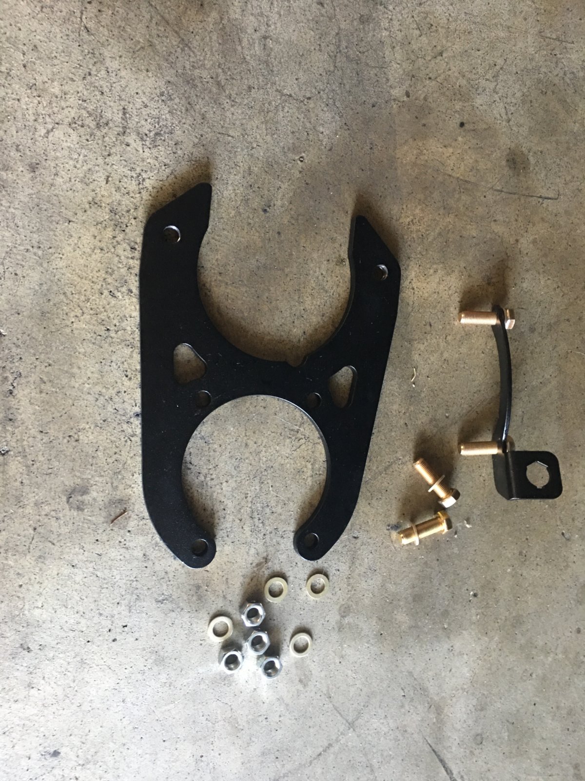

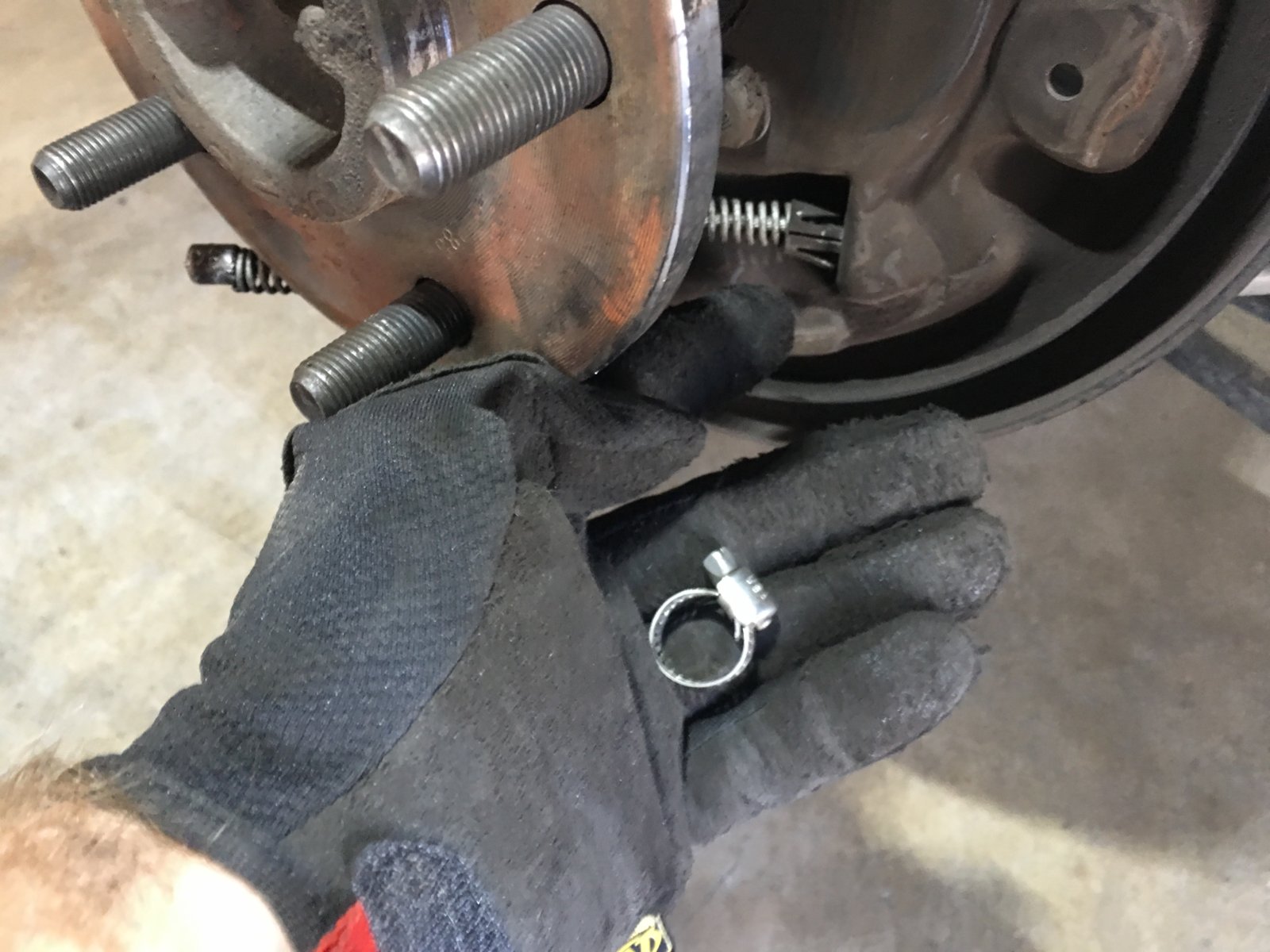

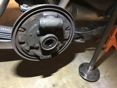

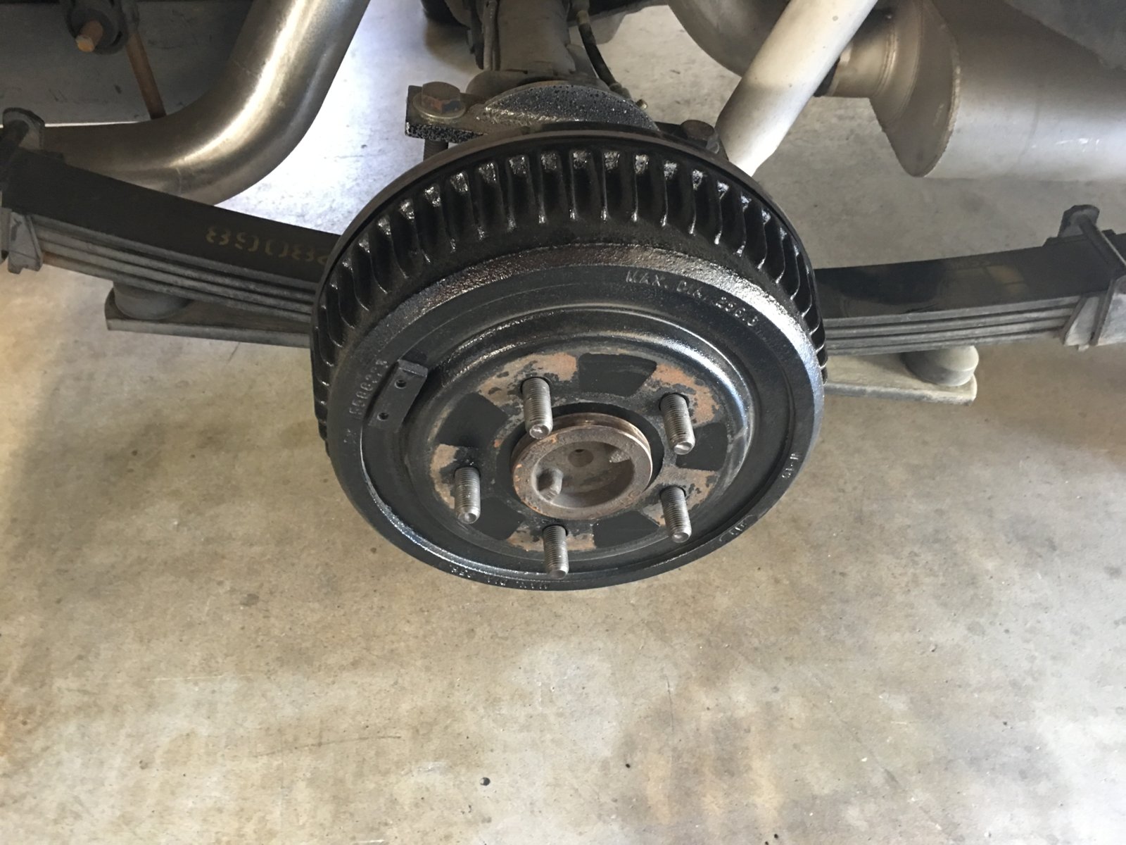

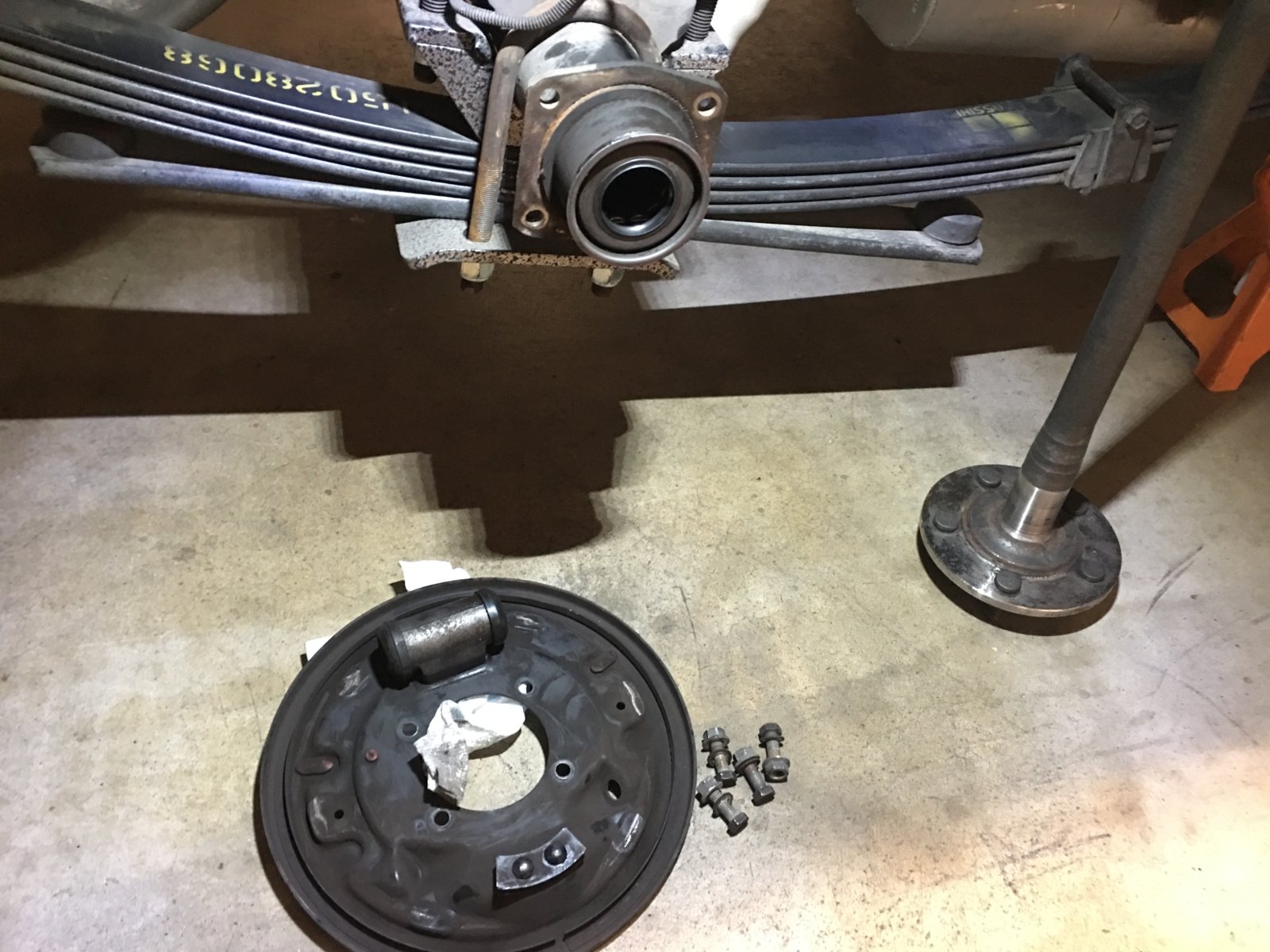

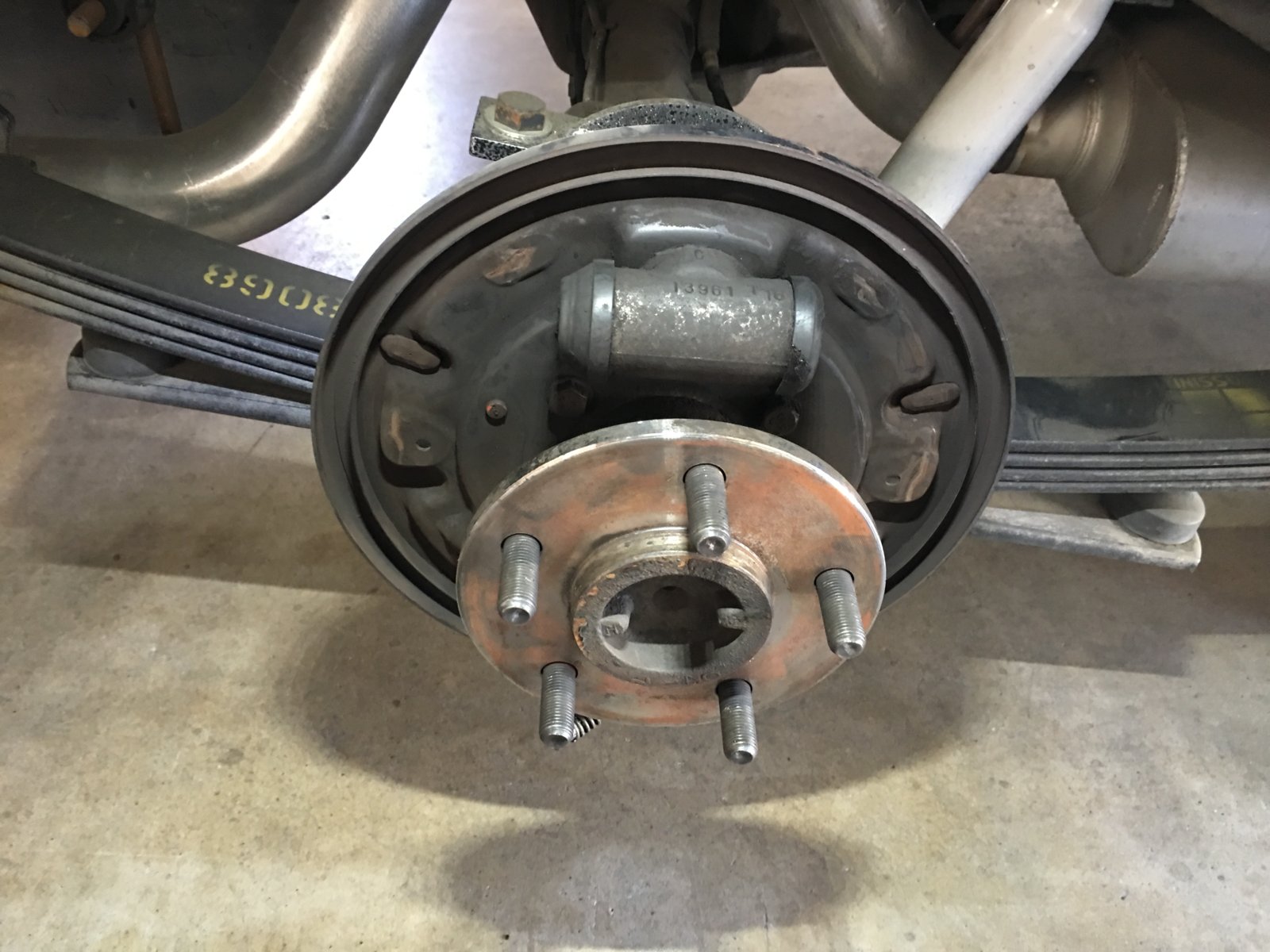

Yes LS has a conversion kit for the 4WD 6 lug, it uses the same calipers, just the caliper mounting plate are different where it mounts to the rear axel and the rotor is 1 in thick. Also sorry for the late reply. Super busy with work. Everything is pretty straight forward on the install. The only real problem that I had was the brake caliper. I got the kit that has the emergency brakes built in, they are the 79 to 84 Cadillac/Eldorado rear calipers. My problem was getting them adjusted properly for the emergency brakes, it was a ***** to do. Now that i did it its not hard at all. I also made new brake line as well and took the axels out instead of cutting the backing plates, this takes longer. I also changed out the rear seals and changed the rear gear fluid as well. Here are few pictures of the install below.

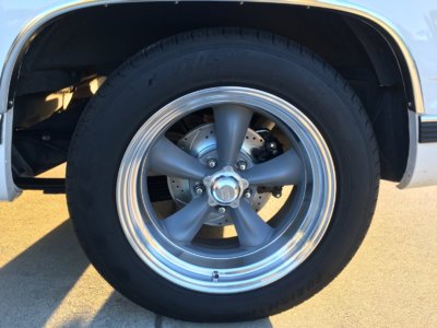

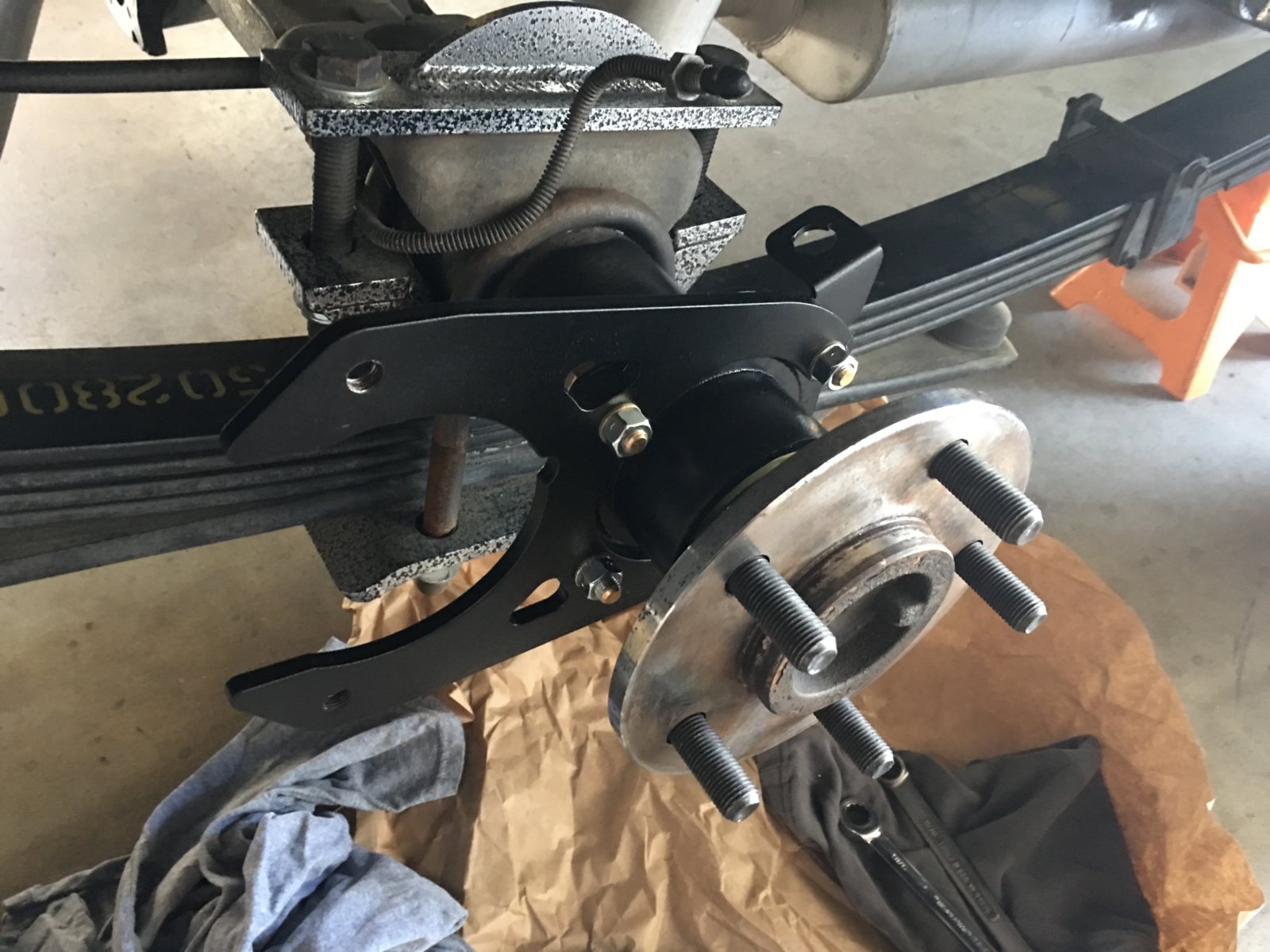

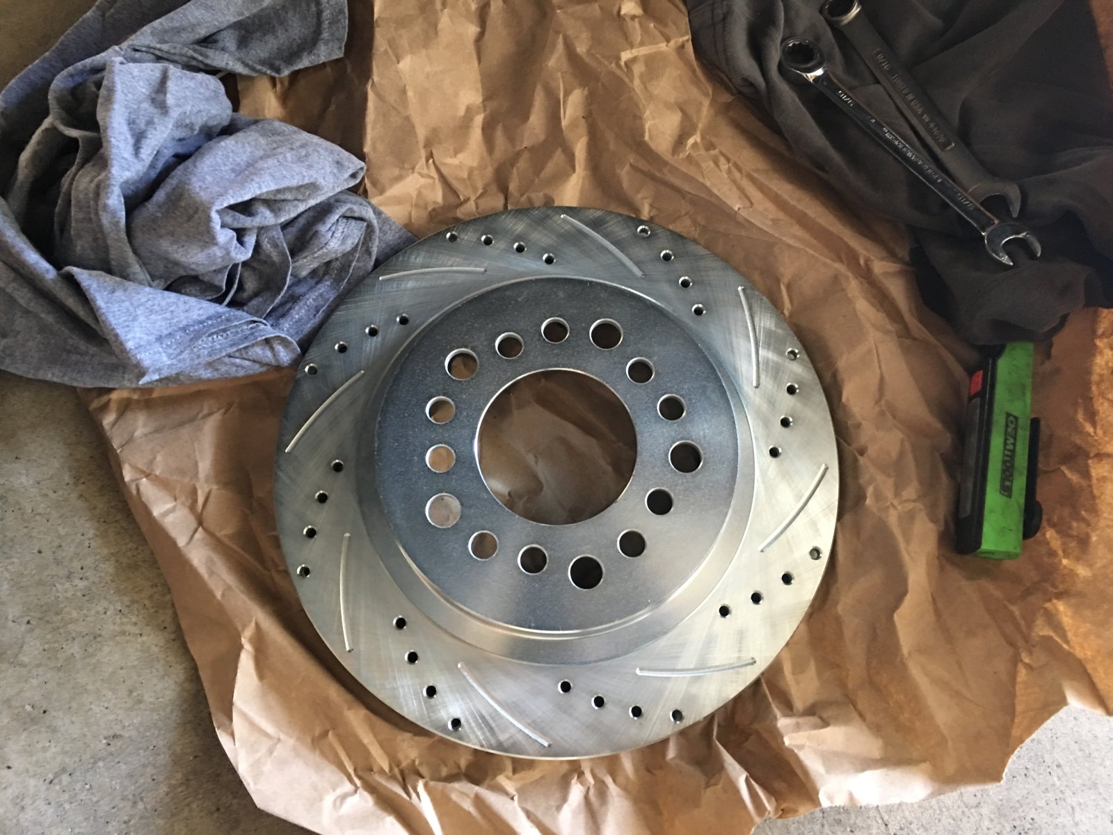

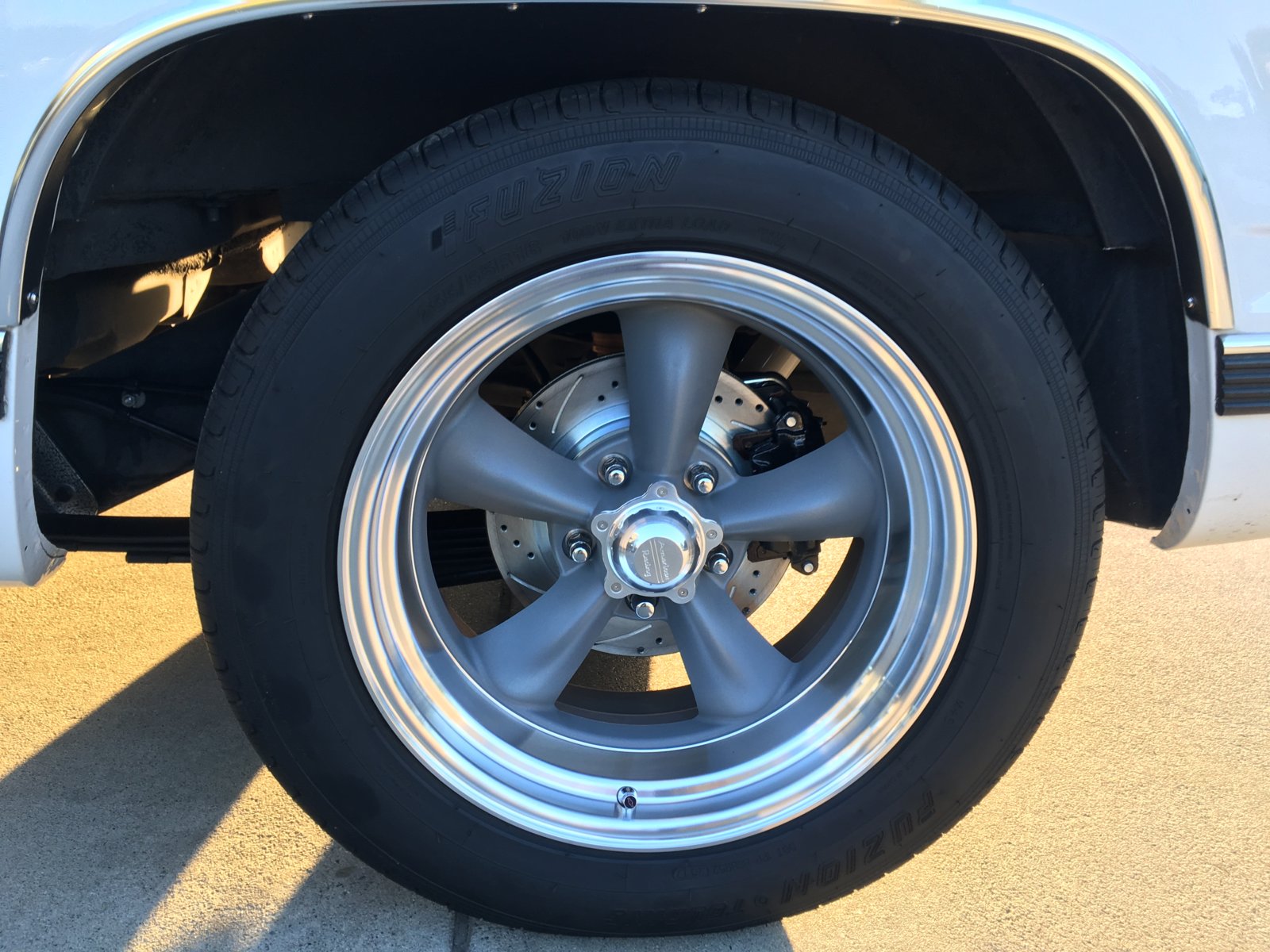

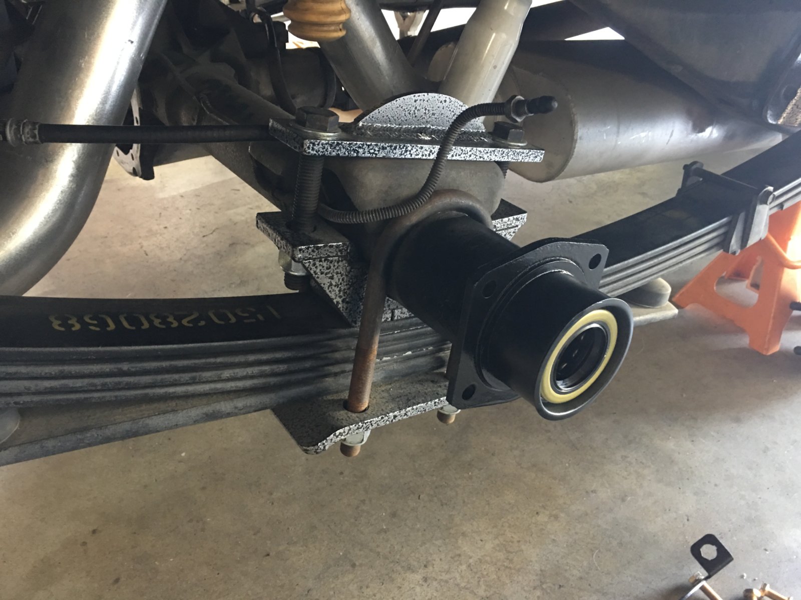

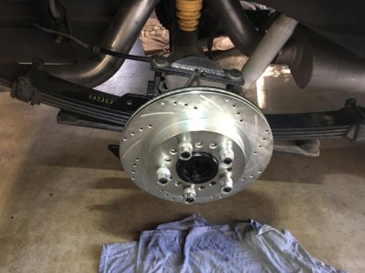

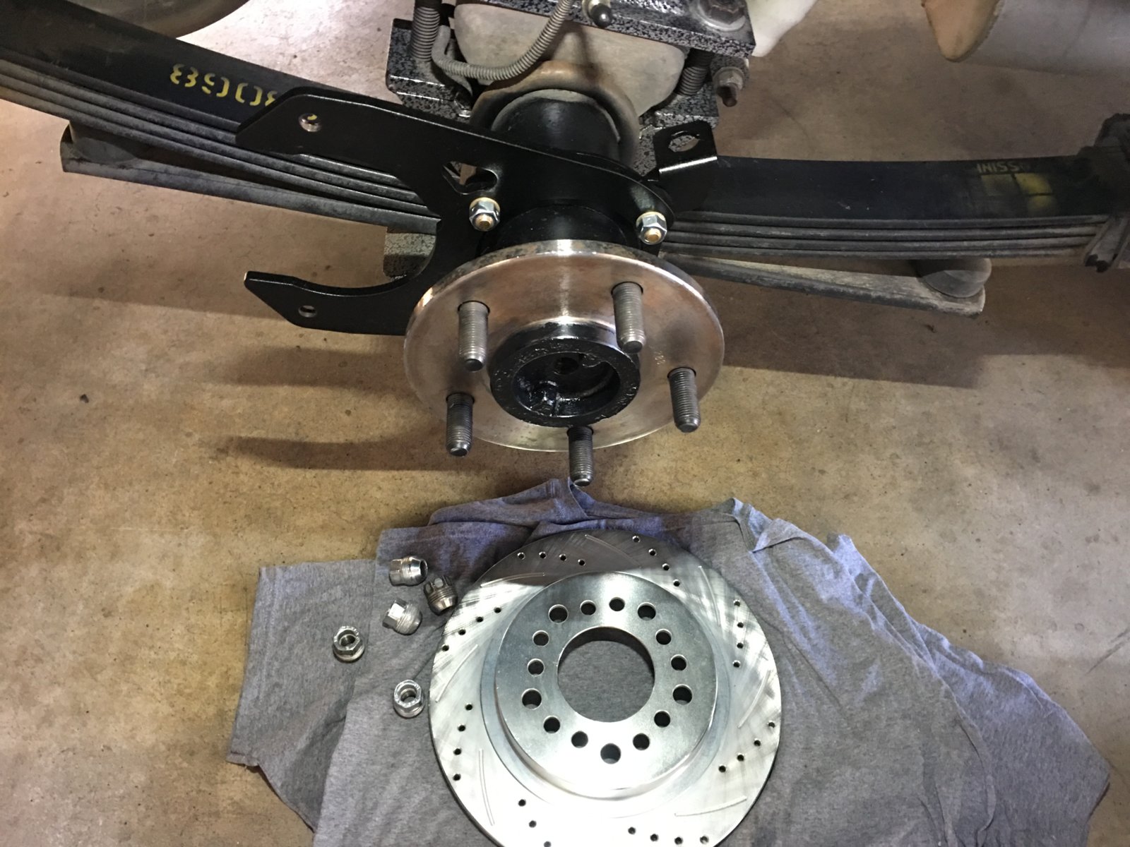

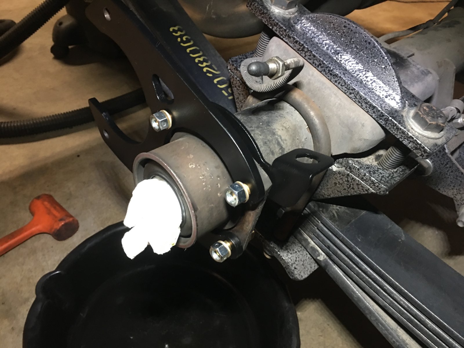

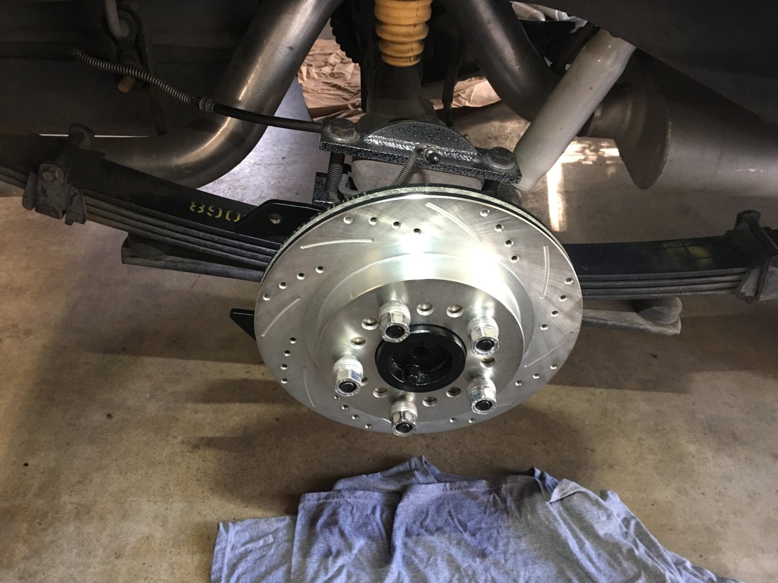

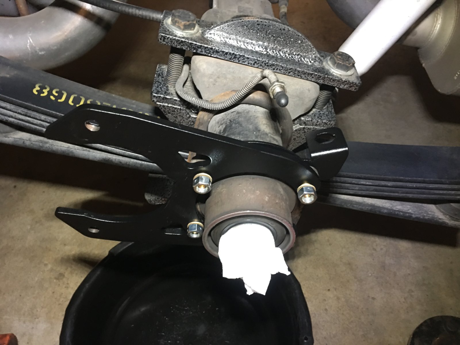

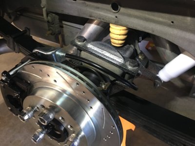

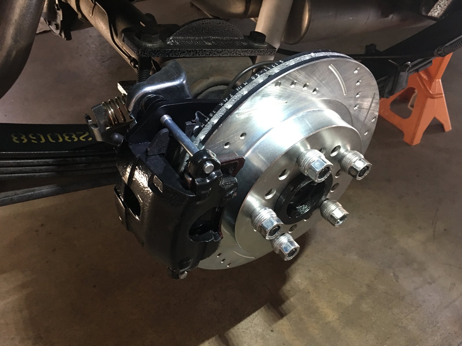

Here are some pictures of the axel installed along with the bracket mounted with the rotors attached as well. Looking good now.

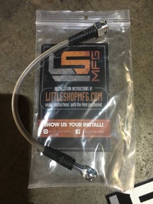

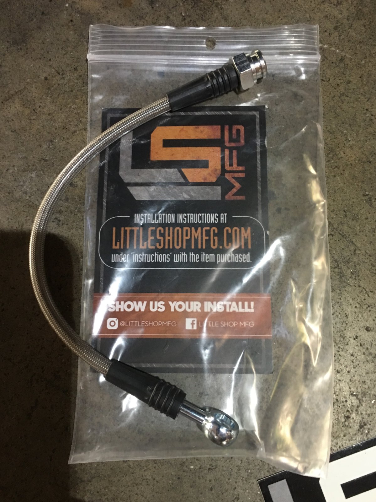

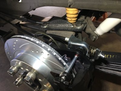

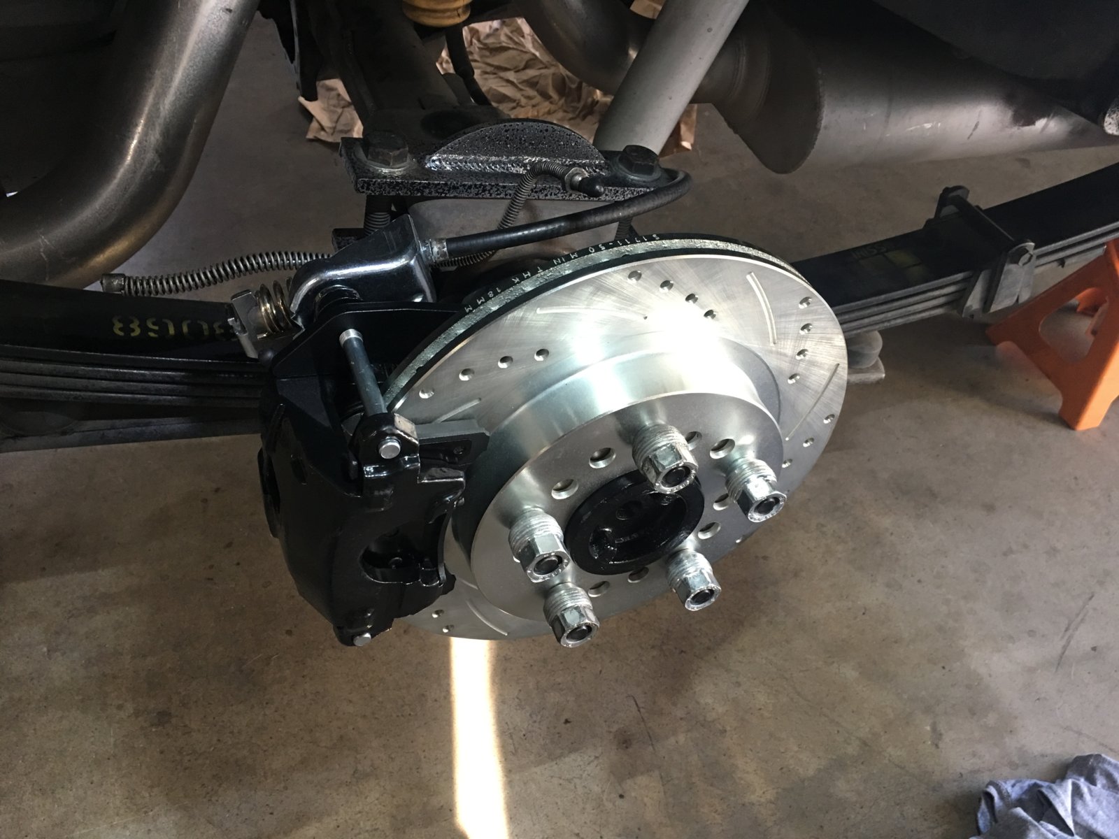

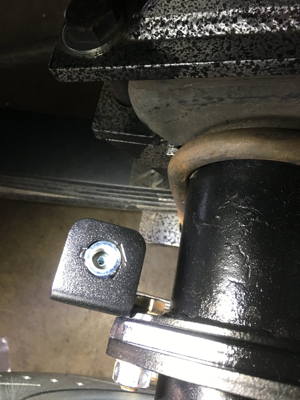

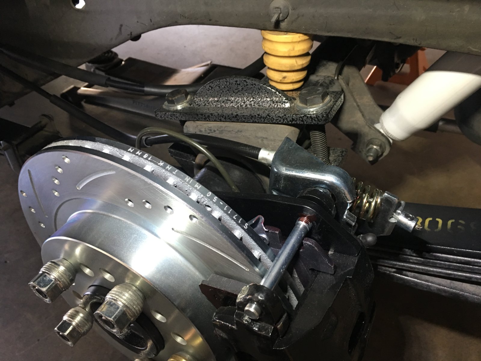

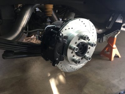

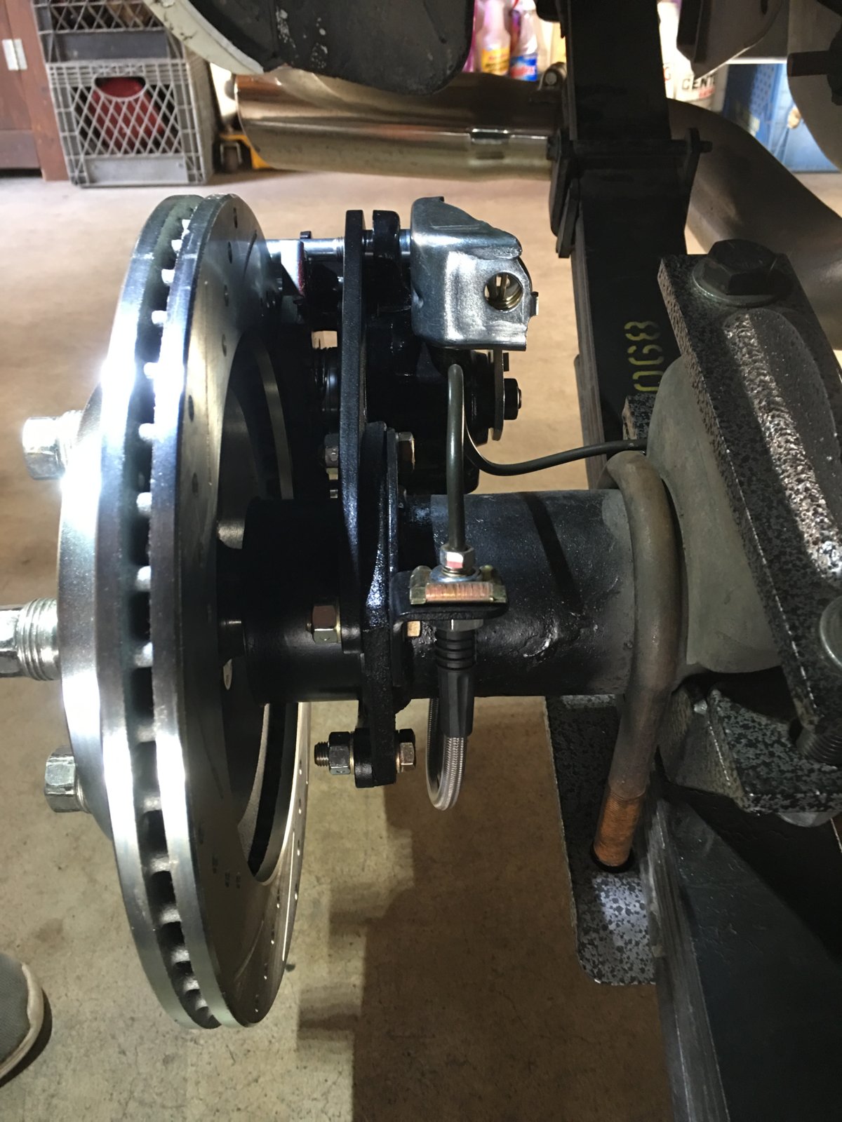

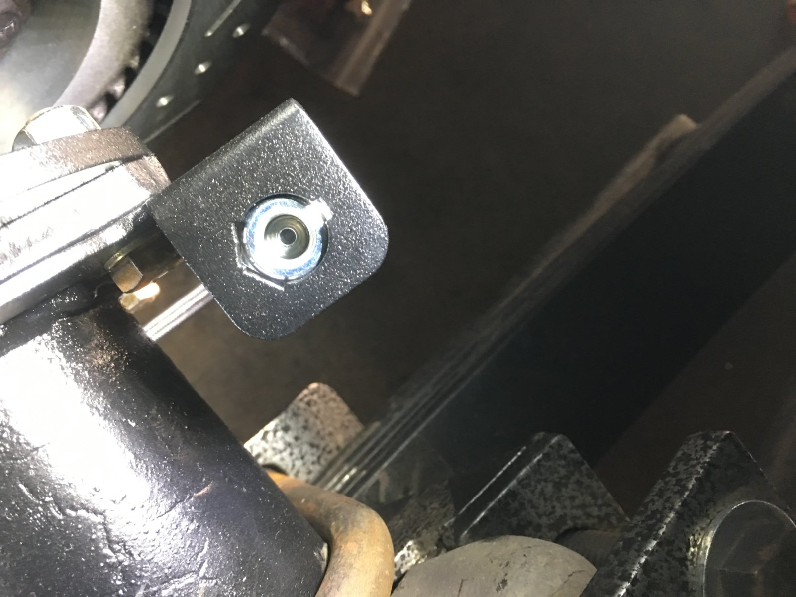

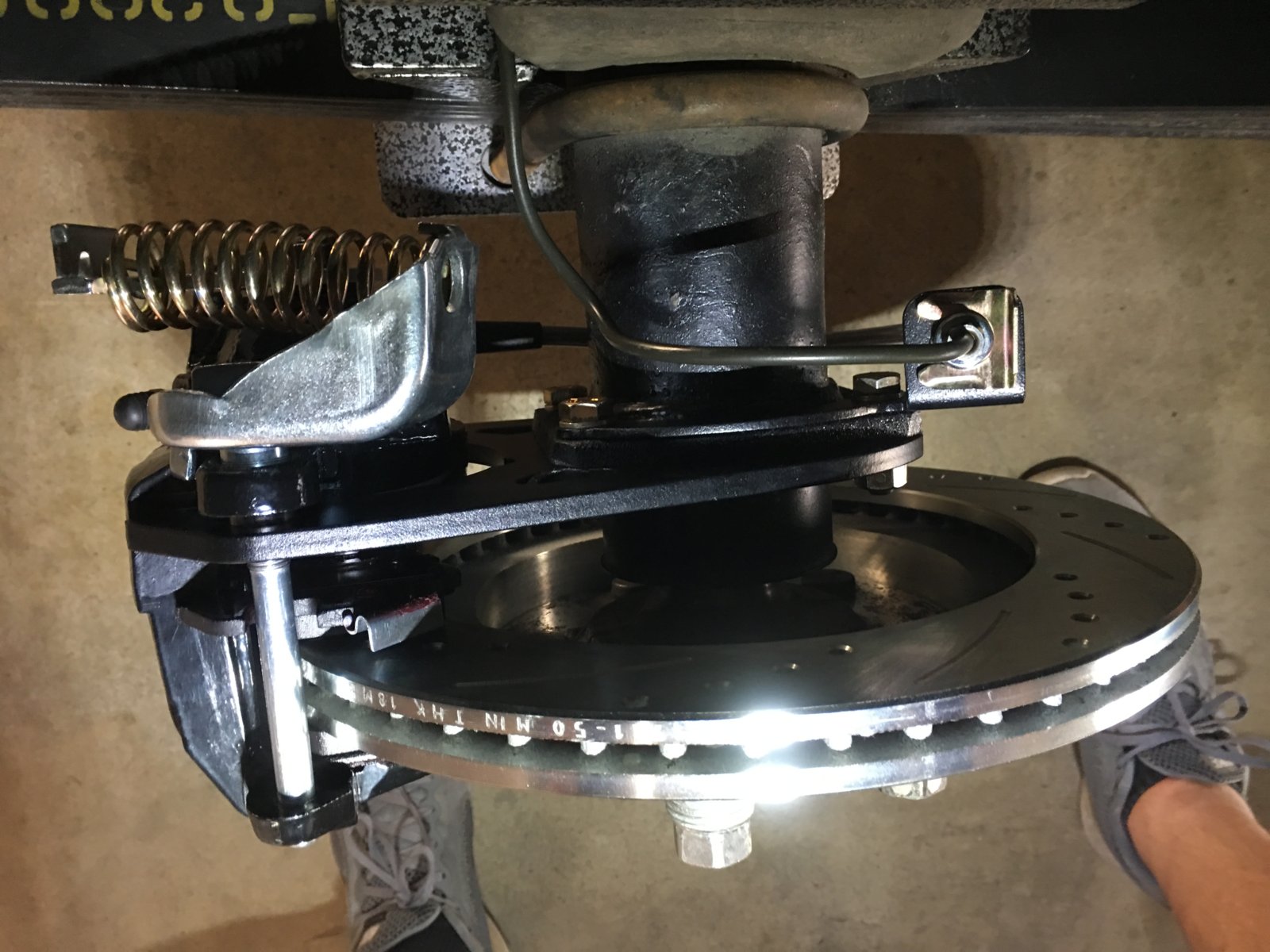

Here is some pictures of the Caliper mounted to the mounting bracket and the rotor. Also some pictures of the of the bracket that holds the stainless steel brake hose that goes to the caliper and the main brake line. Just make sure that anything thats powered coated is cleaned out from the holes and threads, otherwise it won't fit. Run at tap through everything before installing your parts!!!

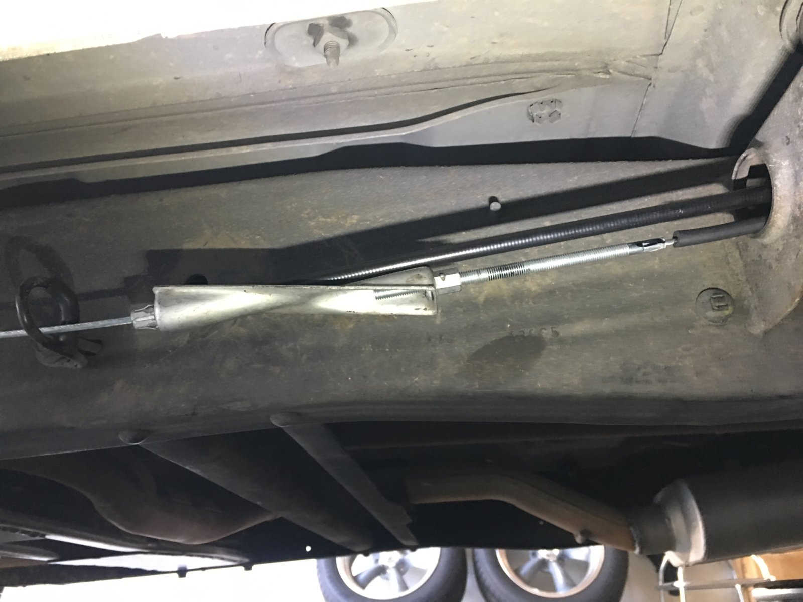

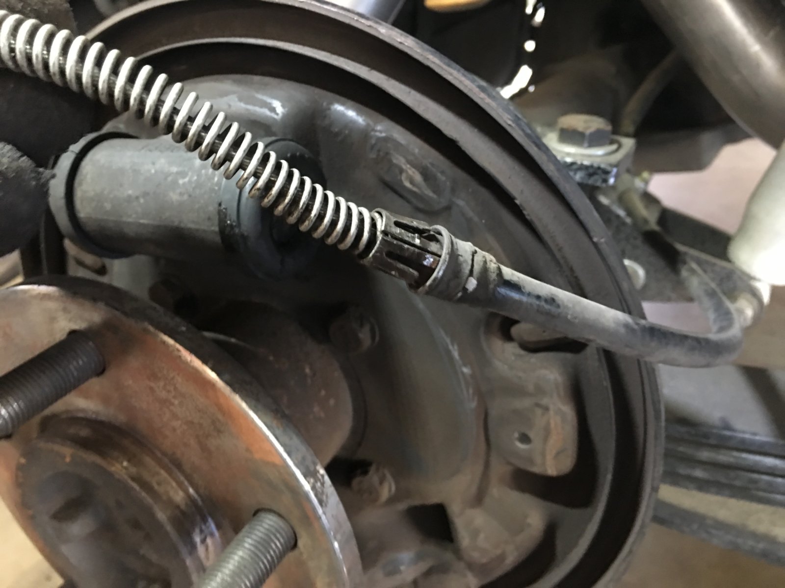

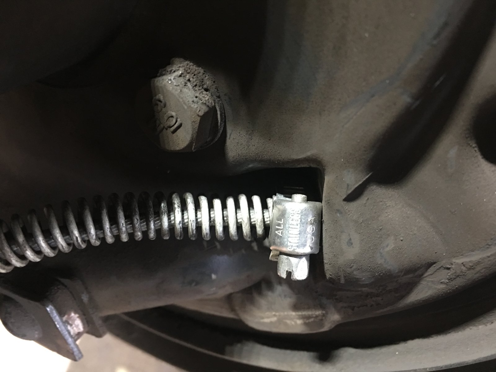

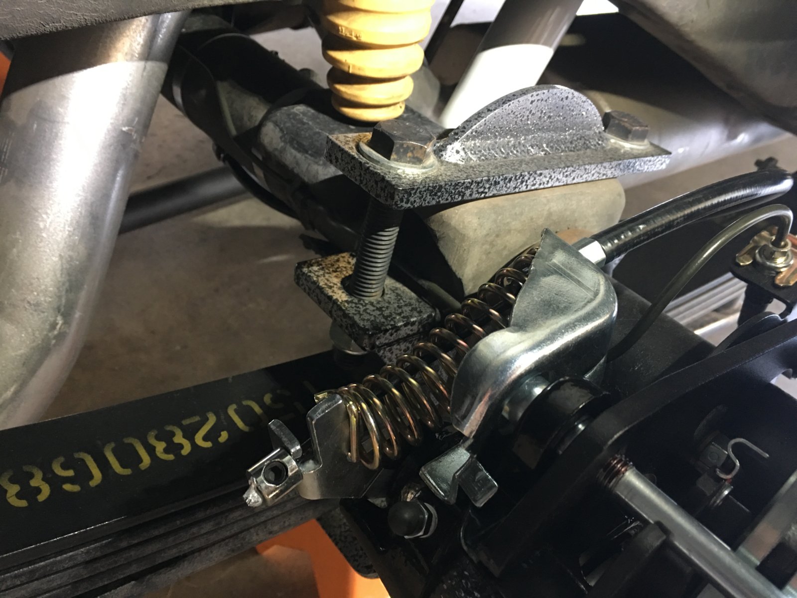

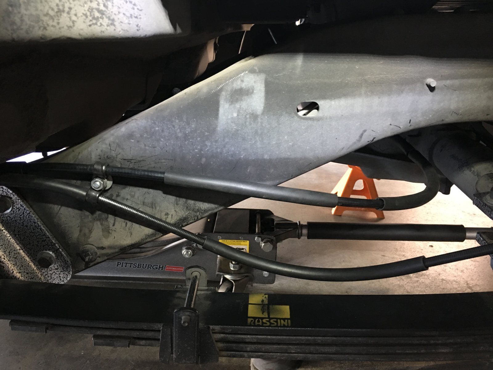

Now as for the rear emergency brake cables i had to get ones from a 4 door 2 WD Tahoe. The only reason had to do this was because I have a DJM rear flip kit witch moves the rear end back like 2in. So this means that the stock emergency brake were just about 2in short, especially the driver side. So I ordered them from Rock Auto. AC Delco and were like 15 bucks each. Super cheap. I knew going into this I was going to have to make mods due to the changes that I have already done. So here are a few pictures of what have done below.

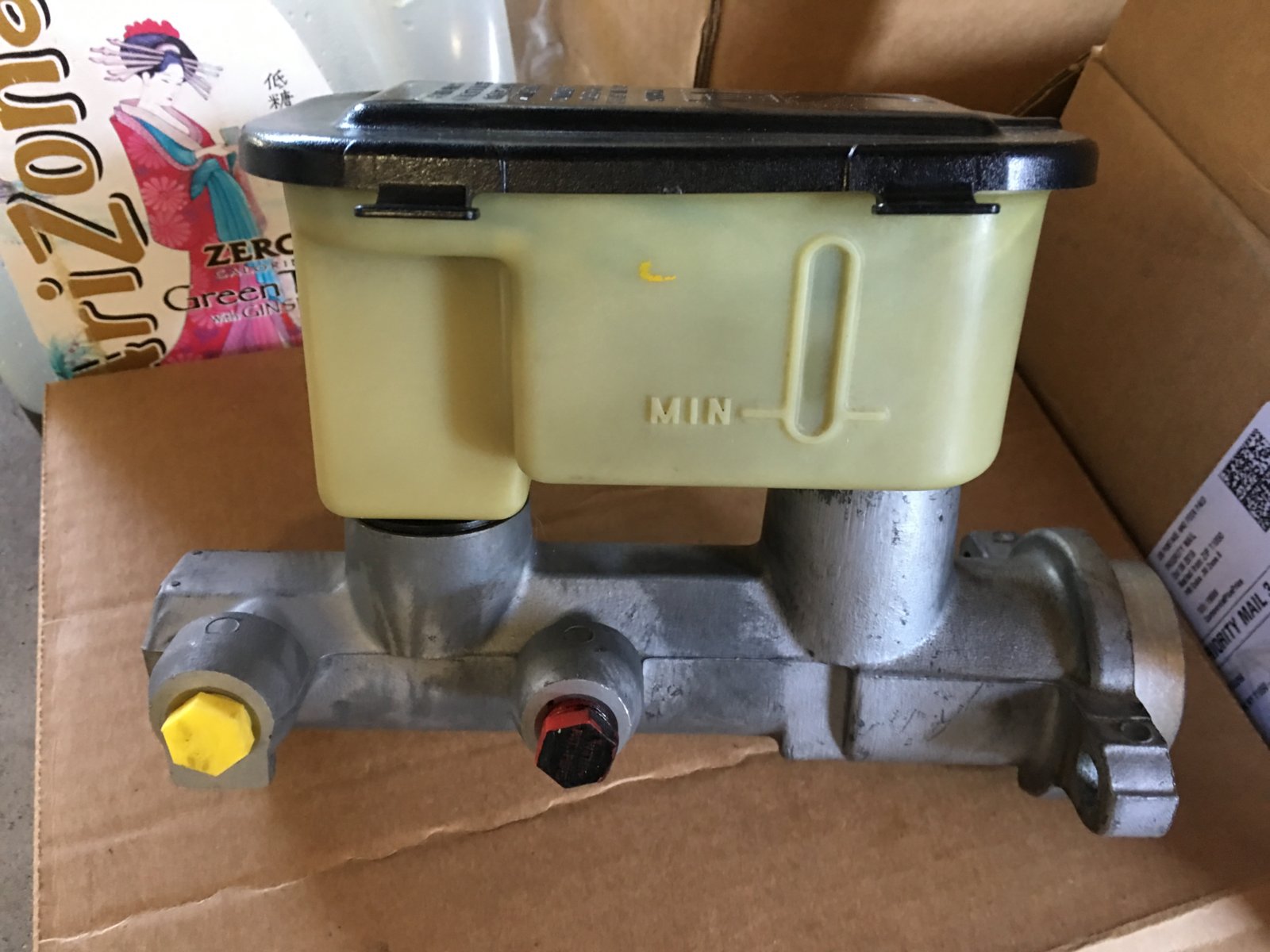

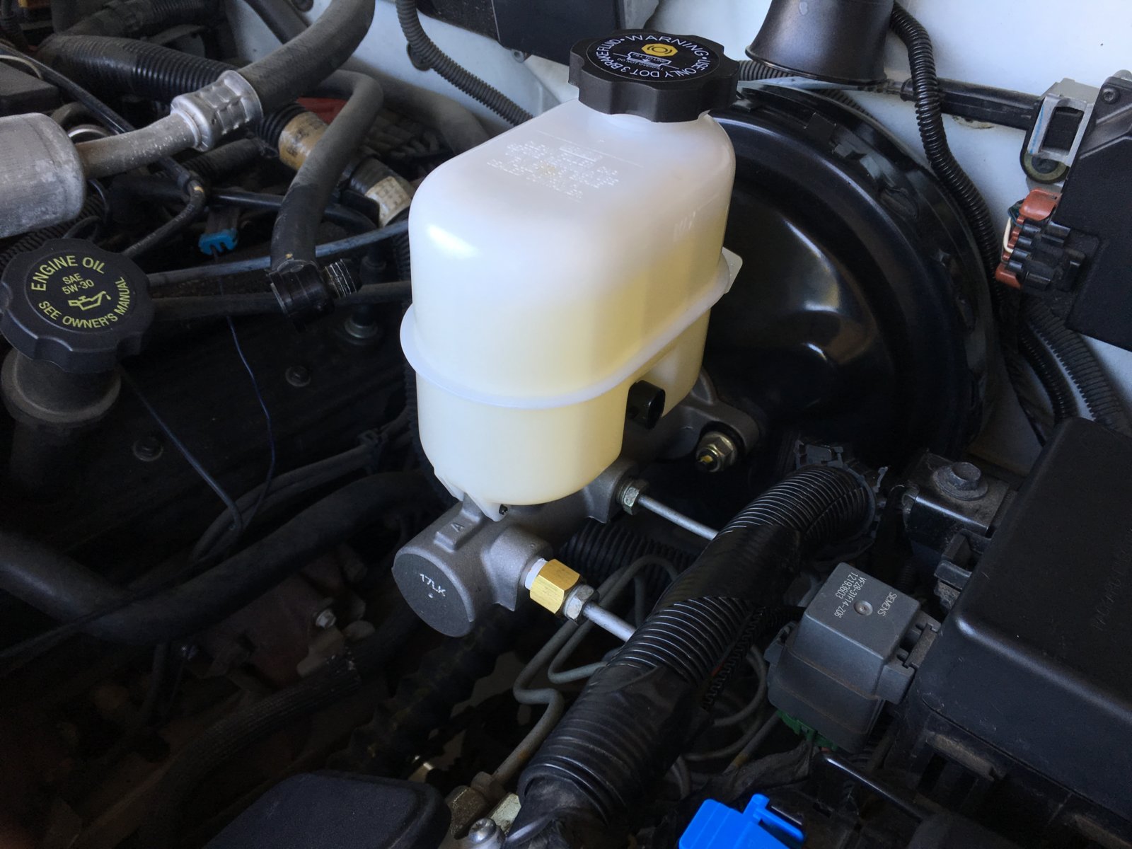

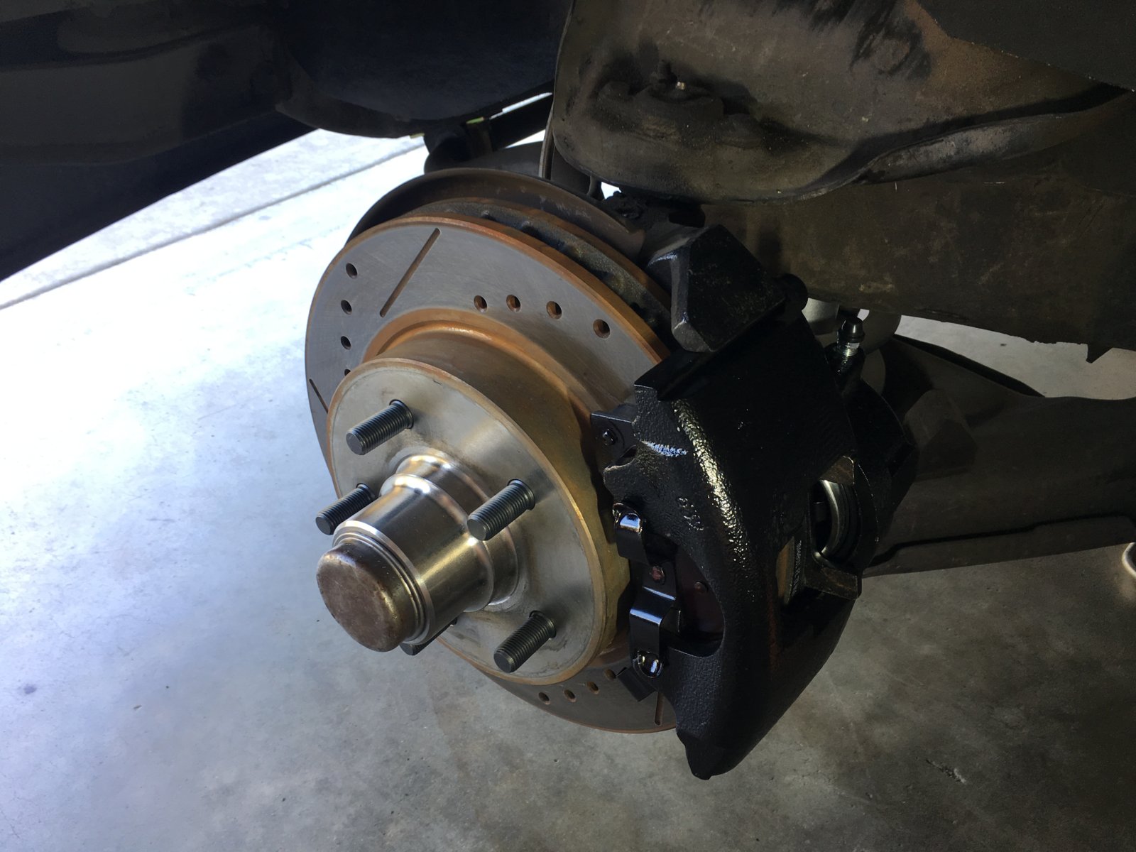

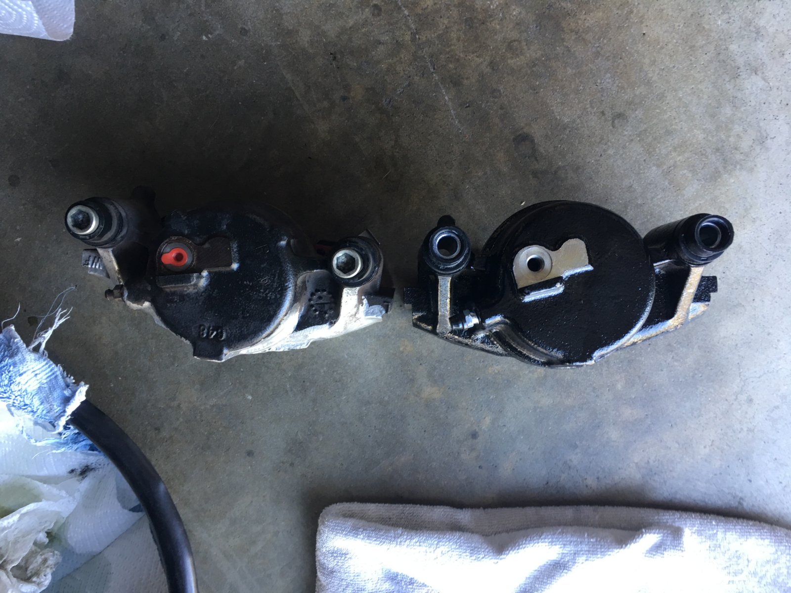

I put the larger Front Calipers on as well. These are from a 2500 series truck from the same gen as ours. I have a comparison picture of the two calipers. As you can see there is a slight difference in size and the pads are about the same size but maybe just a slight bit bigger. They are a bolt on as well with no mods. Also with the changes I have made to the calipers I now have to use a master cycling from a NBS truck. They have a larger bore for larger caliper on both the front and rear now. I will be installing that today as well. Here are a few shots below.

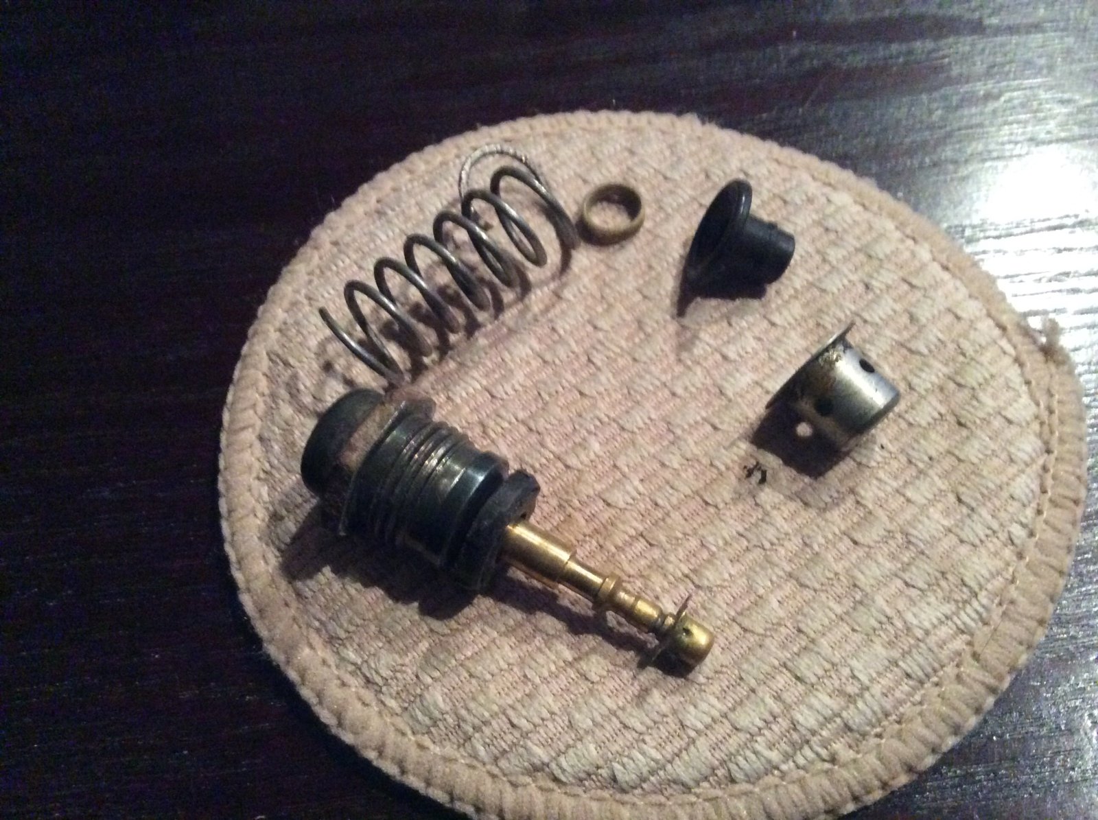

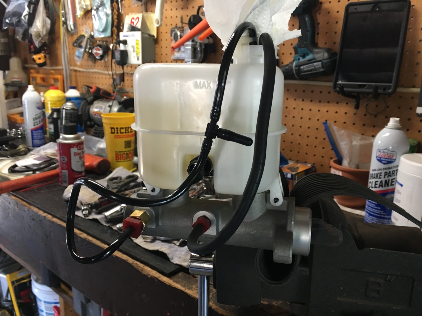

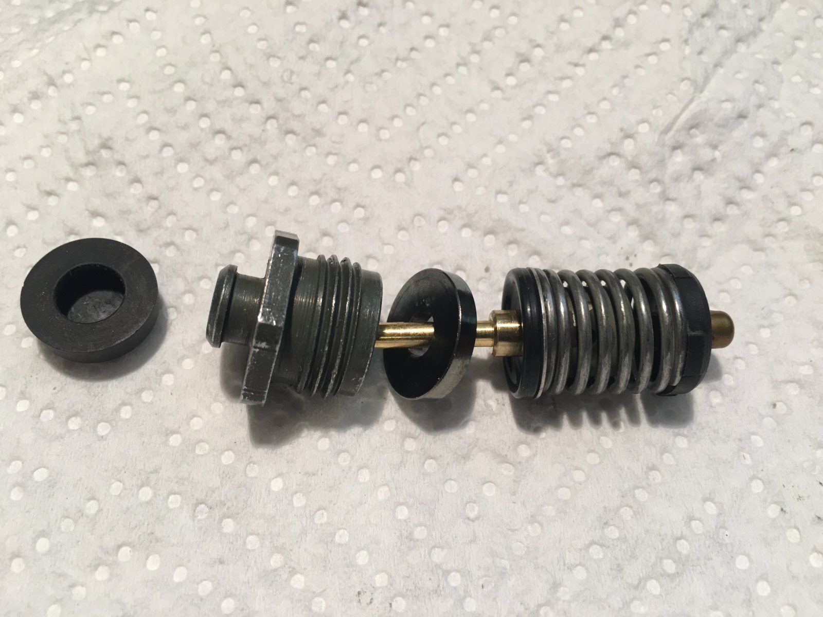

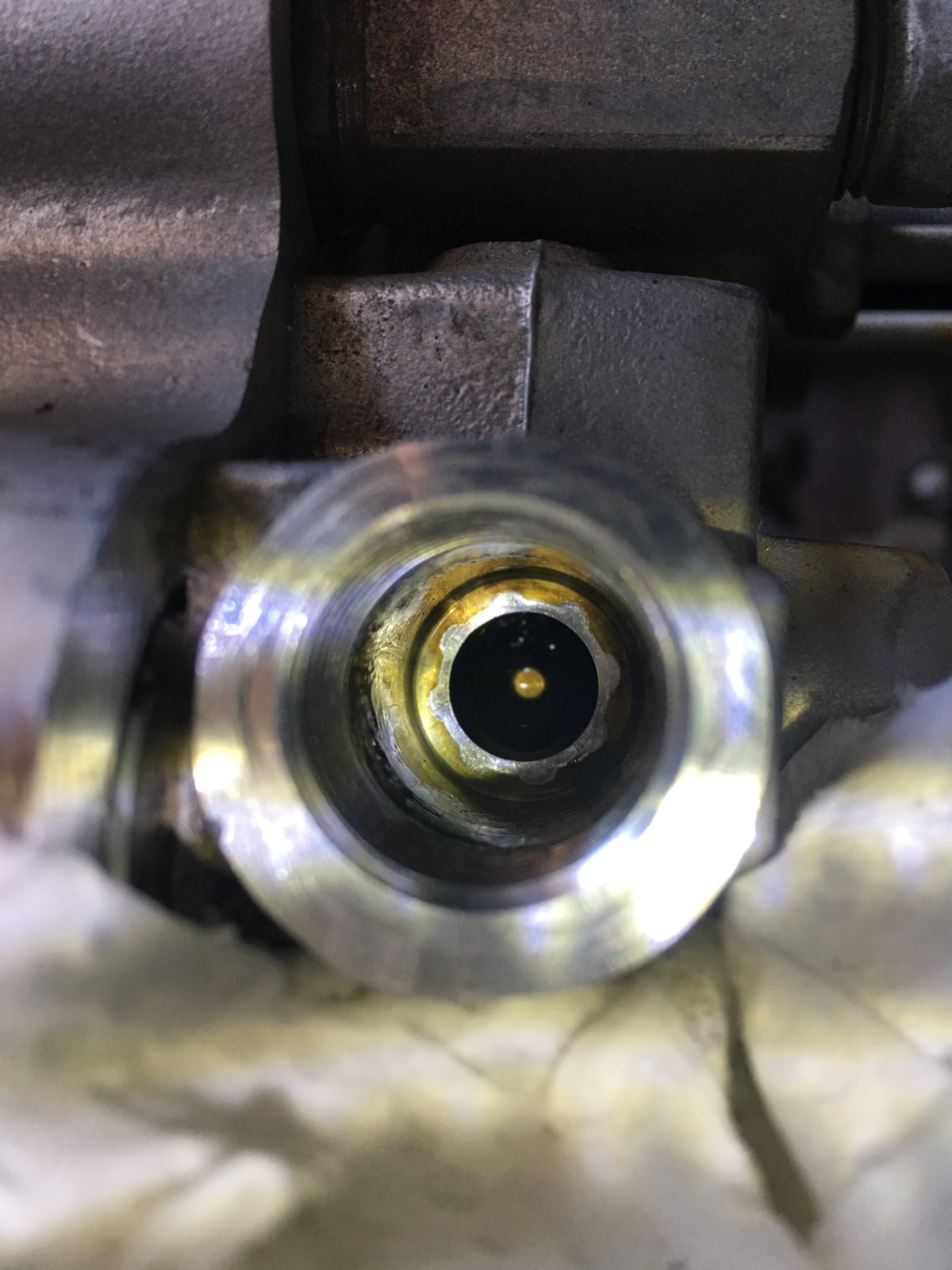

Well today I finished up on the install of the rear disc brakes and all of the other things I did to it to make it work properly. So I swapped out the old master cylinder for the new body style that has the larger bore and is made for the rear disc. Don't forget to bench bleed to new MC, this will make you life so much easier. Also I tried to modify the proportioning valve as per the instructions but that was unsuccessful. I could not get the rest of the valve to come out of the PV housing and I did not want to damage it. I did call LSM and they told me that in some cases it would not be possible to modify the existing PV do to the different types that GM has for these trucks and its OK to use what I have and I should be fine. So I put the PV back together and used it like it is. If i have any problems later on I'll change it out for a adjustable one and disconnect or bypass the ABS system all together. Pictures below showing what was found and done.

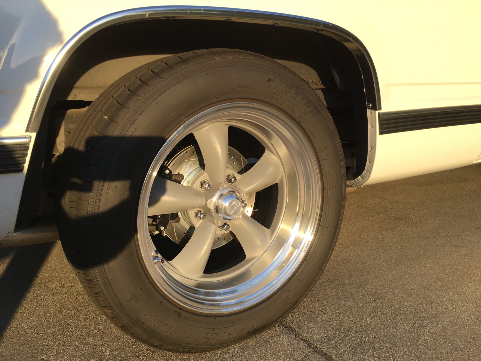

Now I went to bleed all 4 wheels starting with the farthest wheel and worked myself back to the nearest and the repeated this one more time for good measure. Im lucky that I have a one man bleeding kit as well, it make things so much easier. Just a few notes on this install. Just make sure that you give yourself plenty of time to do the swap. It took me over a week to complete because I took my time and made sure that everything went together correct and I did not want to redo anything if possible. So the kit that I purchased cost around 750 bucks with shipping to Ca and the upgrades that I did, like slotted rotors, emergency parking brake calipers and stainless steel brake hoses. You can get the basic kit for 380 bucks. I also upgraded my front calipers to the larger 2500 and got the NBS master cylinder as well. Also I want to thank Eric from LSMg for his help with some of the question I had regarding the install I did. He answered them super quick and he helped me out tremendously. If you guys have any question that you need answered regarding this swap just PM me and I'll do my best to help. I will also do a follow up in a a week or so to let you know my thoughts on the swap as well. Pictures below on how it looks on my 2 Dr Tahoe.

site says op hasnt made a post since last year so i suggest making a separate post and asking the same questions if you dont get a response. im sure others on here have went with the same system. on a side note your rear drum hardware is in good condition cycling the e brake a few times should ratchet the pad adjusters for you. you shouldn't have to be bleeding brakes and manually adjusting the rear brakes.
