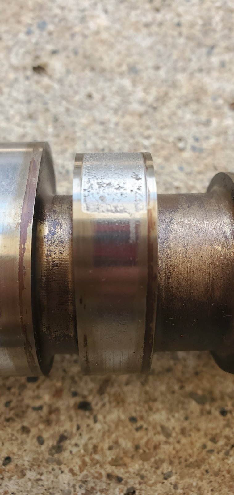

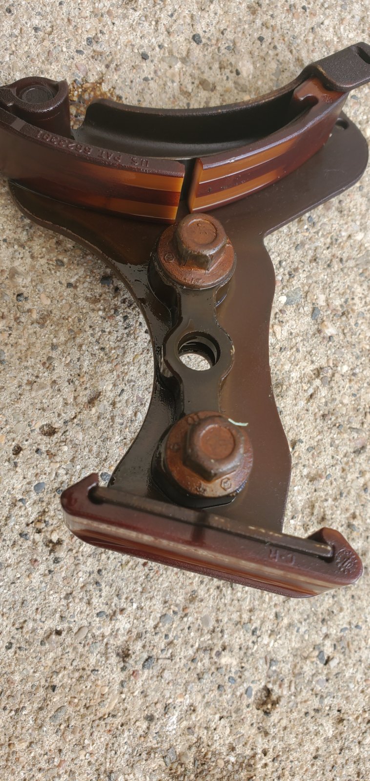

Looks like I had a broken tensioner and not sure what would have caused the squarish spot on one of the lobes? Looking the crank sprocket over as I am not sure I want to try and tackle that if not needed, based on what others say about getting it off.
Classic spalling on the lobe. My guess is a lifter binding up.
Tensioner breakage is a common problem as well. Yes, you can reuse sprocket.
Thank you. I had one lifter collapse.

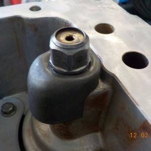

Should I plug the pressure relief valve in the oil pan or replace it? If plugging, what is best?

I put the relief valve shield/deflector, gm#12639759-$8,
on when I was in the pan doing the pickup o-ring.

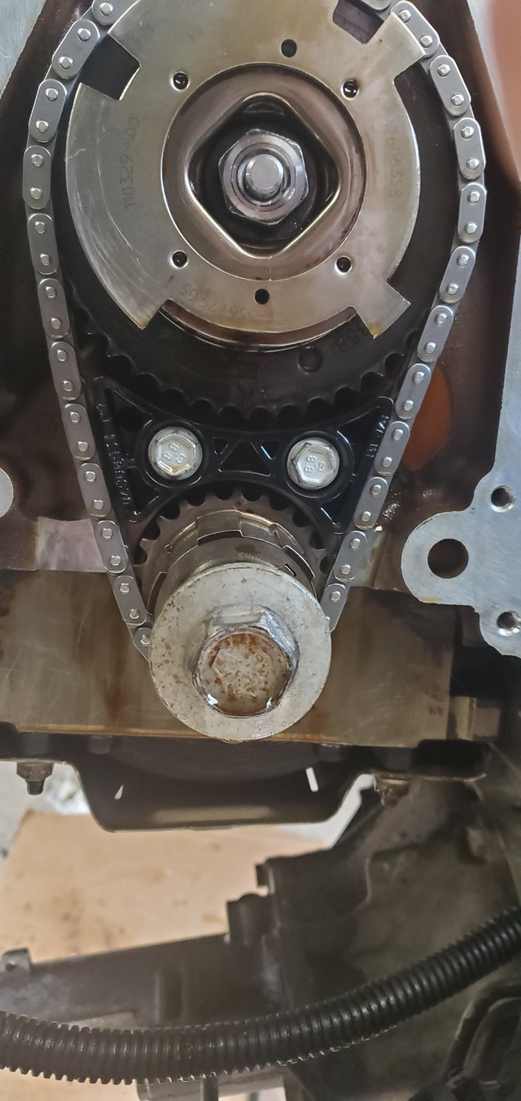

Is this looking like it should? Have cylinder 1 at TDC at this point. There is a little bit of slack in the chain.
