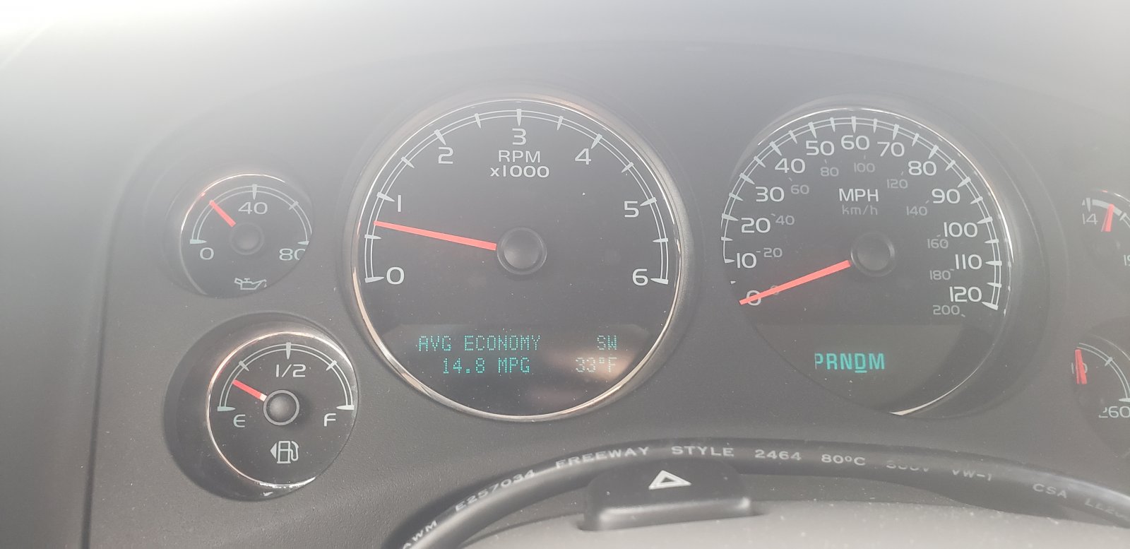

LOL, my mpg went way up with my new 6.2. Except my tank was on empty showing something like 16 gallons used and requiring 24 gallons to fill...

Hand calc matches dic on mine. Its noticable how much slower the gas gauge is going down too. When I would go downhill before, instant gauge would only read like 35 mpg. Now it reads 50-99. Thats the biggest change. Seems like idle is using less fuel and DFCO is kicking in now.

Nice. I need to talk to my tuner. The last time he got to mess with it I had filled with regular to see if he could make it use that. No joy but he left it so I wouldn't blow the bottom end apart with what wsss in there. I expect great improvement but I want a dry day.
45,014
Relocated IAT
Clean maf
Tweaked 02s to be less reactive on the fuel trims
Rock solid idle, perfect drivability and now better MPG than the 5.3 by a lot. This is my normal drive to the stores, mix of some 45 mph highway and stop lights. 5.3 normally got 13 mpg.

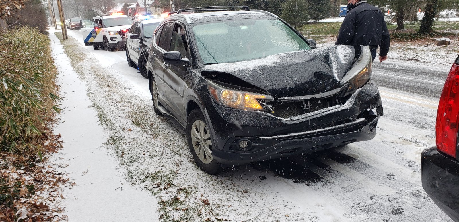

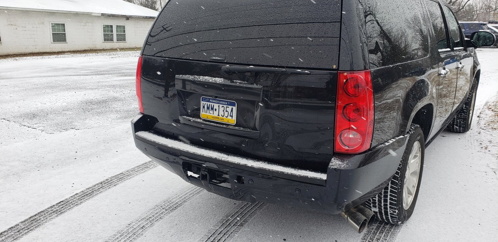

Got rear ended yesterday. The Honda that hit me completely destroyed. Yukon barely any damage lol. Love these tanks.
You have a hitch or no? If yes, did he hit your hitch ?

Many years ago I had a full size Bronco and got hit from behind by a Toyota. No discernible damage to the Toyota but my back bumper was twisted like a Christmas ribbon. Of course the guy's information was all false.
