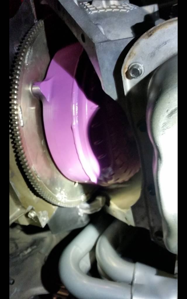

Literally swap everything from your 5.3. The only time you will see the flat flexplate with spacer on a 6.0 is of its attached to a 4l80 and in that case take the 4l80 too lol. You may need it sooner than later. A 6.0 from a 1500 platform will have a 4l60 behind it..
In my case I have a dished 4l60 sfi rated flexplate connected to a 4l80. I used the same flexplate on my 4l60. The converter is cut for the 3 hole 4l60 pattern but splined for a 4l80. There are a lot of ways to skin a cat.
