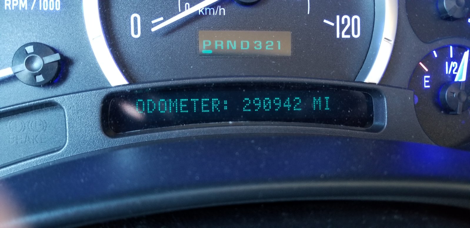

My 04 Tahoe just rolled 290k on original engine and trans. I'm considering a 6.0 replacement. Is it worth the effort to drop an LQ4 in there in place of my L59 5.3? Researching it, there isn't much Torque or HP difference between the 04-06 5.3's and the standard LQ4 6.0. The LQ9 definitely has more to offer. I was considering an L33, but dropped that idea for the same reasoning and due to the unfounded price premium an L33 brings.
