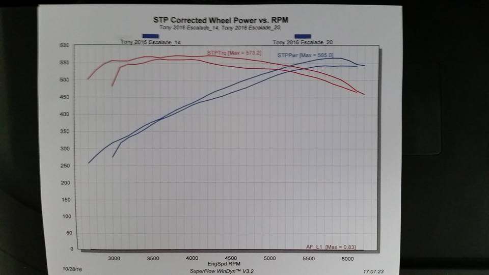

WELLLLLLLL my Whipple 2.9 Escalade making more power Very happy with numbers. 7.5 psi/91 pump gas/ARH Headers/3.5 MagnaFlow cat back/z06 fuel pump/fuel line mod and @gptuning tune. 565/573. Old run was 543/566 with 6.5 psi. What peak numbers don't show is mid to top end 20 to 30 rwhp/rwtq increase. We let off the run early that's the dip at end. I'm a full Whipple dealer and if your interested in a kit give me a holler.
Oh I'm also a Alky control dealer and so I have a meth kit coming. Goal is 600/600 at wheels at 7.5 psi with no internal mods....on 26s lol
I'm almost done with this project and its been fun.
