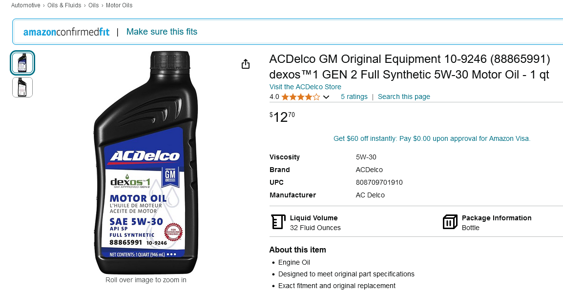

Wow, $ 12.57 a quart for ACDelco 5w30 motor oil??

Where are you getting that pricing? I've never paid that or anywhere close to it myself.
It's the 3rd Amazon link you posted in #6 of this thread:

if you buy oil by the qt it's all expensive. some of the liquid moly brand is well over 15$ a qt.
by the gal or those 5qt jugs is the only way. which of course is annoying when our trucks take almost 6 qt haha.
21,296
30,244
Oh! LOL
I've either bought it from a local ACDelco store or from Rock Auto myself. Prices kept going up so that's when I sought out an alternative and Quaker State was tested to be just as good for my purposes. If my memory wasn't so bad, I would have just listened to Pete years ago! LOL
