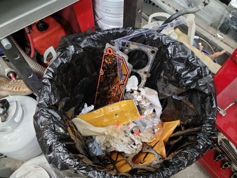

Fixing mine now... :cool:
If lifter tick, then that piece that's in the garbage can there.
Is the Vlom.
My bolts were loose.
Check yours.
I could remove the bolts with my fingers....
I already had the parts ordered, so I'm doing a full delete and didn't try tightening the bolts to see if it fixed it.
It requires removal of the intake in order to get to the valley cover/vlom thingy's bolts.
:cheers:
Otherwise, it's lifters and cam.
Or just replace the offending DOD/AFM lifters.
