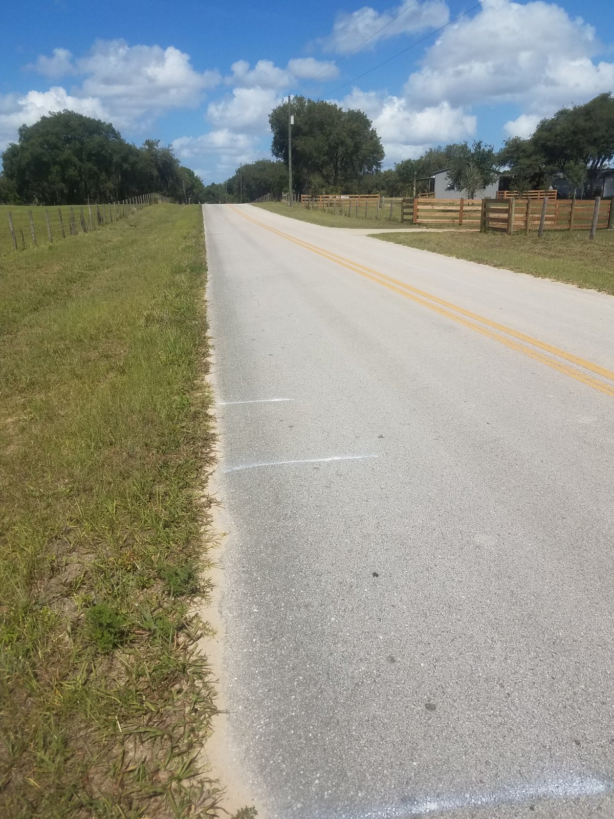

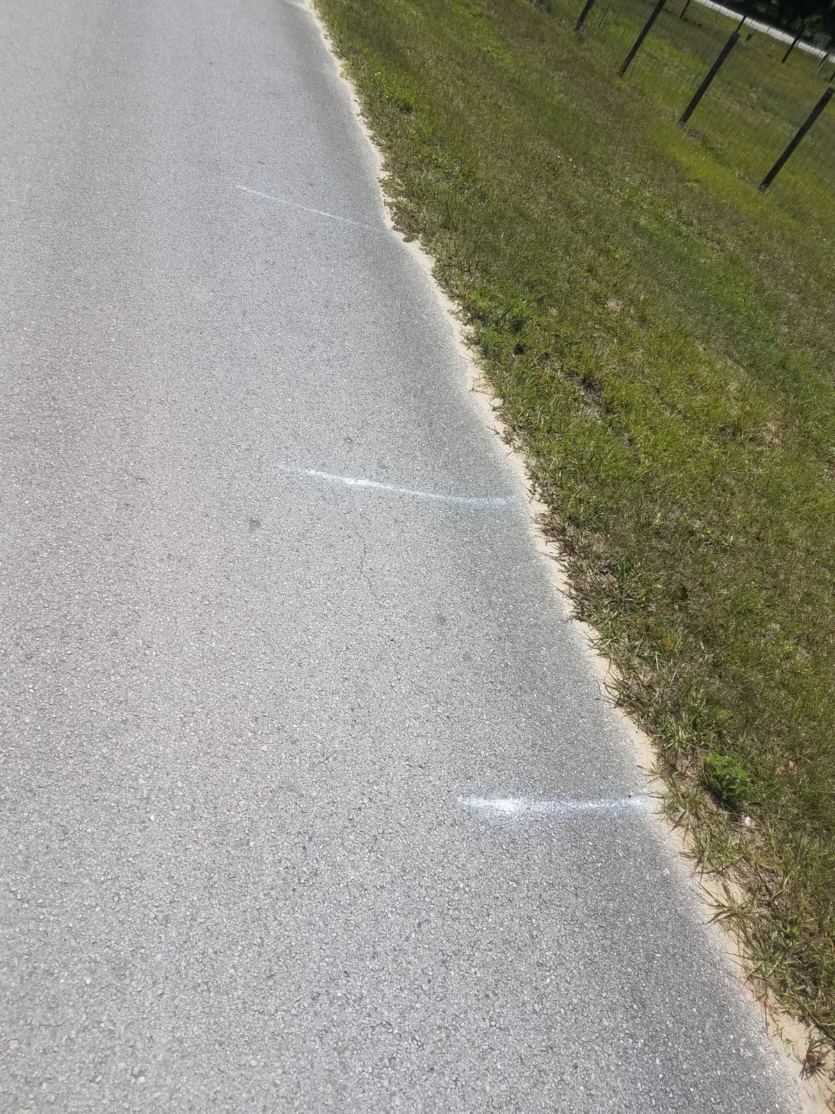

My swap is halfway through but I needed lunch so I'll post my current progress and testing.

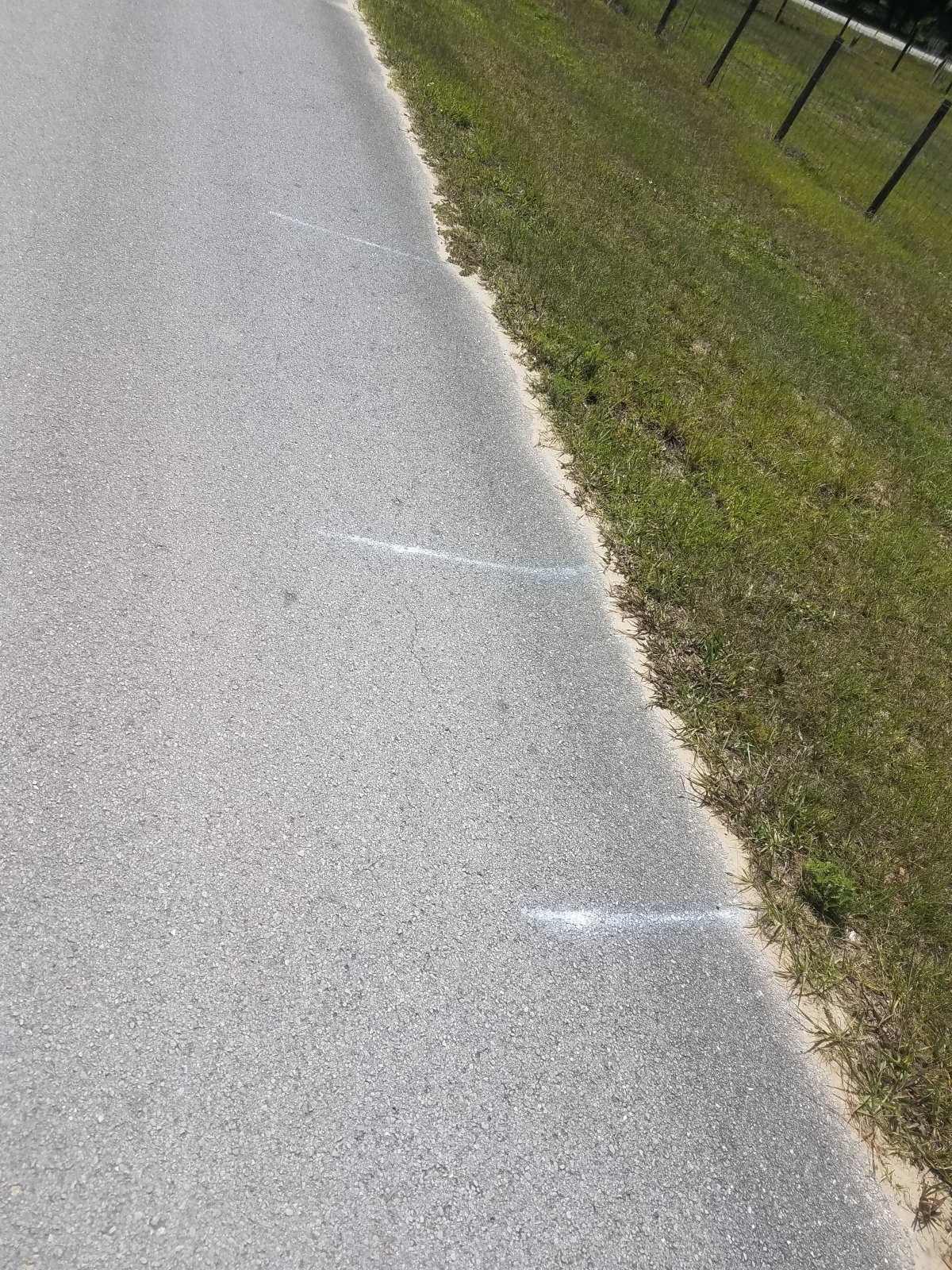

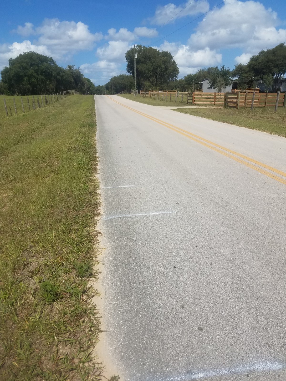

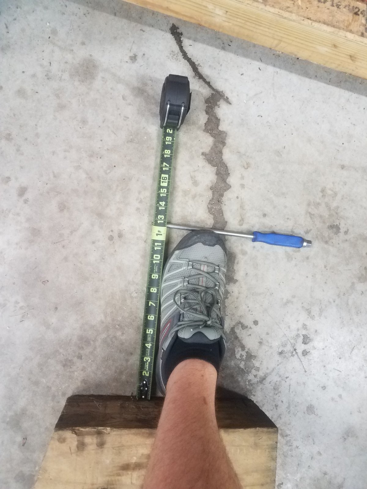

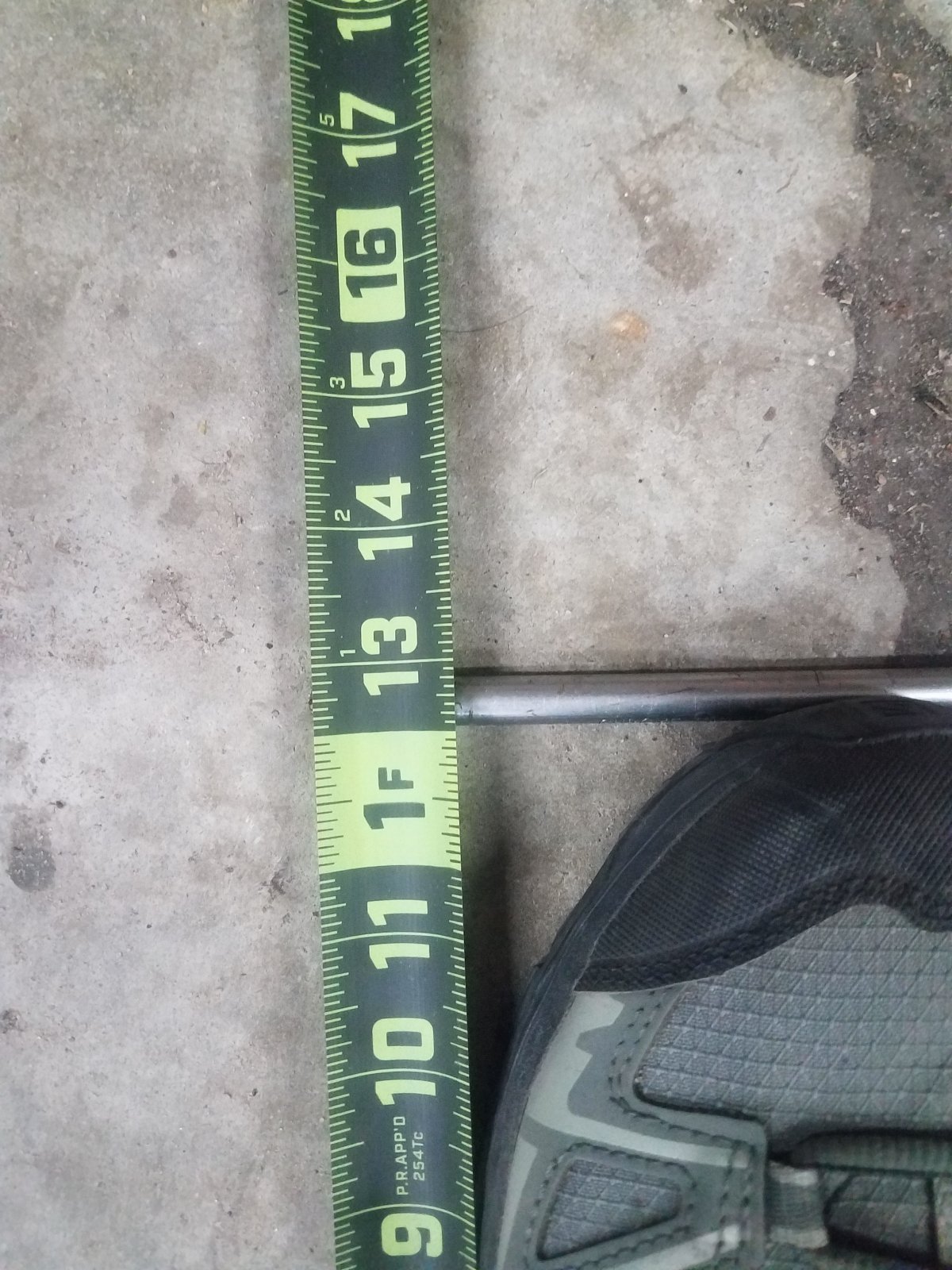

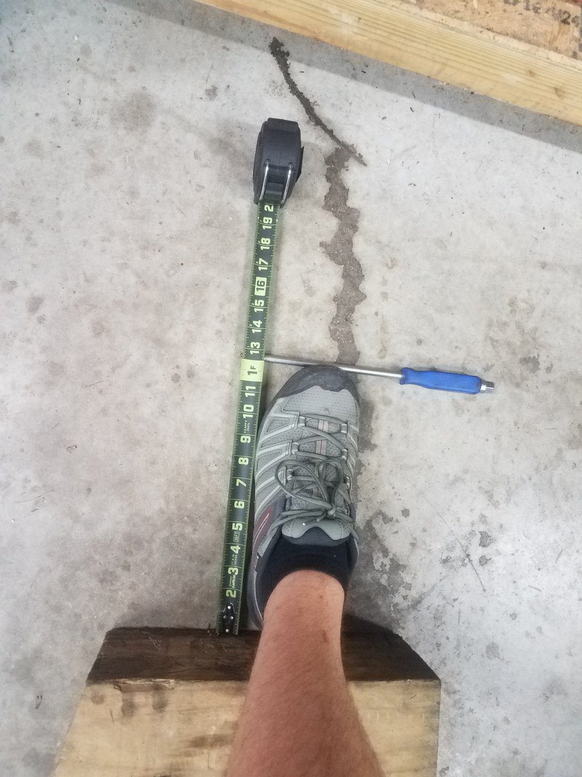

I started with 3 brake tests from 55mph to dead stop on flat ground with one solid push and hold of the brake, no pumping or anything weird. I measure the distances by walking heal to toe in a size 12 Salomon X Crest hiking shoe which measures just under 13".
First attempt was 87 steps, 2nd was 80 and third was 77. Of course its impossible to know if I hit the brake at exactly the same point everytime but i did my best. I think the main variance was the difference in tire heat. The first attempt was after a normal drive around the block to heat everything up and the 2 attempts after were directly after one another so the tires and brakes were likely considerably hotter and more effective. I will do the same tests after a week of driving and breaking the new pads and rotors in.
My point of reference to apply the brakes was dead center of the 4 board gates entryway in the picture. I did also have a white line painted across the road but it was impossible to see from the drivers seat.

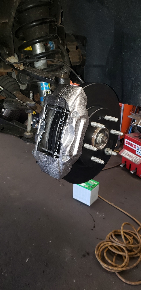

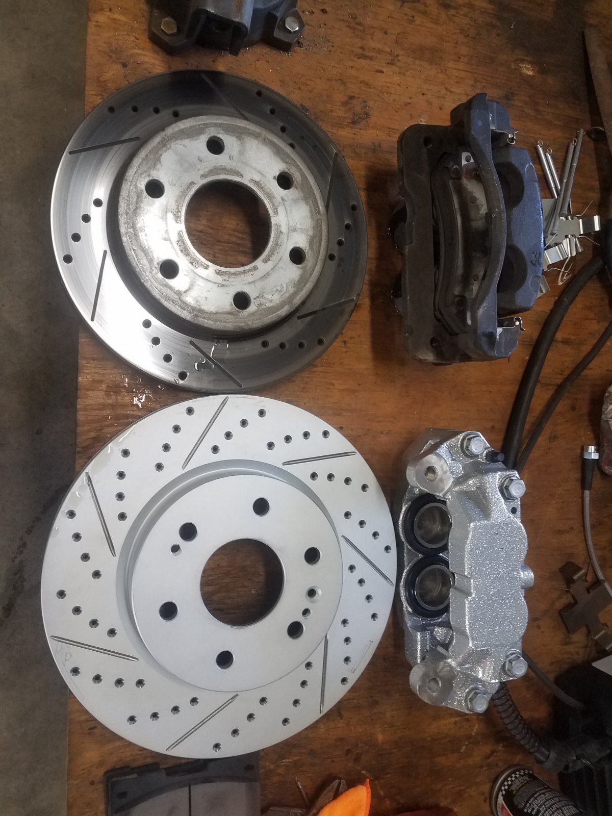

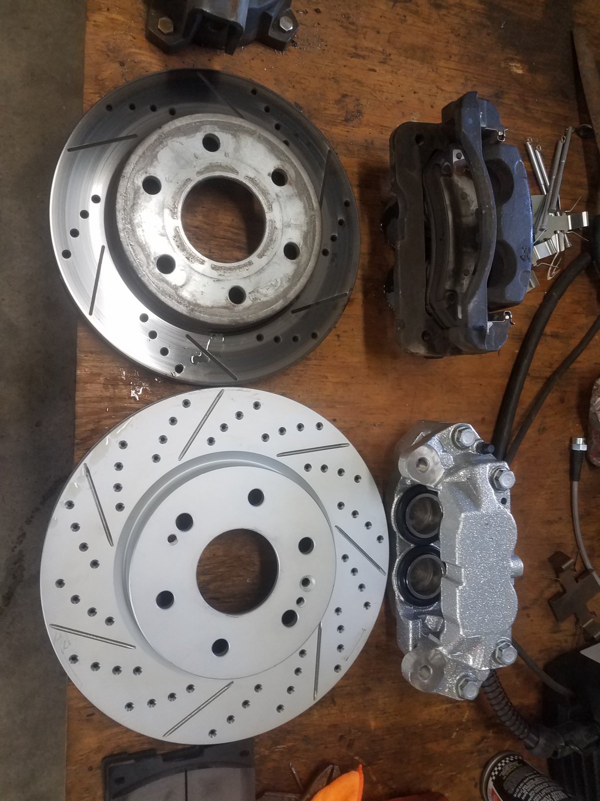

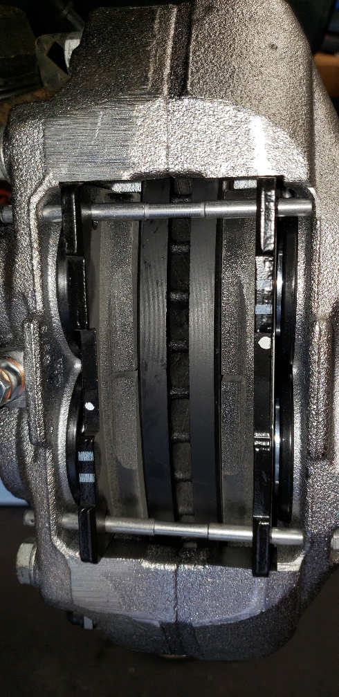

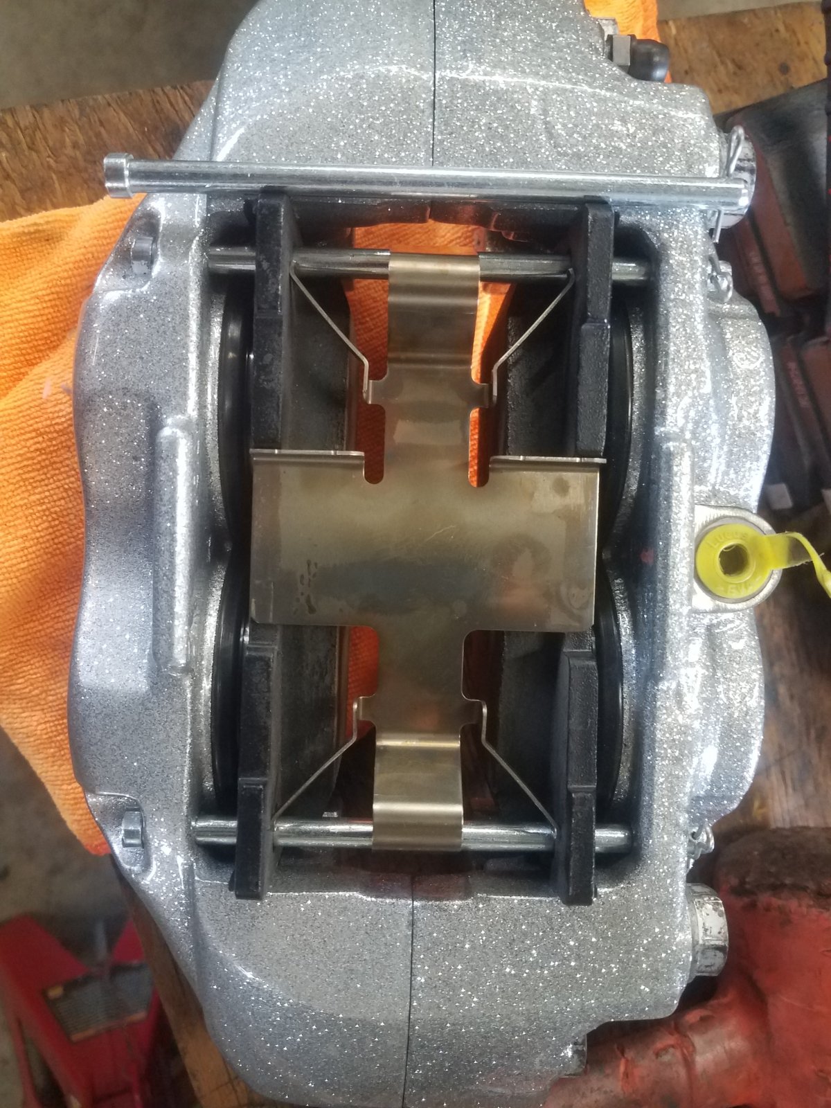

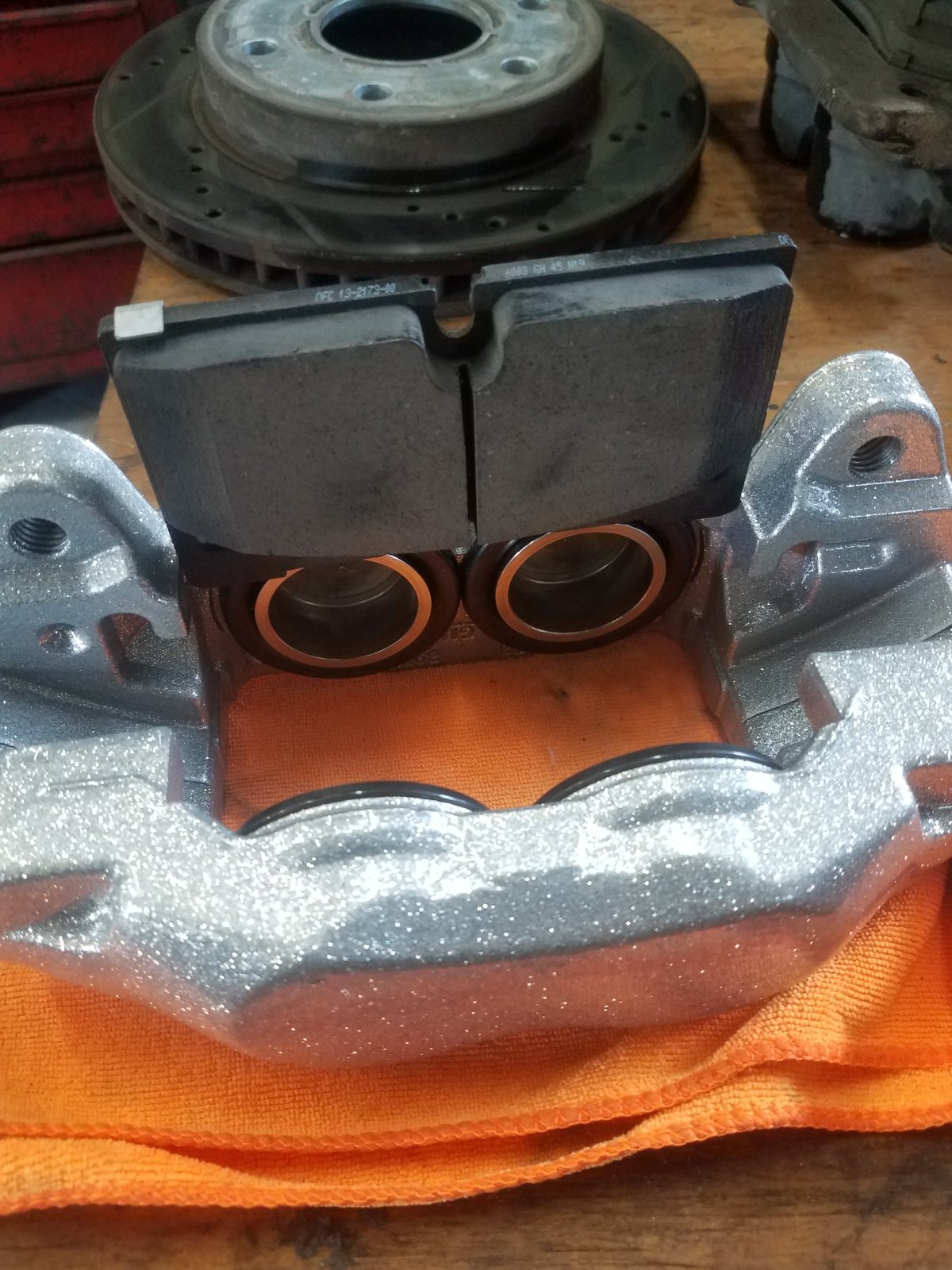

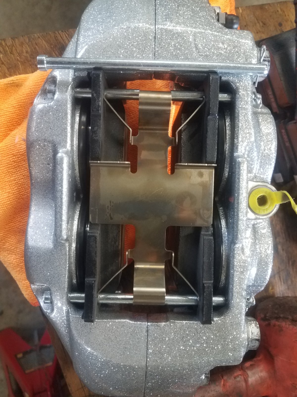

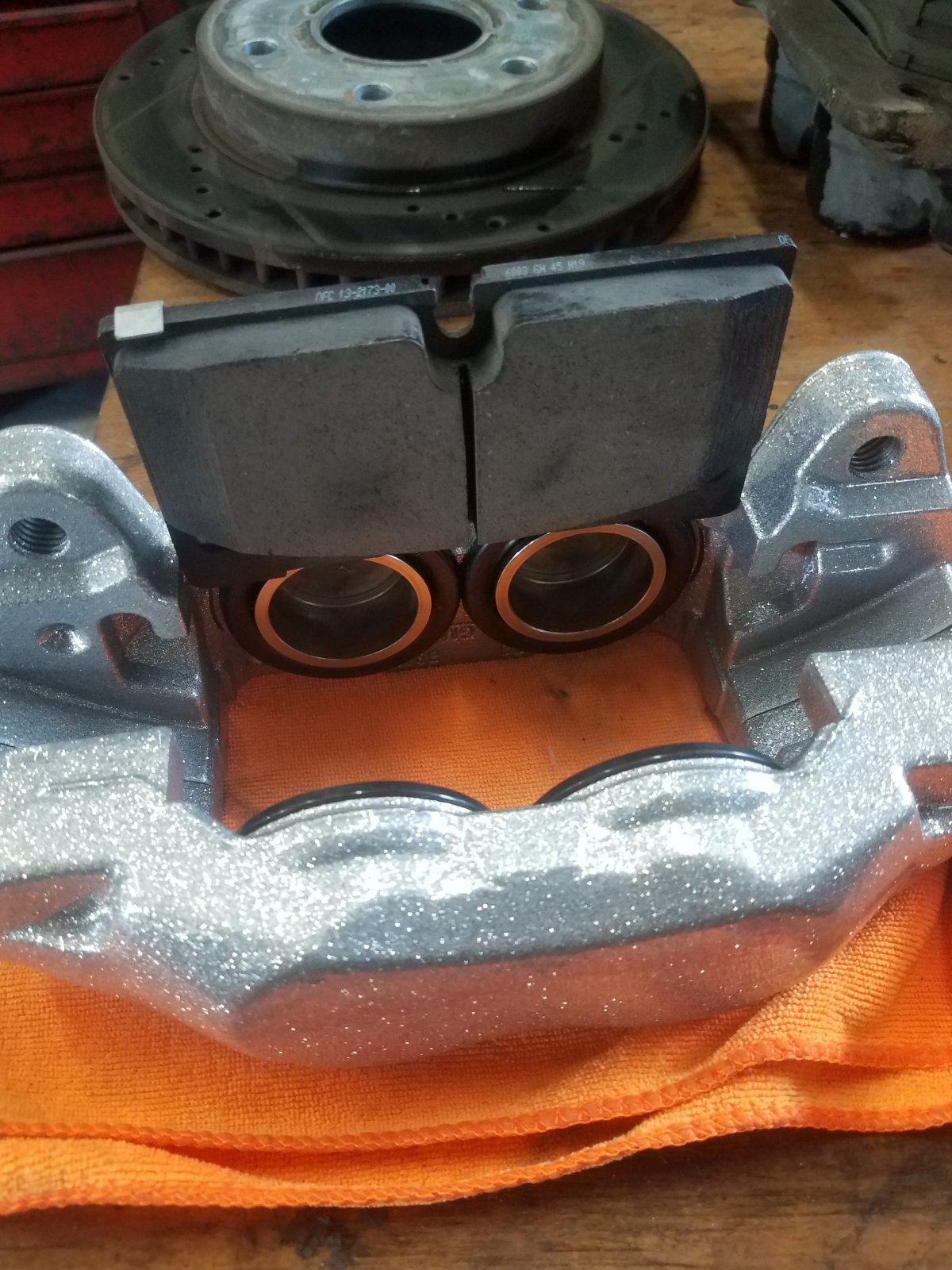

Brakes are fully installed and done, did a short break in lap and tried the test again. On just one try because I don't think they are fully bedded it stopped 6 steps short of the quickest stop with the old brakes, so that puts it at 71 steps which is almost 10% shorter distance. Give them a week and I'll do a round of three and see if it improves.

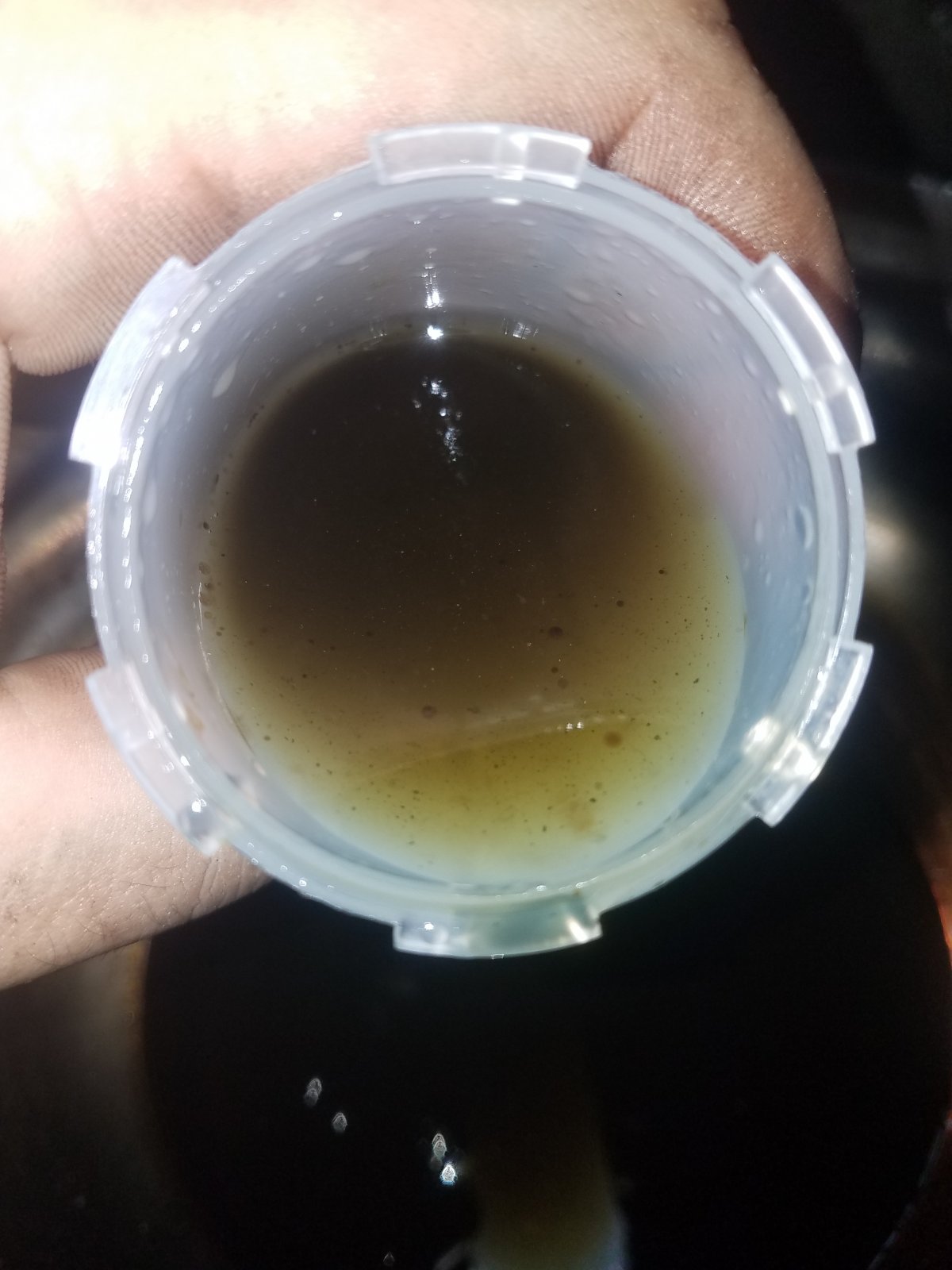

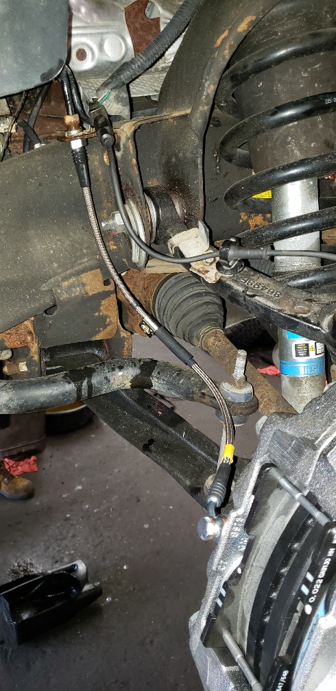

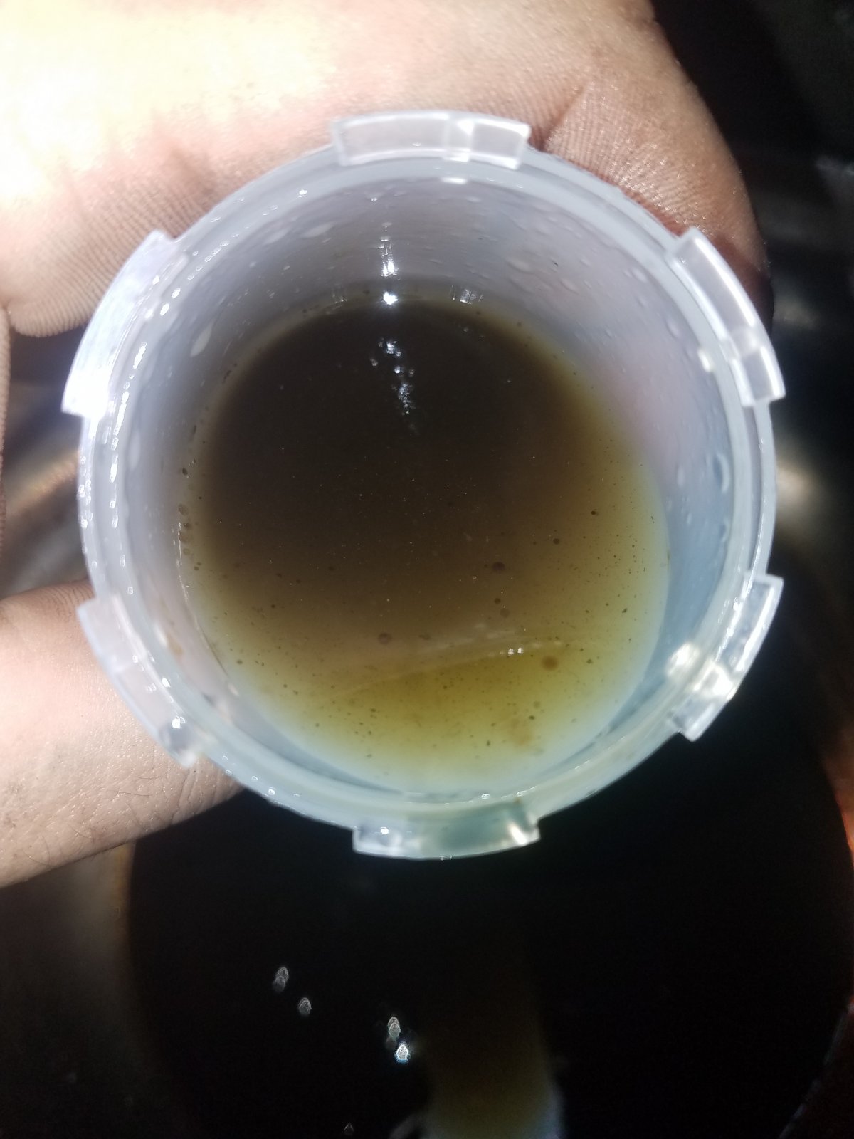

Along with this brake swap I did also do a massive 6 bottle flush of brake fluid because there was and still is some nasty stuff in the master. Plus I replaced the last of my rubber lines on the front passenger side with a SS line.

Very nice! Looks like you had the NNBS swap in previously as well..?

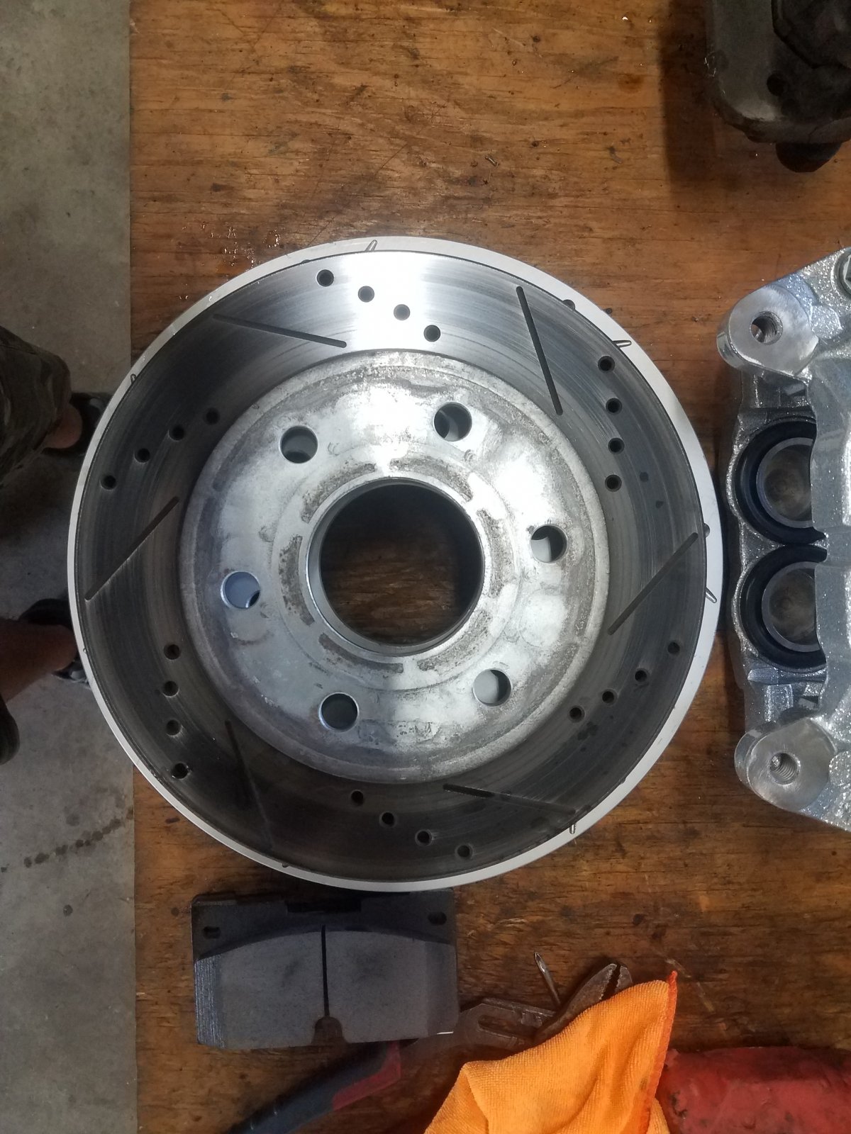

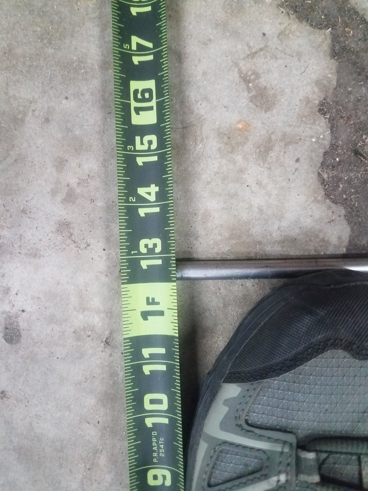

I didn't think so but I've never touched the brakes on this truck. Knowing Axekick was a member here and PT.net I wouldn't be surprised, looks like a powerstop kit for sure, and they have a ton of life left! Easily 20-40k left on the pads IMO.
I'll measure a rotor when I go back to the shop. If its 13" it should be the NNBS.
I’ll bet they are. Those calipers look correct.

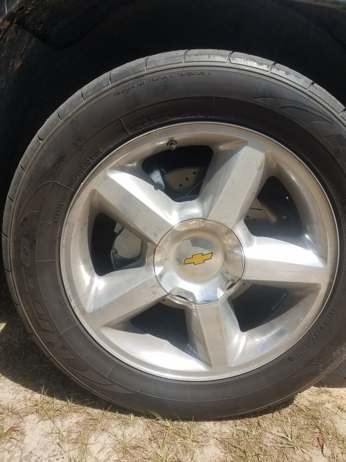

I agree, they looked super familiar to me plus the new ones dont look 1.5" bigger than the old ones
Hmm now im getting interested look's like 13 inch rotors let us know for sure.I like the macGyver testing real world. question could you acivate your abs mashing the brake pedal with the old brakes and the new brakes-i realize you have not bedded in the new ones but im interested.:popcorn: P.S i have those same rims on my tahoe do they fit without spacers.I assume you shaved them down i didnt read all this thread but will if they fit.

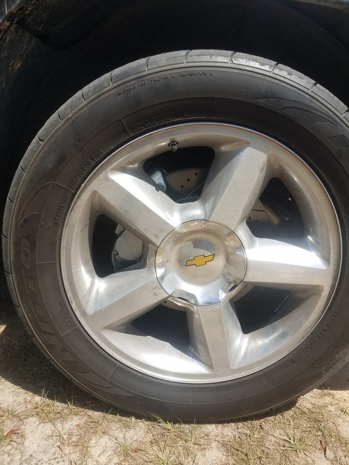

Got the new brakes installed today. Took a few miles to break in the AC Delco pads on the coated Duralast rotors. But once they set, they worked great. I did several mixed speed stops and threw in three or four panic stops to break the pads in and the feel got better and better.
Added the Stoptech braided lines, too. Much firmer pedal and everything feels sturdy and smooth so far.
I used regular flat washers to space the calipers evenly over the rotors. The washers didn't have the exact thickness I wanted to make it 100% even, but I will correct that asap. I'll let everyone know the size.
Overall, this was super simple for me on my 2010 Z71 and I highly recommend the upgrade. Just get the right parts, don't use anything beyond a single washer per bolt for spacing the calipers, and bleed the brakes very very thoroughly. I can't emphasize the last one enough.
All I did for this to work on my specific Tahoe was replace the calipers, pads, brake hoses, four washers total for the calipers, and I went with replica Trail Boss wheels. Research the factory offset of those wheels and spoke clearance to determine what wheels you can use, but I wouldn't get into the business of using wheel spacers. Pet peeve of mine and I think those things are dangerous, but thats just me. Buy the right wheels or don't do this uograde until you can afford to buy the right wheels. Anyhow, good luck and give a shot. It's worth it.
