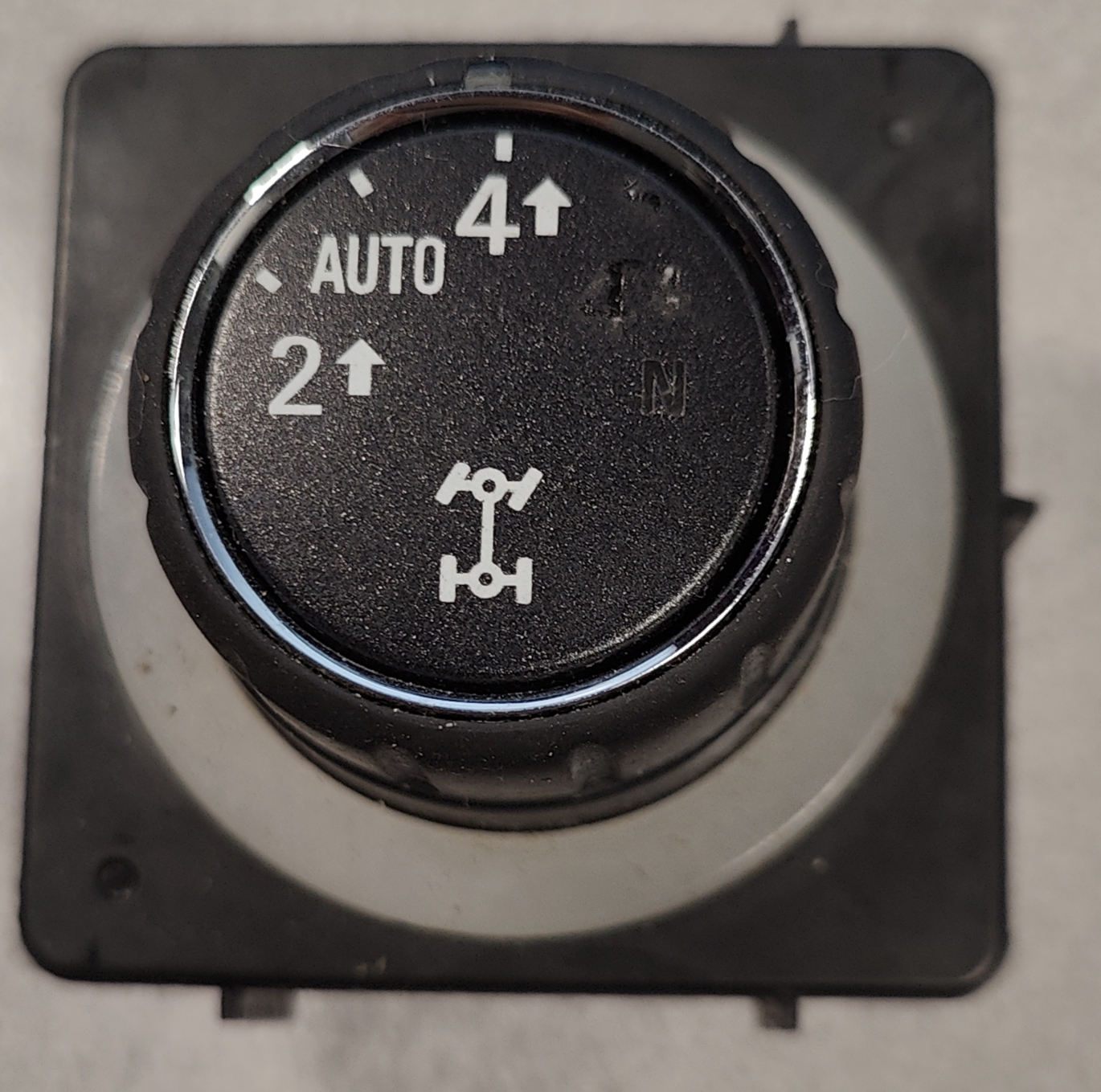

I opened up the original to see if I could see what they had done to lock out the 4-low position, but it wasn't immediately obvious and would require more disassembly.
This is how original switch looked.

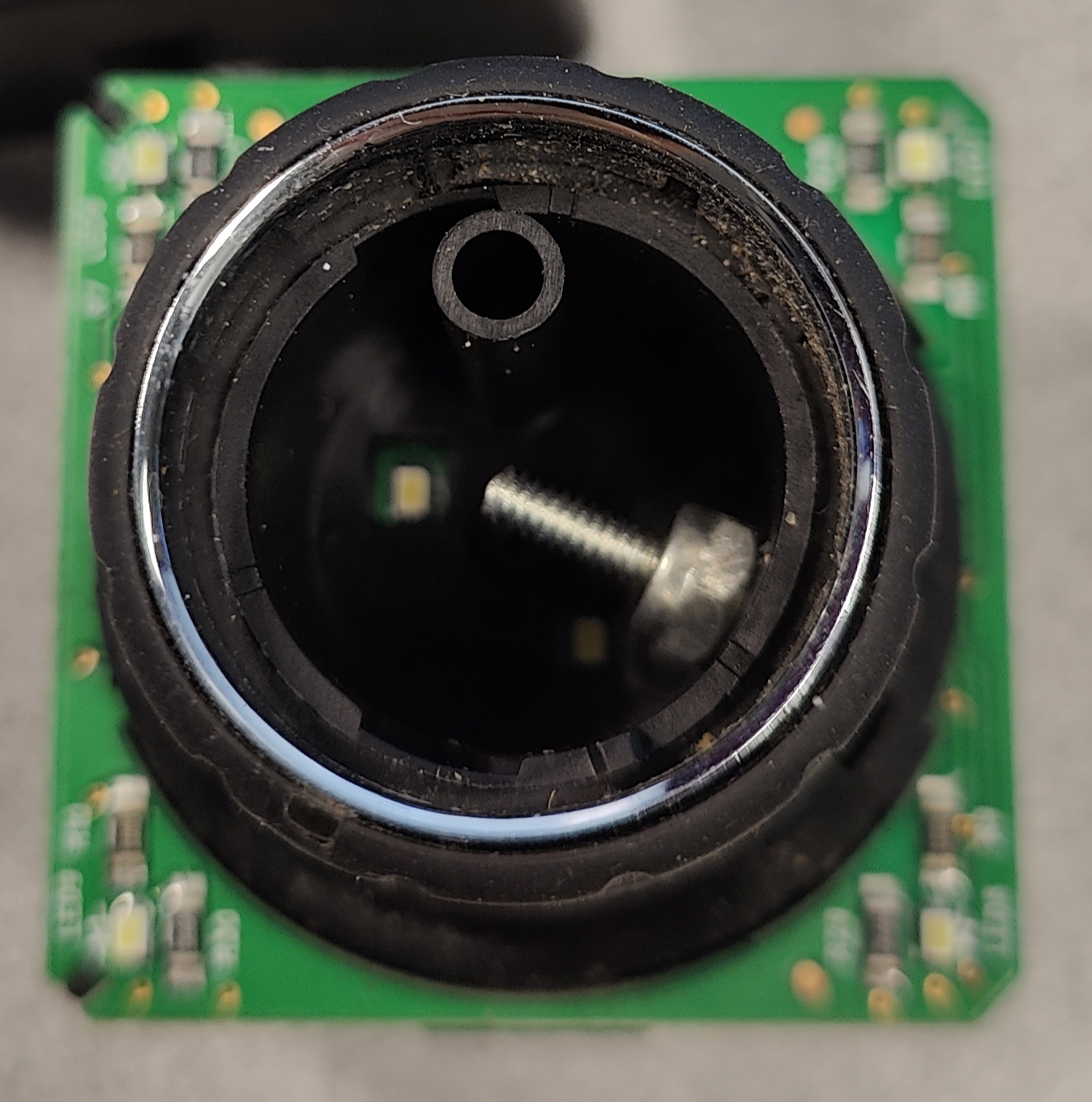

I took the old selector apart and saw how they locked out 4-low. There's an added screw head which forms a bump on the fixed shaft, and there's a piece of plastic glued on the inside of the rotating knob which forms a hard stop when it contacts the screw head. Once I removed the screw, all positions were available again. Btw, it's really easy to take apart and reassemble the selector.
