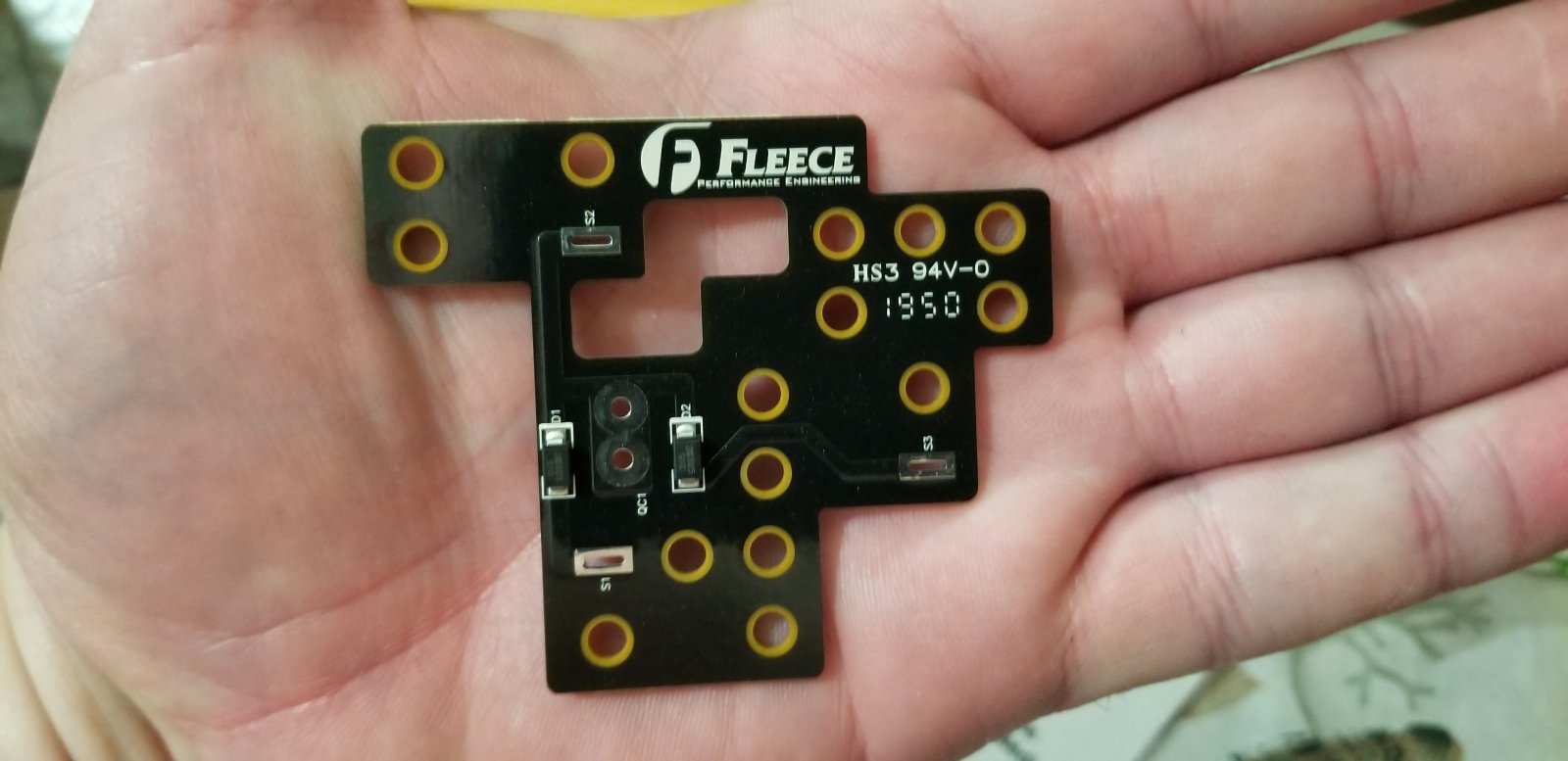

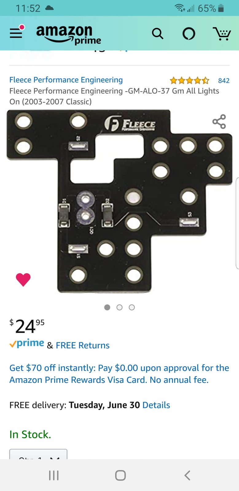

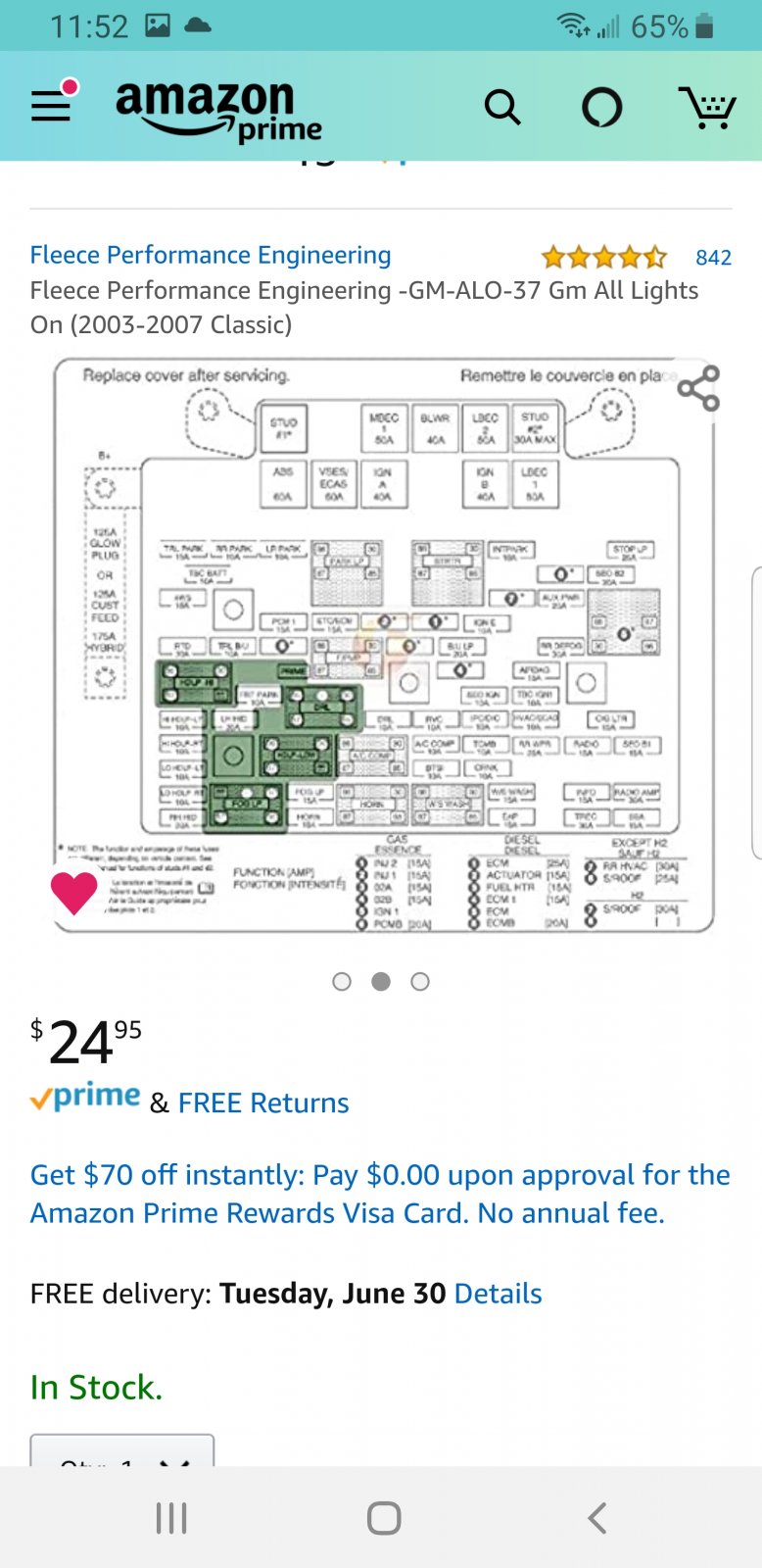

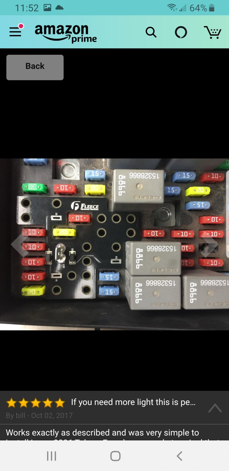

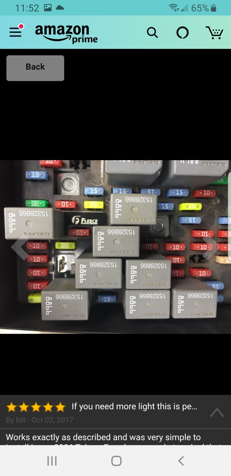

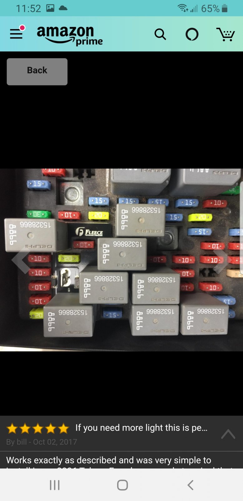

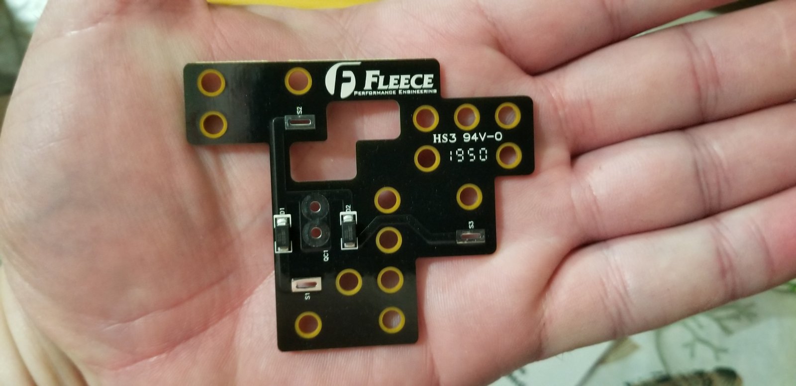

Dude I bought a board that u put in fuse box. It turns the hi an low an fogs on. No wiring. You take some relays out lay the board down an install relays. It has worked flawlessly for me I'll upload a link
