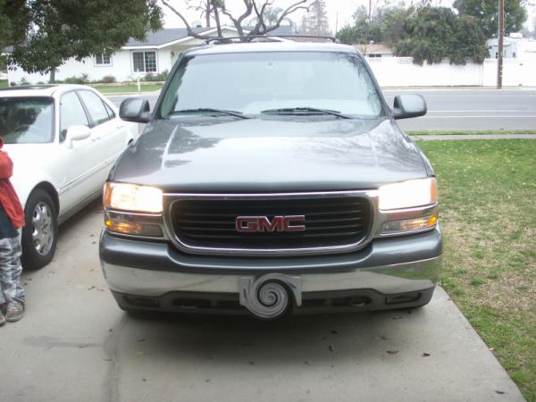

i grounded the yellow wire to the fender best and cheapest install i have done on this truck now just waiting for my hids to come in
92__silverado
Dec 19, 2009
175
Looks good I am waiting for my HID fogs to come in and then i am going to do the 6hi mod. I like as much light as possible. When you drive unlit country roads a lot I need to see what is on the side of the road ready to sprint in front of me. Damn deer.
