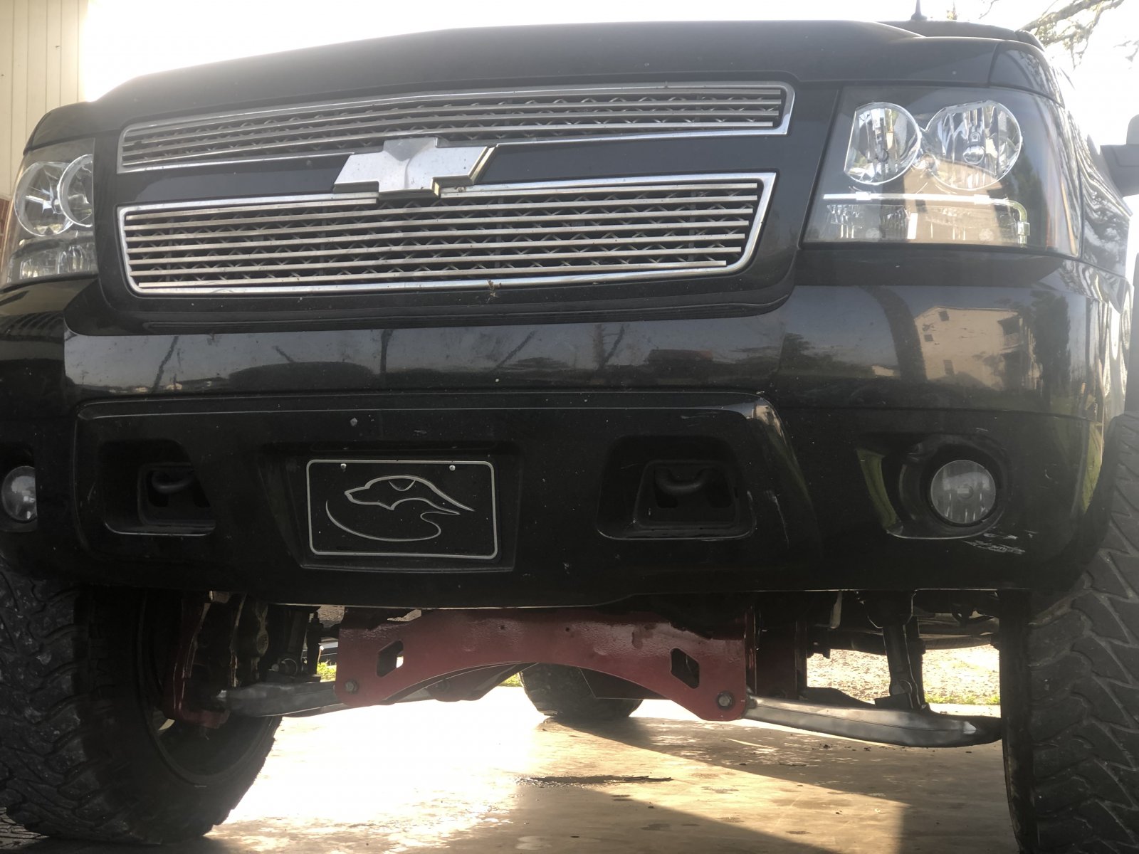

I have a 7.5” RC which should be the same as the 5” but stretched. My rear crossmember is cut but no plate welded I’ve never had any issues or complaints my buddy has the same setup with his 4” fabtech and his rear crossmember is cut but never had any issues. Front ends are pretty much the same as the Tahoe minus the lower control arms. Only downside to rough country is like my kit the lower control arm angles suck powder coat sucks if you don’t upgrade to coil overs you’ll have a ugly spacer on top your shocks rough ride etc I’ve replaced everything on my lift other then the crossmember drops which I’m about to do this week.

My angles came out perfect I finally installed the 6” fabtech I got from the 18 Silverado I also threw some icon coil overs off a at4 with some 2” spacers to match the lift height upper uniballs are perfect as well
