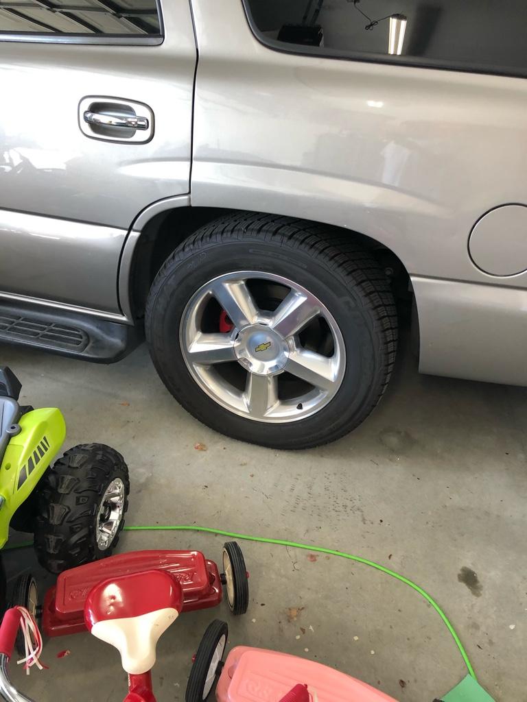

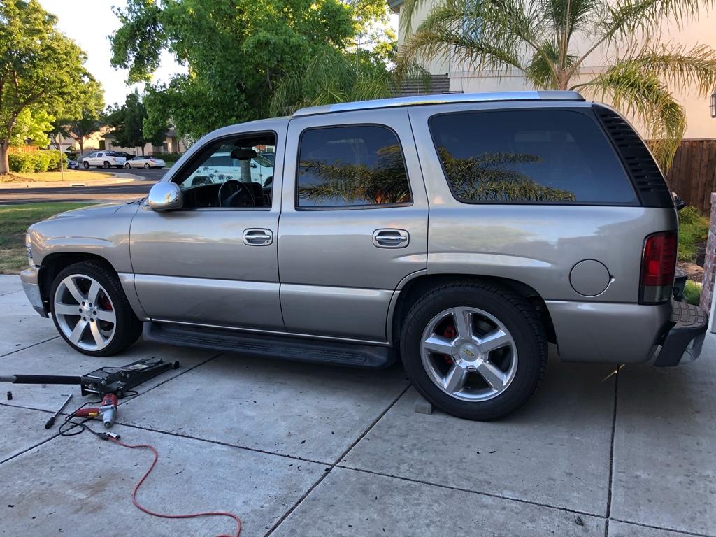

Just run the 285-45-22 tires. So many more tire brand options for that size vs all those oddball sizes named in the previous post.

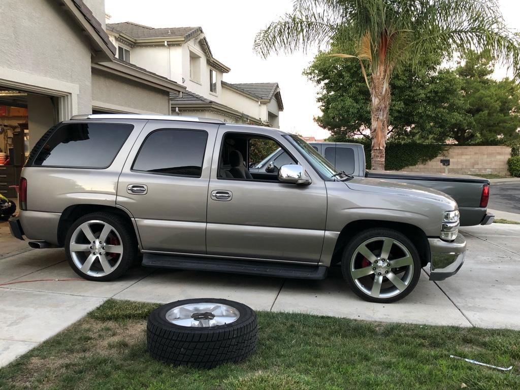

Here is NeverSatisfied Tahoe with a 285-45-22 and I think he was 4/6 drop. Message him about tire sizes. He's pretty smart on that stuff.

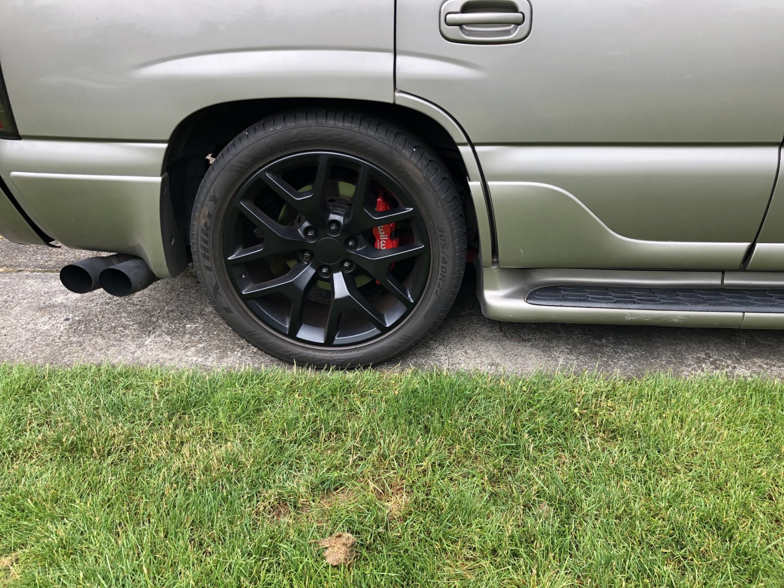

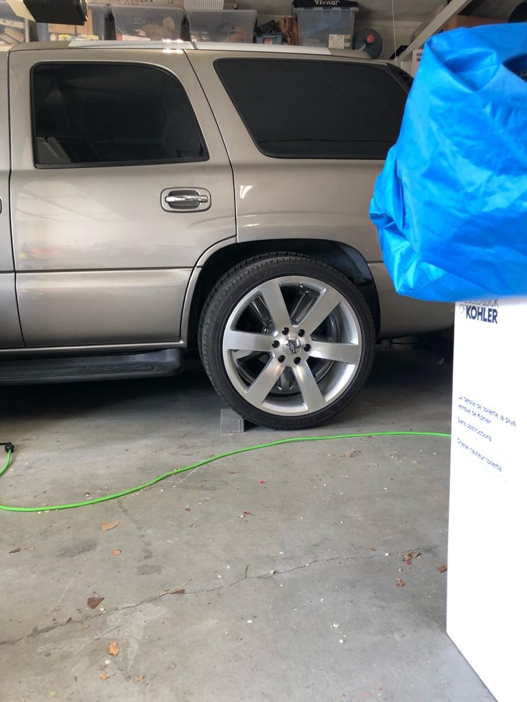

Dont know why anybody would say a 305/40/22 on a 22 x 9 wheel looks “bulgy” but here’s my ‘02 with them on 22x 9 reps +31mm offset with a 2/4 drop. I have run 26x 9’s with 305/30/26 tires with the same drop so you should be fine with either tire in question with your drop.
View attachment 249425 View attachment 249426
That’s not bad at all! My concern is yours are 22x9 with +31 but mine are 22x9 with +22.
You rub or close to rubbing??

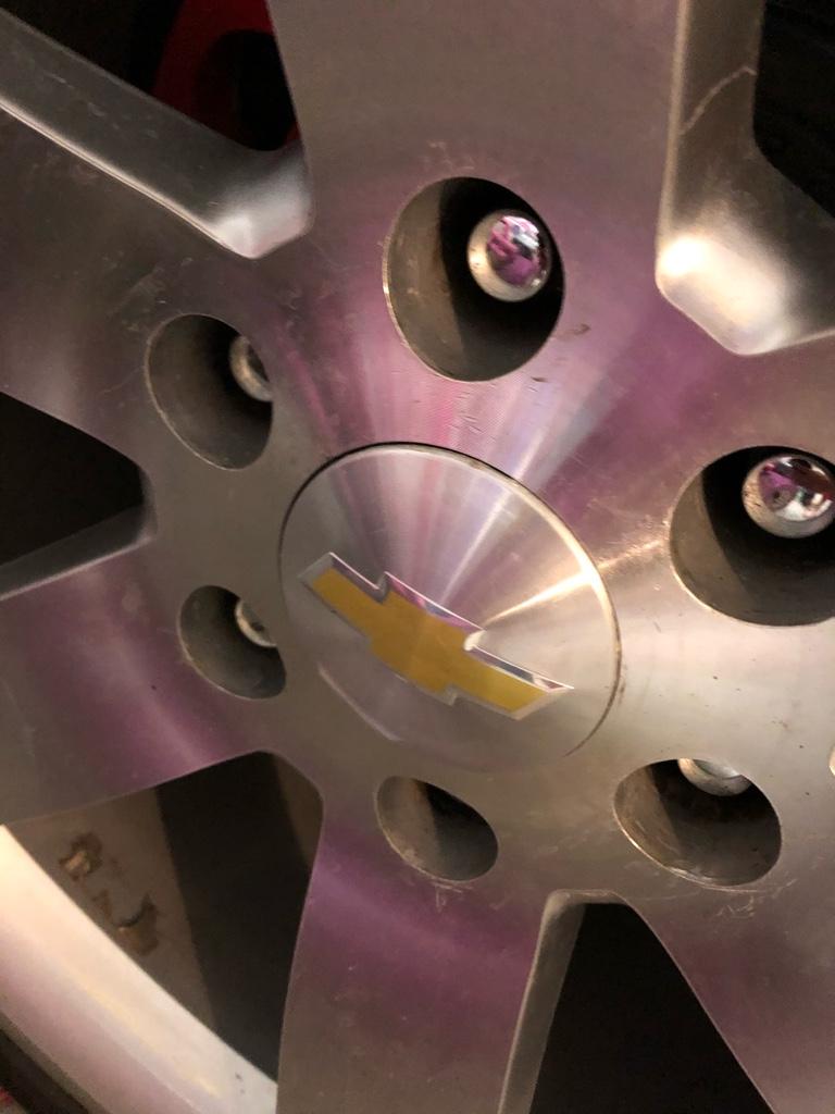

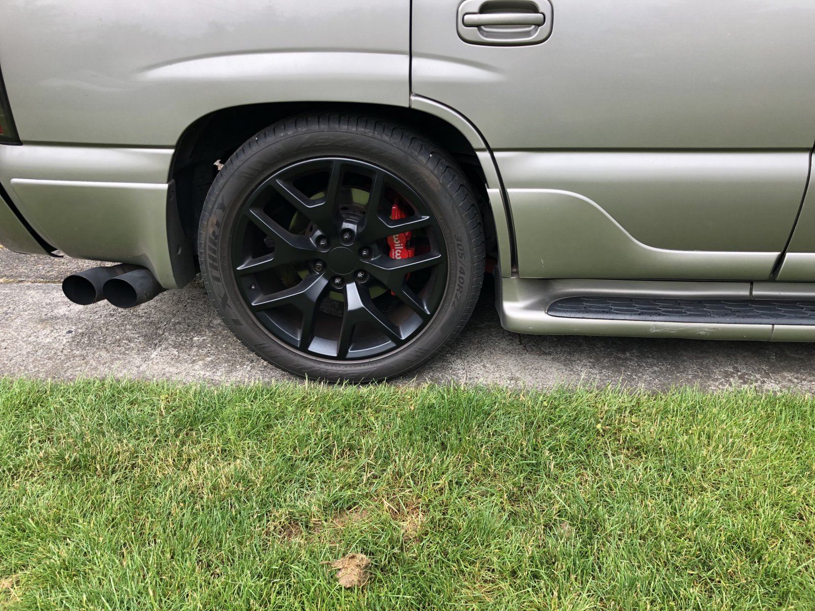

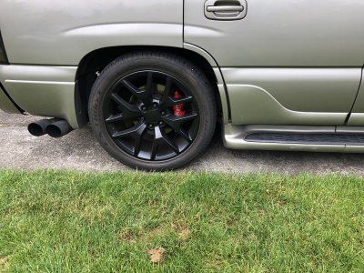

Factory oem Traverse I want to say
Where did you come up with knowing that they would work? Can you get a closer up pic of the center cap on the wheel. I really like that cause most people have to run those chrome center caps on a satin wheel.
Don’t mind the Philthy wheels lol
I’ll text my buddy to confirm what they are off but he figured it out. They look so much better than chrome, just took those off today .

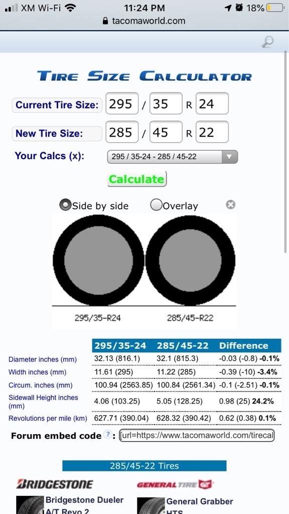

285/45 seems big but I guess if I can run a 295/35/24 I can run a 285/45/22
