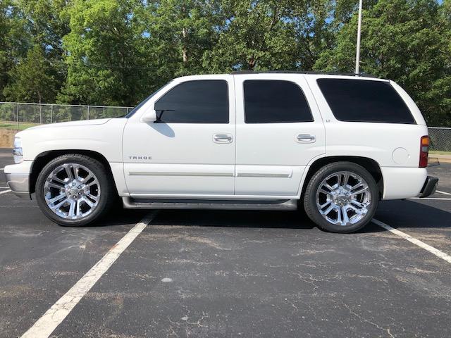

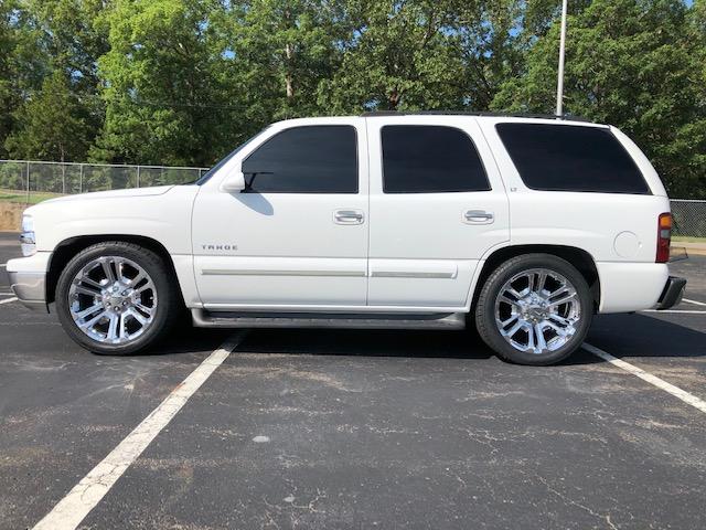

BADRIDES
Dec 18, 2015
1,825
1,278
285-45-22 with a 3/4 drop and no rubbing
