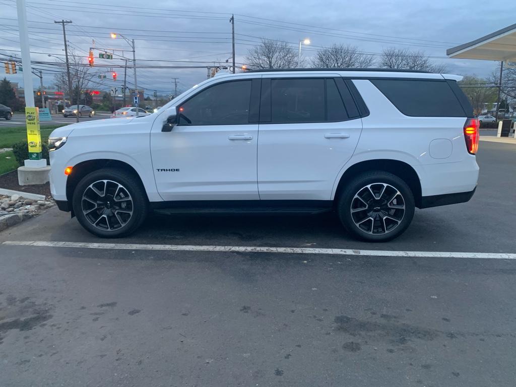

Hey guys,

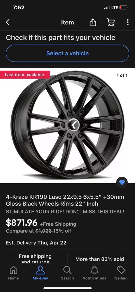

Just traded my 17 Silverado for a 2021 Tahoe RST. Love the truck but I’m not in love with the factory 22” half black half machined wheels. So I ordered a set of gloss black 22’s.
Kraze Lusso. 22x9.5 et 30.
My brother owns a shop and seems to think the stock 275/50/22 Bridgestones are a bit anemic looking for the truck, (my initial intention was to reuse the factory tires and tpms) however he’s suggesting that I go with a bigger tire something like a 285/45/22 in an AT or a 305/45 in an all season. However these trucks are so new that no one seems to know what does / doesn’t fit. I don’t want to level / lift anything and keep the ride quality. The restriction seems to be the upper ball joint / control arm which seems close to the inside of the tire on the front wheels.
Anyone here with real world experience who can help? Most of the online configuration things seem to stop at 2020. Thanks in advance!

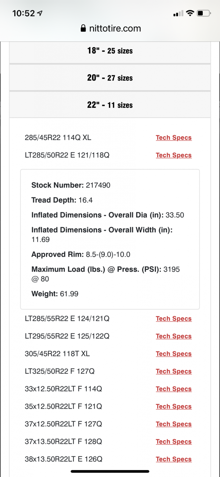

Nitto Ridge Grapplers in 285/50r22 are actually 33.5” diameter.

You mean tall. But yeah. Some tape measure math makes it seem like they are about the biggest thing you can get in there. Stock 275/50 is 33.1 tall and 10.8 wide. The 285/50 is 33.4 and 11.7 wide. Anything bigger is going to have rubbing issues at full lock and get real close to the upper ball joint. Granted as long as you clear the ball joint you are OK as that is a static point.
