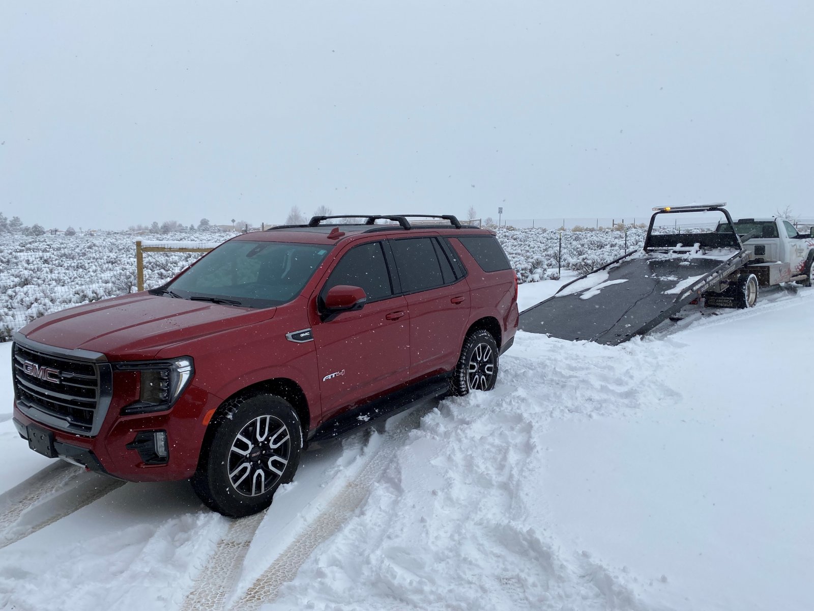

I'll have to check next time I'm at the dealership. Called GM Roadside assistance and they towed it to the Chevy dealer here in Taos. They originally wanted to tow it to a GMC dealer in Santa Fe because the Chevy shop wasn't pulling up on their end. After providing the address they were able to confirm they were certified. I'll check back when it I get a chance.
Is the motor code also on the door or does the dealer need to look it up?
