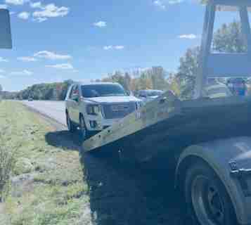

So 6.2L failed at 24926 Yukon Denali 2022,towed to dealership... Engine back ordered, finally came in and it was bad. I don't understand how GMC doesn't have a cut off on the engine issues.They are rolling the dice with our money. The 2nd engine started ran for `15 min and locked up with the marble sound. I was advised that it may have failed due to not pre lubing prior to starting. I was standing next to the vehicle when it froze up and it was the exact same noise that I heard when it originally left us stranded. Im still making car payments and insurance.I filed a claim with GMC customer support.We will surely take a big hit when we trade as car fax keeps track of all issues according to vin number.Last but not least they keep trying to make me accept one small car to another to use I ask for something comparable and they won't do it.
so 2nd engine arrived at dealer monday12/16/24. Hope they prelube this one.
Vehicle returned to me 12/20/24……..Merry Christmas
