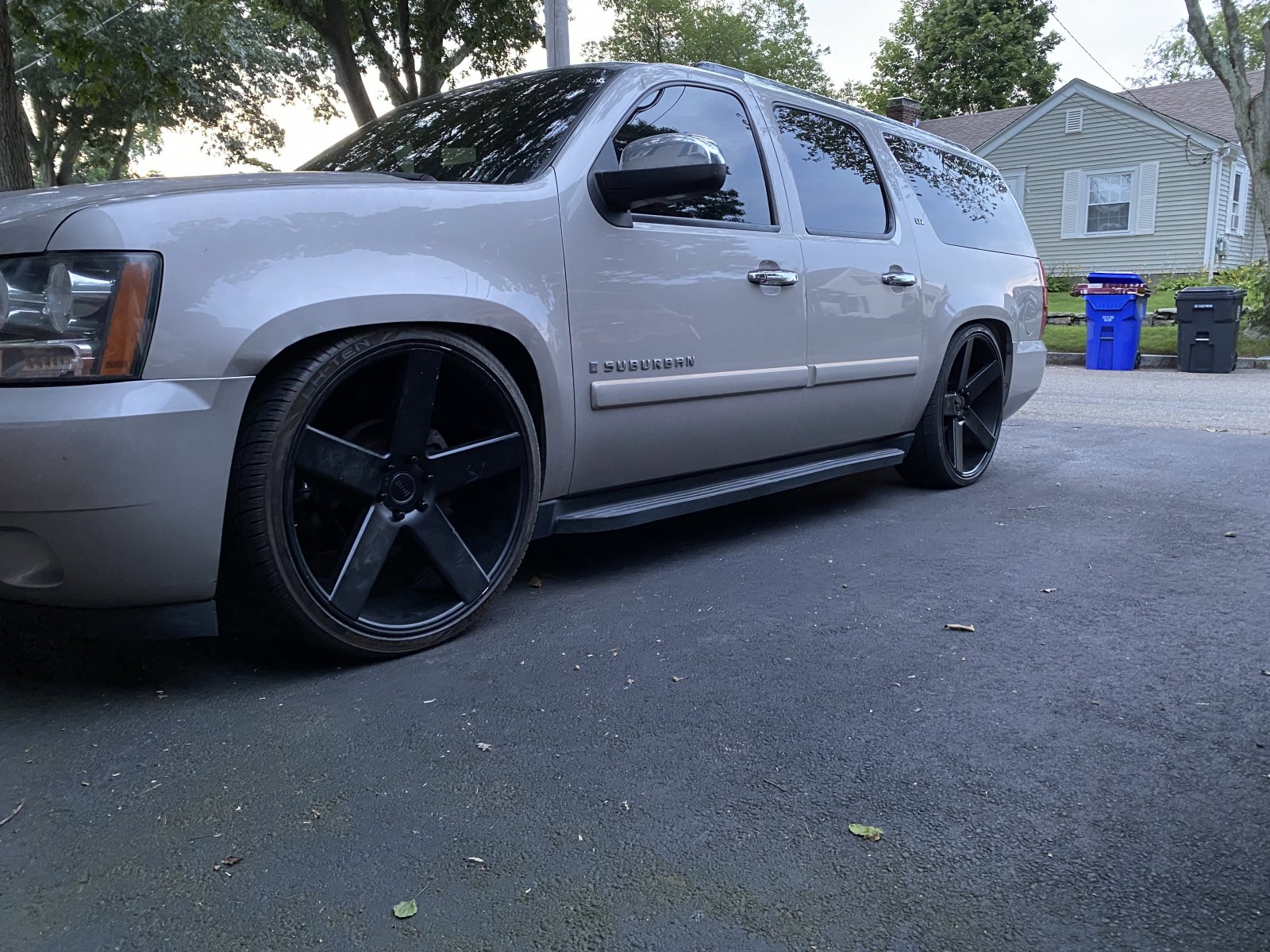

This is a 26x10 +31 with a 305/30/26

This is with a 295/30/26. Front fenders are pulled. Rears have the fender lip cut off. Not sure how much you’re lowered but this is pretty much the extreme as far as static with big wheels goes. Wheels hit the firewall pretty hard and made it a nightmare to make even somewhat tight turns

This is a x10 13mm offset with a 275/25/28 just for reference. The fronts would stick out way past the stock fender
