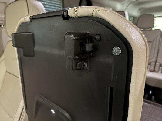

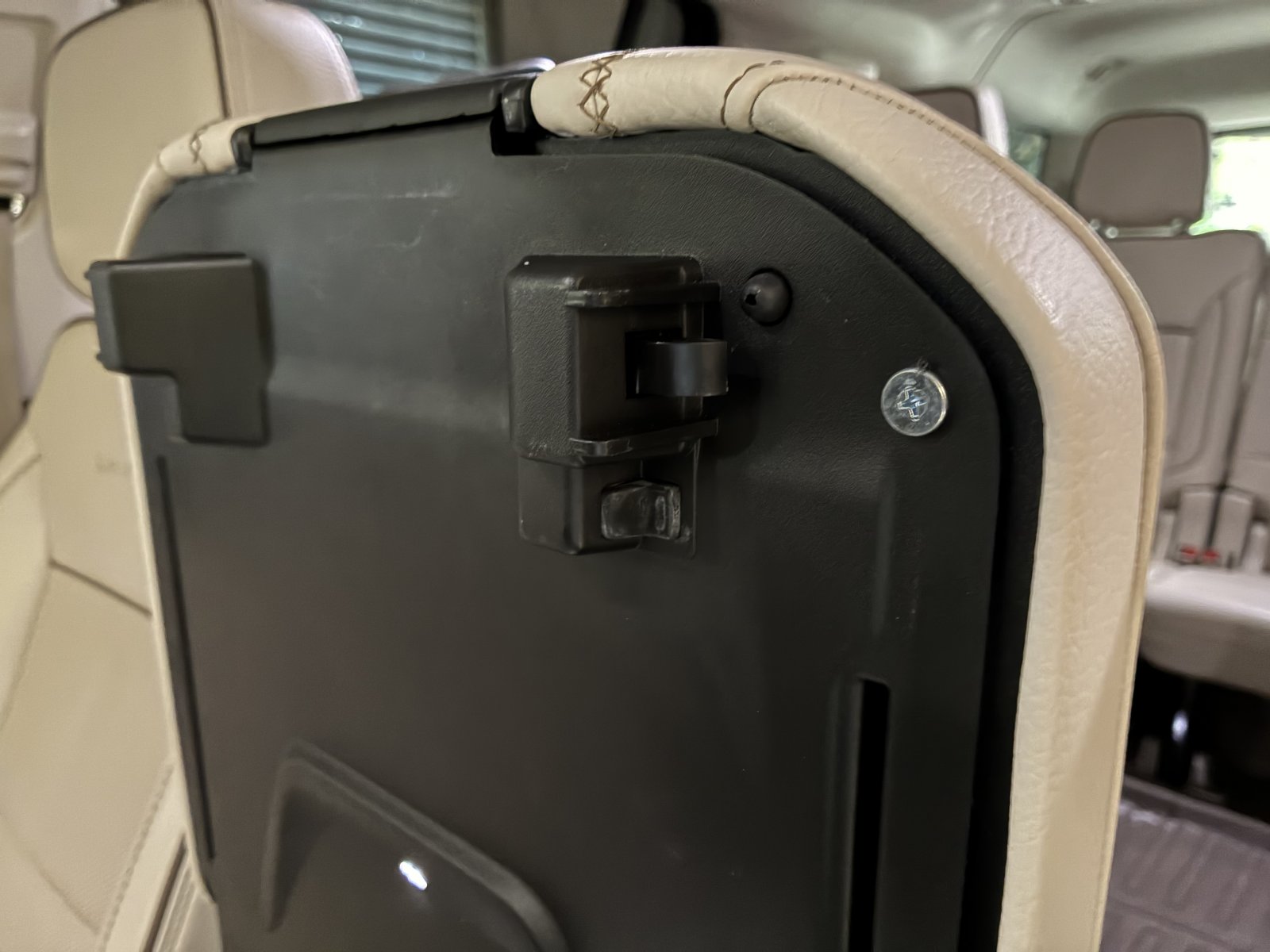

Update: Temp fix……self tapping screw.

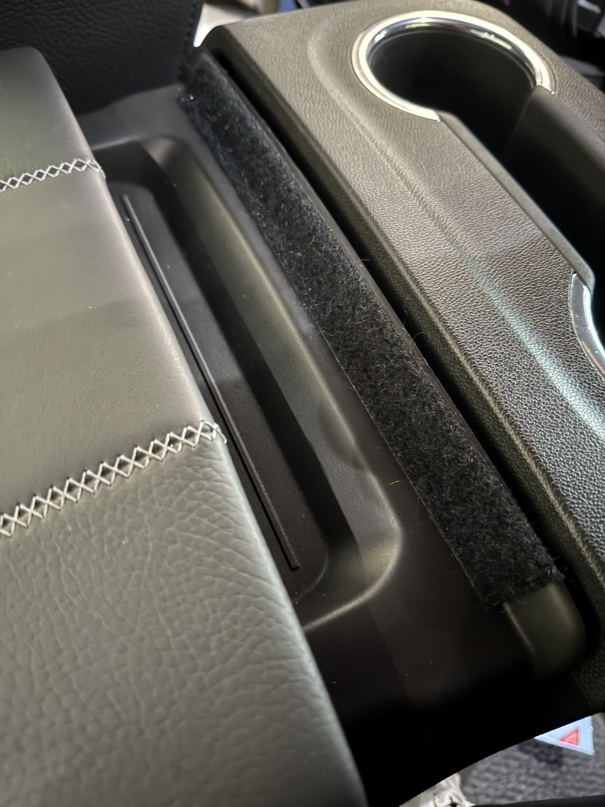

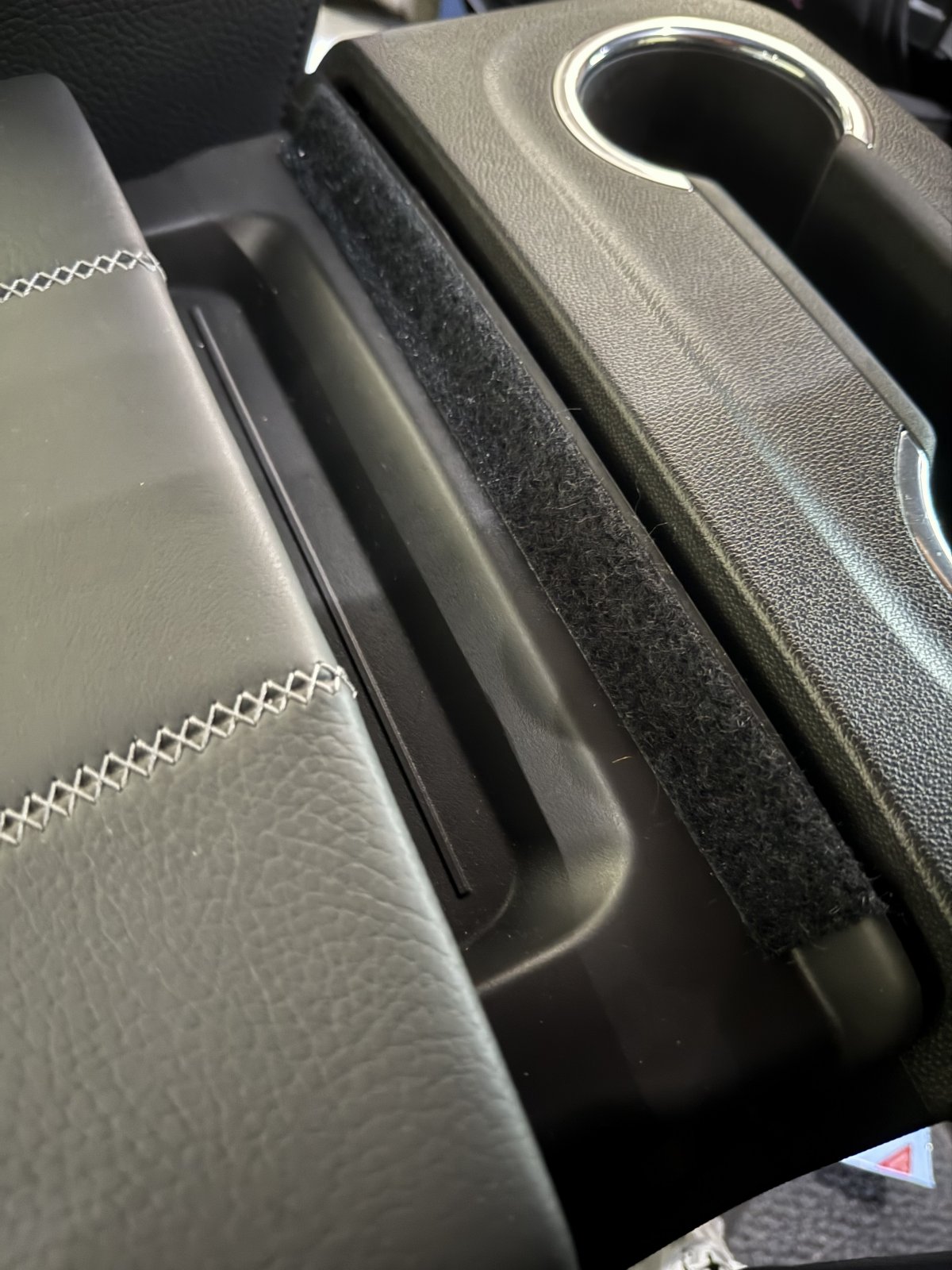

I used outdoor industrial strength Velcro (to endure temp swings inside the vehicle) as a temporary fix until the part is available from GMC for a warranty repair. It worked great! And it peels right off without damaging your interior. I put a strip on the back edge of the frame of center console and the other strip under the sliding portion of the armrest. Once the Velcro is installed, Slide the armrest back firmly and the Velcro will adhere. Boom fixed
Good fix….I like it!
