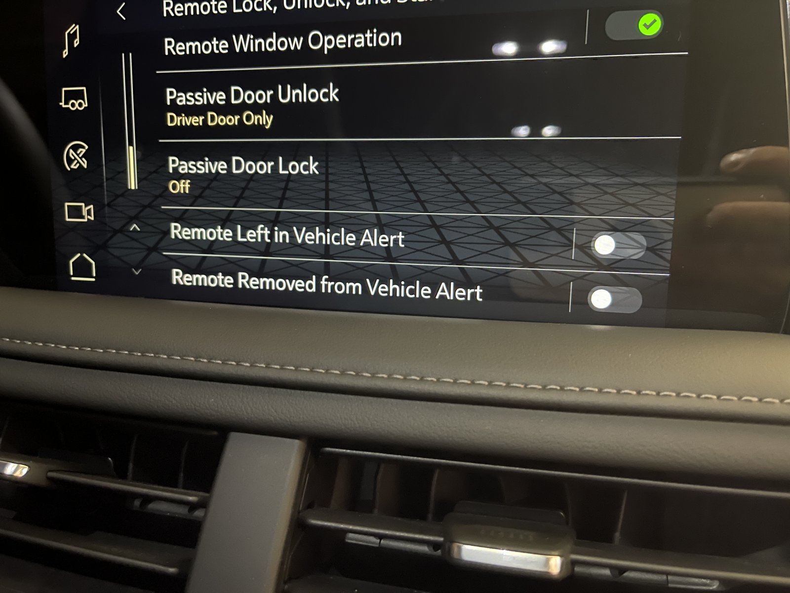

No programmer for the end user, unfortunately.
As for the horn chirp when a key is left in the vehicle that is easy to turn off in the settings menu. Just go to Settings - Vehicle - Remote Lock, Unlock and Start - at the very bottom of that menu you turn off the alert.
As far as the sport mode goes, you might check with https://www.autostopeliminator.com/
They make a harness that plugs into the switch pack that has the auto start stop button and it will save the setting of having it off and send that setting to the BCM every time you start the rig. Seems like they could apply the same strategy to the drive mode switch.
